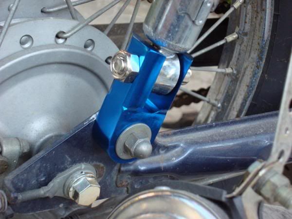

Vincent wrote:
You need a pair of these:-
OK, I'll bite - what do they do?

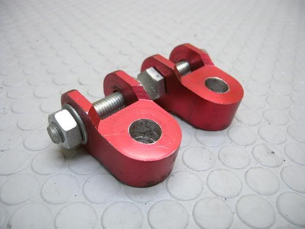

Vincent wrote:
Here you go:-
https://i77.photobucket.com/albums/j71/Drewskovitch/600x450-2010031000001-11.jpg
I've seen them for sale for bikes up to 400cc - Superfours, 400 bandits etc.
Good idea but not sure I could get away with that on my bike. May ruin the look.
I'm going to leave them and get some proper height ones then.
Just thought there maybe an advantage in it. To be fair they're only an inch smaller but anyway.
