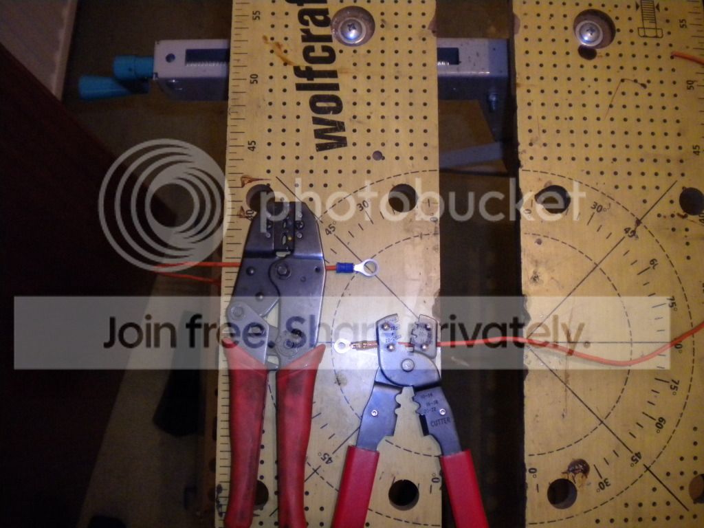

A terminal of each type was applied to the end of each piece of wire using the appropriate crimping tool.

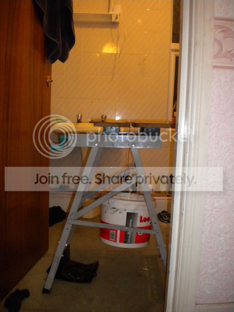

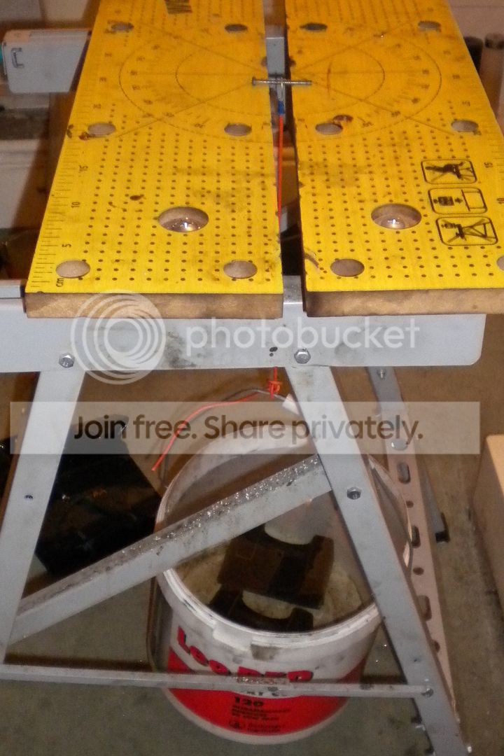

The bucket was tied to the other end of the piece of wire and suspended from the workbench using the bolt through the ring terminal so the bucket was hanging freely on the end of the terminal.
https://i48.photobucket.com/albums/f216/stinkwheel/dscn1017.jpg

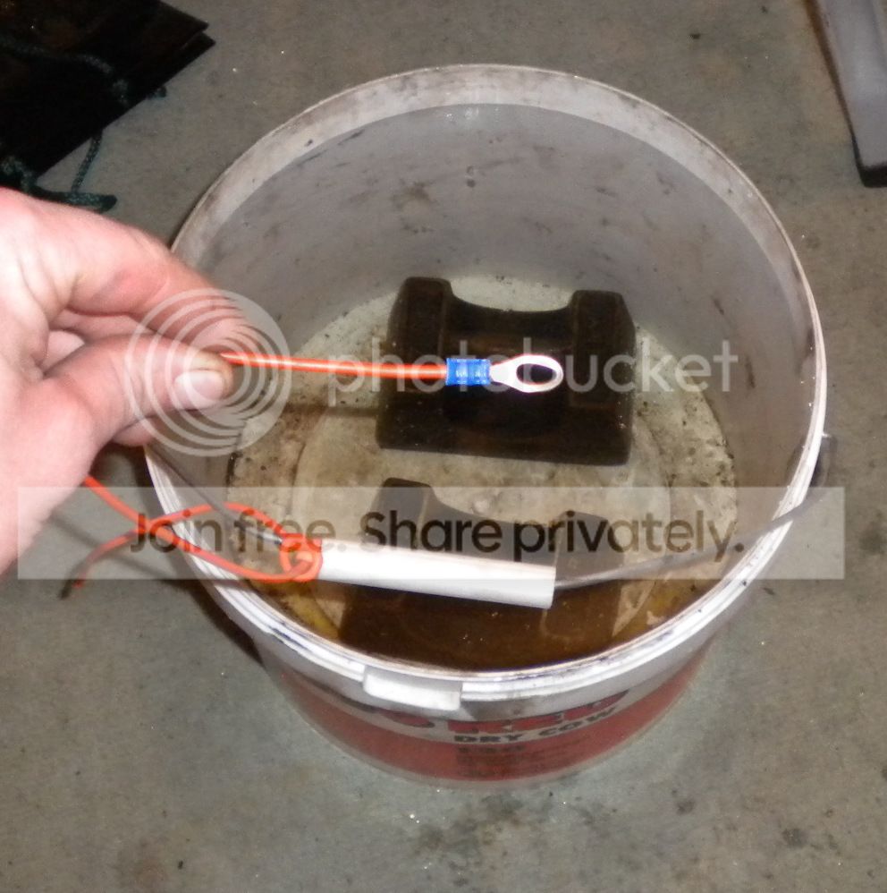

The two 7lb (3.18kg) weights were placed in the bucket. Water was added in 0.5 litre (0.5kg) aliquots until the terminal parted company.
Results
The non-insulated terminal parted company with the wire after adding 3l of water, making a total mass of 9.36kg. A braking force of between 88.6 and 93.6 Netwons.
The pre-insulated terminal took 10l of water, at which point the bucket was full. Experiencing a load of 16.36kg (163.6Newtons). The absence of a bigger bucket prevented continuation of the experiment.
https://i48.photobucket.com/albums/f216/stinkwheel/dscn1018.jpg
The ring terminal showed significant deformation at this load.
https://i48.photobucket.com/albums/f216/stinkwheel/dscn1019.jpg
Conclusion
Properly applied pre-insulated terminals are strong as fuck. Even cheap ones.
