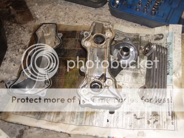

Possible that the leak is coming from where the oil cooler joins the front of the engine. Possibly just a case of replacing the o-rings. The oil runs through a mini rad inside a water jacket just before (or after, can’t remember) it passes through the oil filter.
This is the cooler removed from my CBR600F:

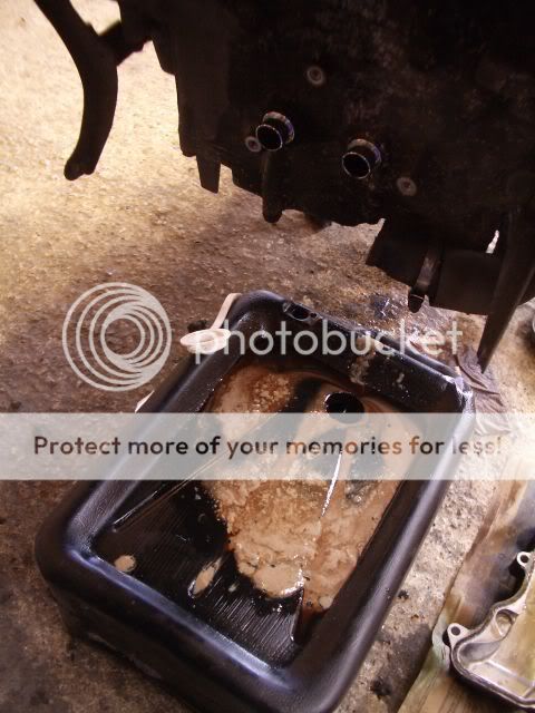

And here you can see the dowels where it mounts on the engine.
https://i221.photobucket.com/albums/dd227/serendipity_uk/CBR600FR/IMGP4118a.jpg
