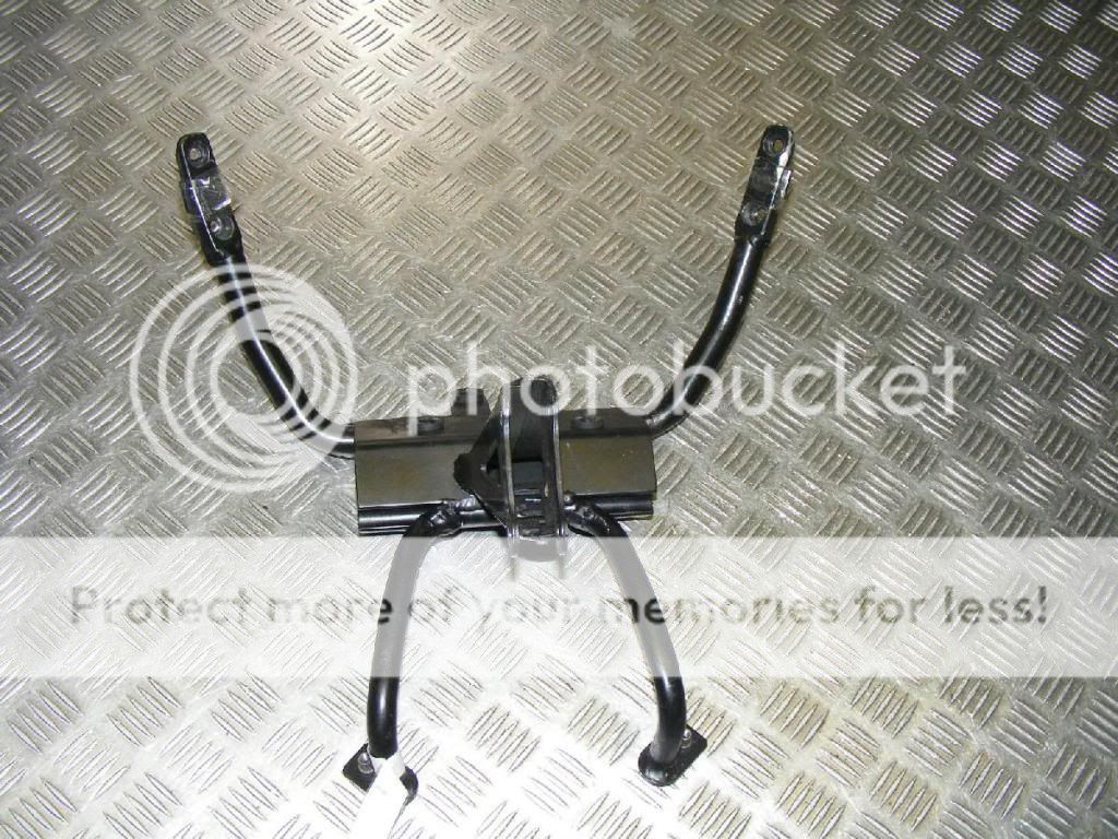

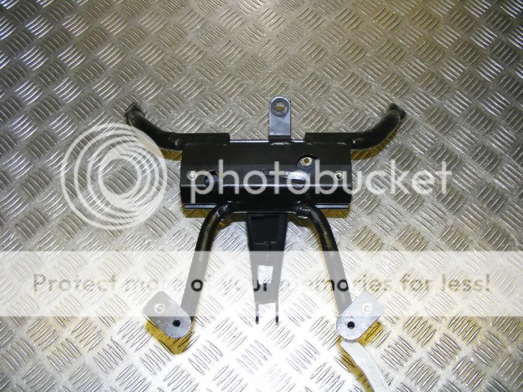

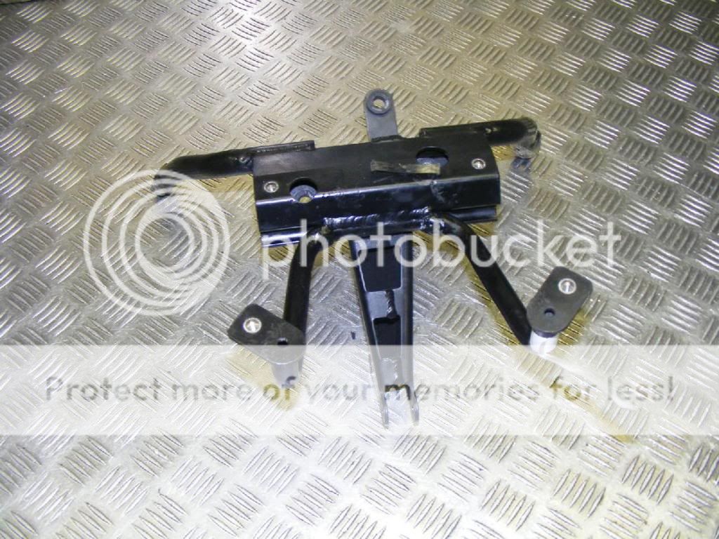

Here's some pics of the bracket.
https://i624.photobucket.com/albums/tt325/duncdmc/Item14428-1.jpg?t=1301527173
https://i624.photobucket.com/albums/tt325/duncdmc/Item14428-3.jpg?t=1301527168
https://i624.photobucket.com/albums/tt325/duncdmc/Item14428-2.jpg?t=1301527170
The mirror stalks i can hacksaw off and file down/cover...
but the headlight mounts are a wierd position.
I'm sure i could cut them down and drill through for a side-mounted headlight...
Dunc
Shaft
Joined: 27 Dec 2010
PostPosted: 00:25 - 31 Mar 2011    Post subject: Reply with quote
No chance you could just chop off everything, leaving the clock mount, then use old skool fork mounts for the headlight?

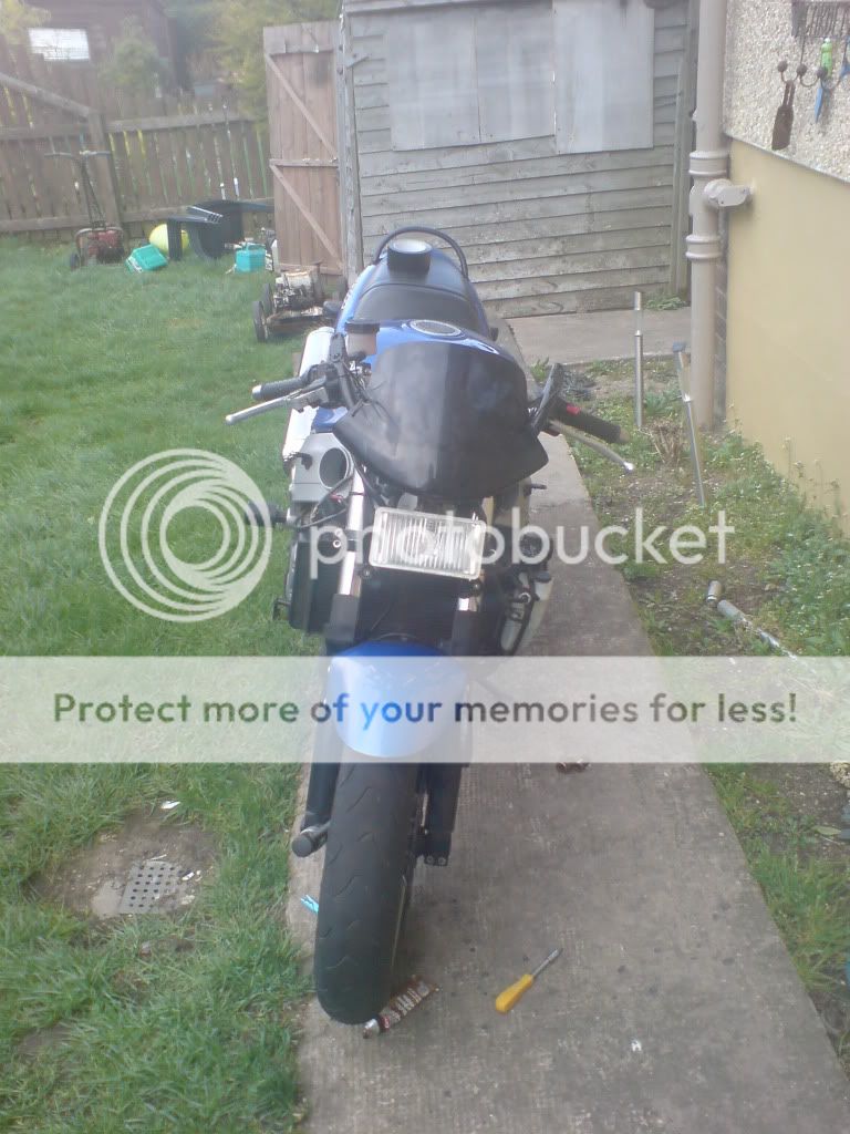

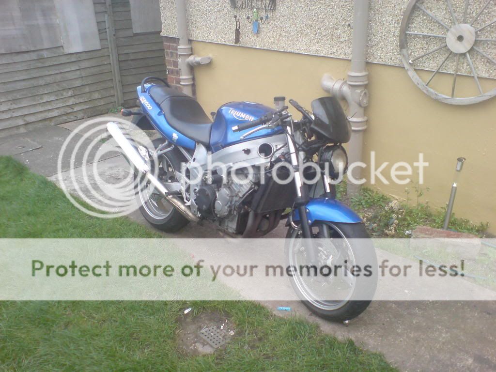

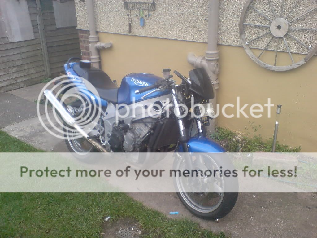

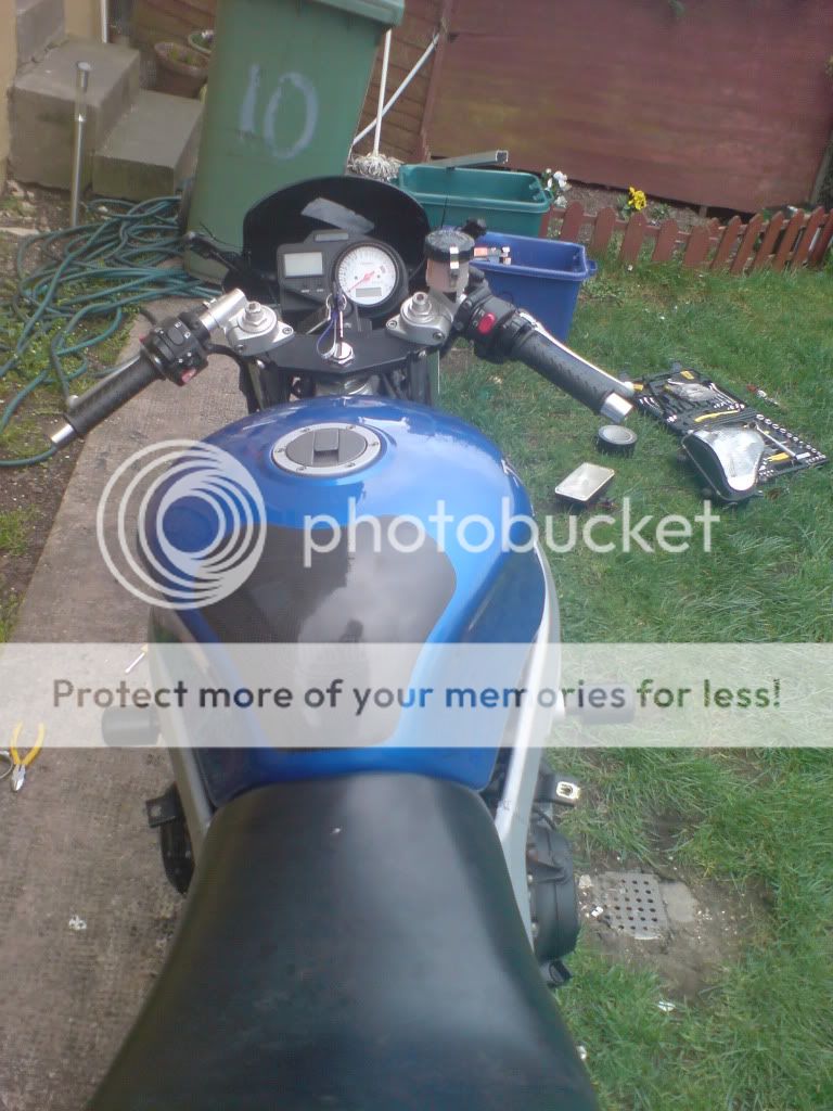

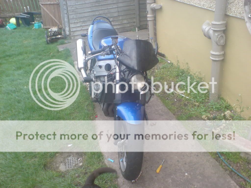

RIGHT.
So do i go for the square headlight:
https://i624.photobucket.com/albums/tt325/duncdmc/DSC00016-2.jpg?t=1301673787
https://i624.photobucket.com/albums/tt325/duncdmc/DSC00017-2.jpg?t=1301673849
Or do i go for the round headlight:
https://i624.photobucket.com/albums/tt325/duncdmc/DSC00018-1.jpg?t=1301673788
https://i624.photobucket.com/albums/tt325/duncdmc/DSC00019-1.jpg?t=1301673848
Obligatory POV shot
https://i624.photobucket.com/albums/tt325/duncdmc/DSC00020-1.jpg?t=1301673994
Dunc
PostPosted: 17:23 - 01 Apr 2011    Post subject: Reply with quote
Can you get a bigger round headlight? That would look good. Something from a bandit or Hornet.
Right
Consider buying Speed Four the Air intake scoops too, they will make it look much better.
The Speed four relocates the coolant bottle behind the RHS rear panel. If you had a S4 coolant bottle you could to the same.
If you want a loud can, the follow fit as long as they are 3 bolt.
ZX6R Circa 1998-2000
ZX4/7/9R Pre 2000
Bandit 1200 pre 2001
RF900
RF600?
Speed Four
