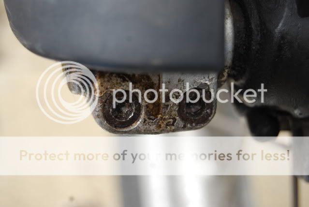

G have a look at this... this is the pigging problem...
https://i174.photobucket.com/albums/w81/phonesurgeon/Nikon%20D40X/DSC_3081.jpg
Tried heat... wd40... doing it up slightly... hammer... tapped it gently... tap it vigourosly... nothing.

I suspect the problem there is not the threads, but the caps binding in the corroded alloy. I suggest trying freeze and release on it.

I'd ideally try some heat with some freeze and release.

I would still weld an old allen key with that.
don't use caustic soda, it will eat the alloy. But as others have said, try freeze ad release spray, and loads of wd-40 or plus gas etc.
I think the only way on that is to weld and undo........its looks like its laughing at you.

Failing everything. I once had a similar arrangement and landed up hacksawing them in half through the split in the bottom of the fork leg. I then levered the bits with the head in out by hammering an old screwdriver in the gap I just sawed then used the hole they left as a drill guide.
As it happens, after only a few turns of the drill, it grabbed the stubs and screwed them all the way out through the other side.
I preferr the idea of welding an allen key to them though.
Clear case for using an air impact wrench in the first place as soon as you/they realised they weren't going to move.
