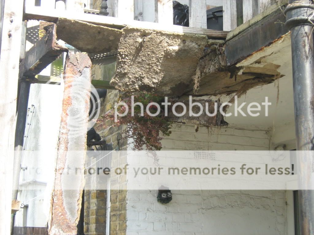

Well not so random as we had a slight Idea it might happen.
Not even ten minutes before the collapse I was underneath it all sweeping up.
https://i1224.photobucket.com/albums/ee372/theguvnor1/IMG_0850.jpg
This is where I was standing just before.
https://i1224.photobucket.com/albums/ee372/theguvnor1/IMG_0849.jpg
The view from indoors.
https://i1224.photobucket.com/albums/ee372/theguvnor1/IMG_0842.jpg
https://i1224.photobucket.com/albums/ee372/theguvnor1/IMG_0841.jpg

Looks about a meter square by 150mm thick - about 350 kilos.

Having seen a few collapses (and been a party to many deliberate ones) - I would be gone from there. Un-intended movement that you can feel is not to be taken lightly.
EDIT:
See in this pic:
The black line in the underside of the balcony looks like a filler joist - a narrow steel joist that WAS supported by that large rotten steel channel/angle which is hanging down. The joists are laid out then concrete fill (with no reinforcing) is set between them. Now that the support is gone the only thing holding that section of balcony it the fact that the concrete is keyed inside that joist. A few good jumps on the balcony will have the lot down IMO.

Are you renting there? THat building should NOT be occupied TBH.

Yeah renting, its all outside, the stairwells have signs on saying don't use but yeah its pretty bad.
I have no idea who decides that sort of thing, someone was meant to be coming from the council yesterday I think but I never saw anyone. The flat owners are all dealing with it. But one of them is an agent who own it themselves so its all foot dragging I think.
