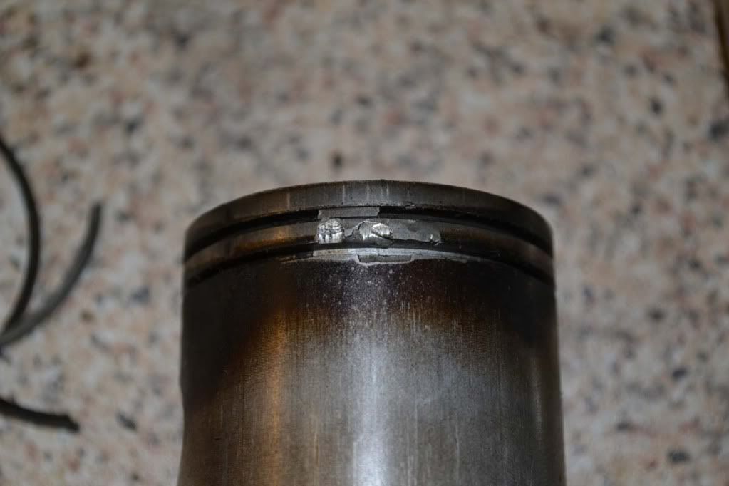

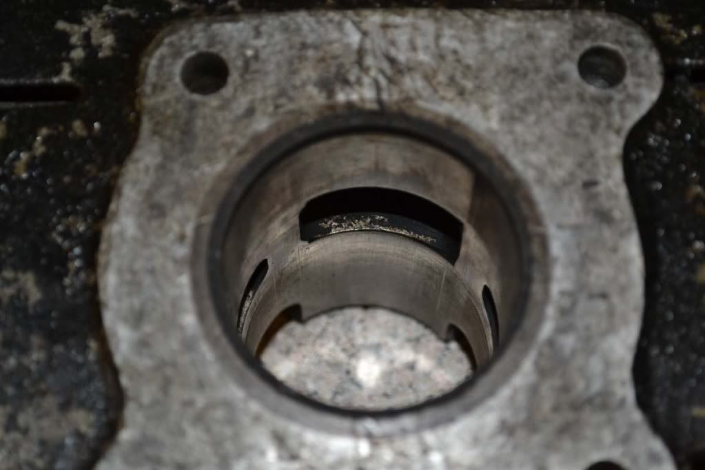

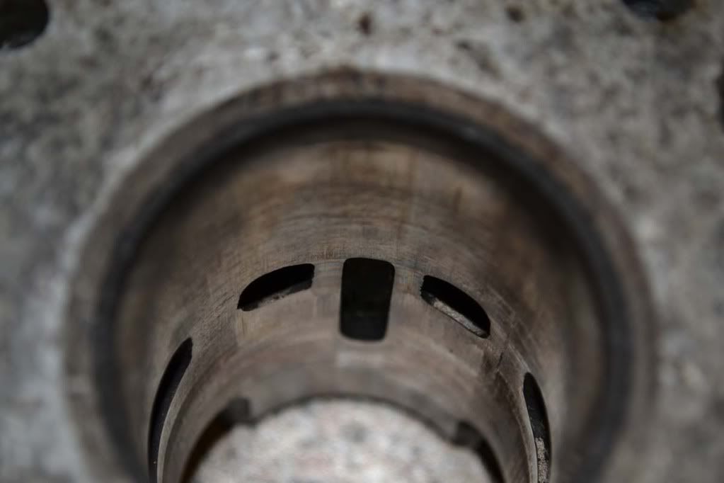

Well after taking the exhaust off to check for a blockage there was a "clink, clink" inside the exhaust..... not good
Turns out there was bits of piston ring in there.
Me and my dad took the engine out today, whipped off the head and checked out the barrel state and what state the piston was in.
The barrel -
https://i49.photobucket.com/albums/f292/d0xicle/Gp100%20engine%20overhaul/barreltwo1.jpg
https://i49.photobucket.com/albums/f292/d0xicle/Gp100%20engine%20overhaul/barrelone1.jpg
The piston -
https://i49.photobucket.com/albums/f292/d0xicle/Gp100%20engine%20overhaul/pistonside1.jpg
https://i49.photobucket.com/albums/f292/d0xicle/Gp100%20engine%20overhaul/pistontop1.jpg
It looks like the explosion took some of the piston out.
Will this require a rebore and an oversize piston? I can't really see any scoring, but if the barrel gets polished will this require an oversized piston anyway?
I can get some more pics if needed.

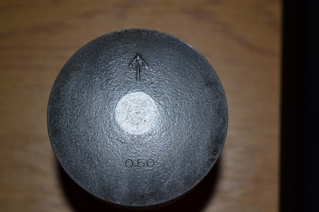

After I cleaned off the piston I noticed that it had "0.50" on it. Does this mean that the barrel has already had a rebore? Does this also mean that I have to get an identical piston?
https://i49.photobucket.com/albums/f292/d0xicle/Gp100%20engine%20overhaul/oversizepiston.jpg
As there is no scoring that I can see, would I be safe just dropping in the same size of piston with suitable rings?

Yep, that's .50mm oversize. Think you can get at least 1mm oversize for the GP100, maybe even 2mm. So you should be able to have another rebore on that barrel. You might get away with just a new .50 piston...but I doubt it. Probably do the same again.
GP motors tend to be pretty fragile. It'll be the main bearings next, trust me Laughing
cb1rocket
Joined: 30 Jan 2010
PostPosted: 20:52 - 19 Jun 2011    Post subject: Reply with quote
yes its been rebored before, which is a 1st stage rebore ie its only been rebored once before. There does appear to be some light scoring to the barrell but you could get away with using the same piston size and new rings. It doesn't look as bad as when my gp100 decided to shatter itself to pieces.
I would go for a new rebore and new next size up piston rather than waste time trying to make use of just a new piston and rings. Your know its been done properly rather than trying to bodge it, and your also know it will last another 15 - 20k miles then.
Check there is no debris in the crank case and give it a thorough wash out with petrol/parafin mix or a hose pipe with water and then rinse and fill with oil and drain several times. Repeat if necessary.
Also check the big end bearings are good that there is no vertical movement. Side to side movement is ok but no vertical.

Everything then started heading south. The bike stopped, I tried to start it again and it kicked back with quite a bit of force. After careful inspection it seemed that I forgot to tighten the flywheel up and the bike had sheared the bloody woodruff key!
Now-
Are woodruff keys fairly generic items?
I have scoured teh internet without any sign of one for this bike, but they seem to pop up all over the internet, without any specific reference to any car or bike.
Luckily everything else is tickety-boo.
- I can select 1st and 2nd gears as normal, and then return to neutral
- No backfiring
- No oil leaks
