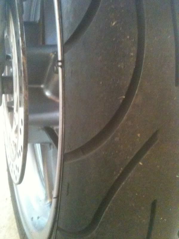

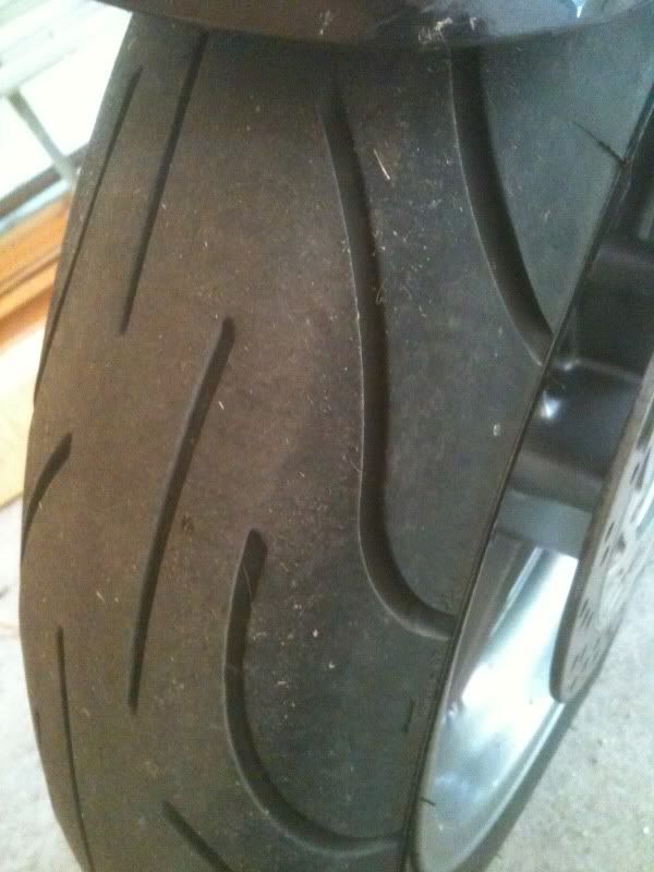

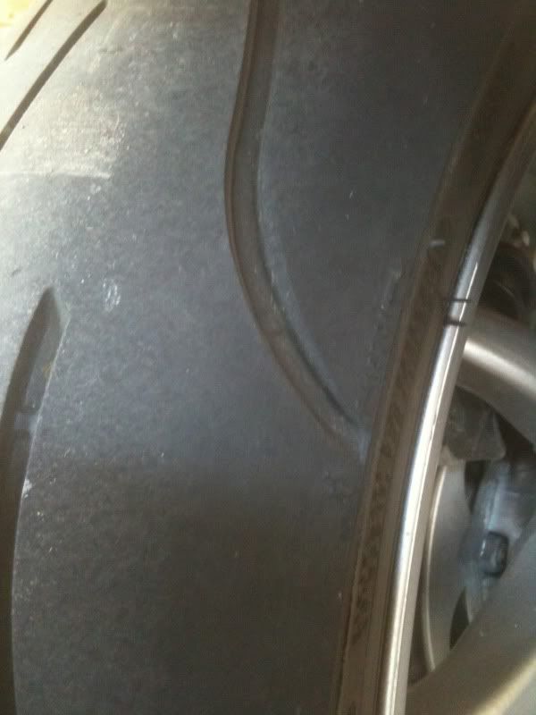

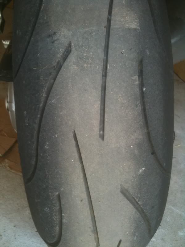

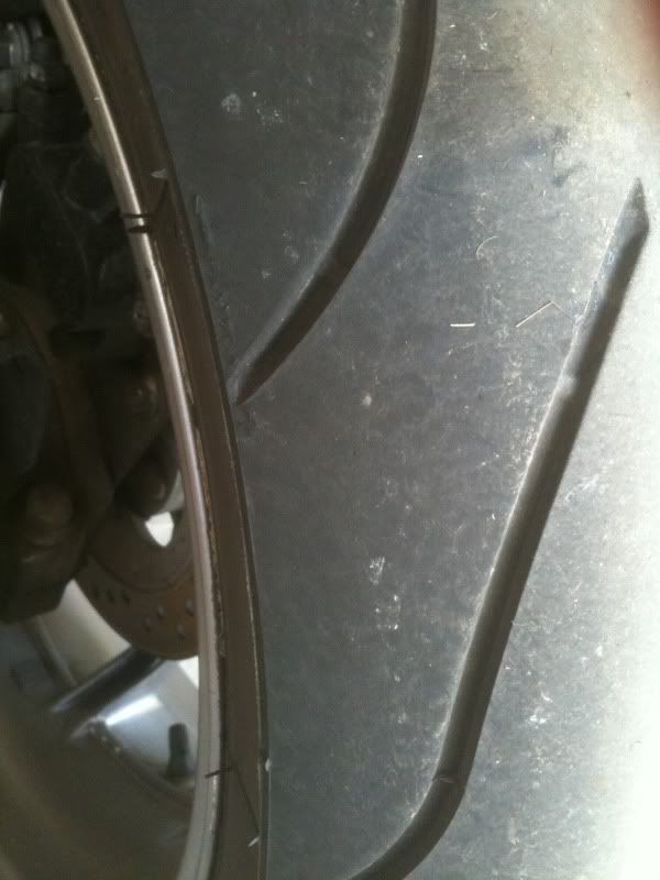

Here are pics of the tyres... so you can see exactilly where ive ridden upto.

well the tyre aint looking angry at all on the edges. going by the wear on the treaded grooves your giving it a fair bit of gas when cranked over but not in long or fast corners either that or your tyre is to hard a compound for what your after ...try running a few psi less and see how it feels. it's worth experimenting a few psi either way to get the feel your after. the vfr is going to have soft settings as std and not a lot you can do about it on the damping front and TBH the bikes pre load should on that model ever be to much even though it's good at 2 up with luggage its still not track bike hard!
