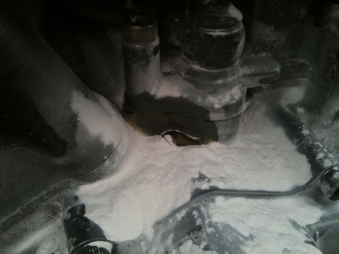

At this point, i had a feeling that it was all going too well. When i noticed a couple of drops of oil on the floor Sad . Had a good look around the engine while running, and cannot for the life of me see where its coming from. Anyone got any ideas as to finding it?

Chances are the oil is just coming out of an over flow, the best way to find leaks is with talc
Like here
https://img.photobucket.com/albums/v295/chris-red/c710ff40.jpg

Talc!! I would never have thought about that. Cheers mate.
Il nip and grab some, then get messy.
