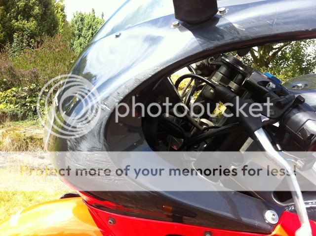

It has been dropped at some point and the front fairing has quite deep scratches down one side.
Option 1) purchase second hand fairing and a re-spray
Option 2) attemp to remove scratches and re-spray

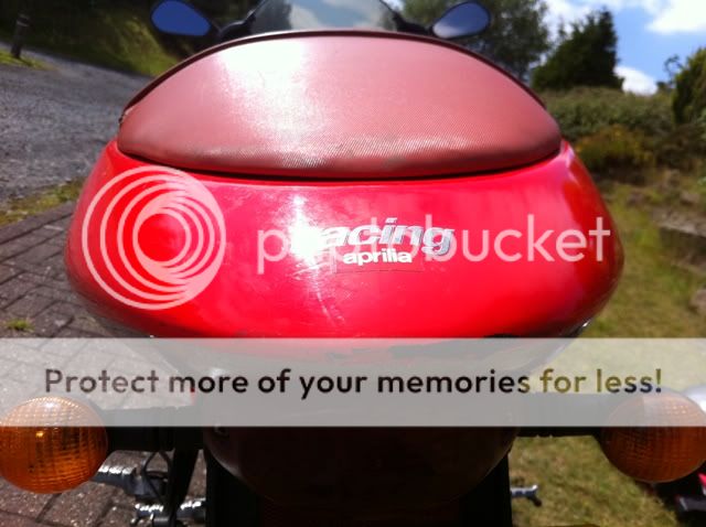

Rear cowl, again scratched at the rear. I've just purchase a 2nd hand one which I'm going to have a go at cleaning up / spraying. If all goes well with the re-spray I'll have a go at the front fairing and maybe the bike.

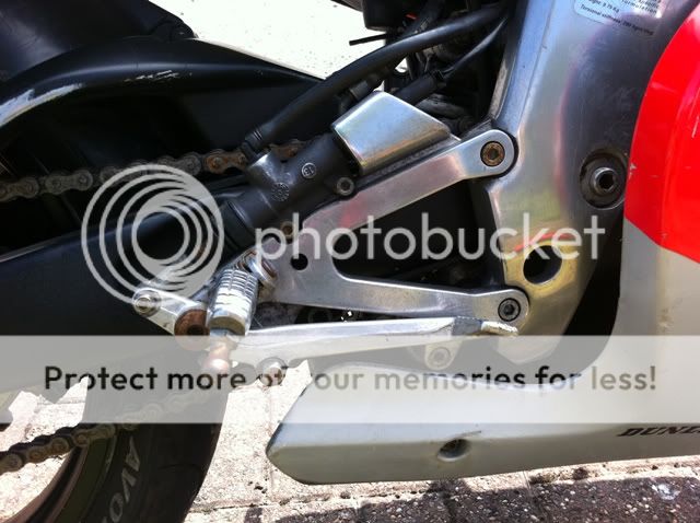

Sort the bits of rust around the foot pegs / brakes.

Look's like a tidy little bike i would attempt the faring's myself if i was you as it's good to learn and saves ALOT of money.
The most important thing is prep work, people think the spraying is the hard part but paint finish will only be as good as it's prep work.
Take the panels off start with a rougher grade of sandpaper and start working down to smoother stuff use some Filler for the deep scratches sand the filler down and then go over the panels with wet and dry sand paper until they're really smooth.
Normally anything thing you can feel with your hand on the panels will show up in the paint regardless of how little it is.
