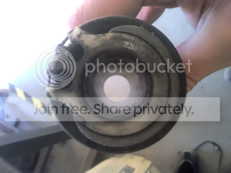

Is the fast action throttle just shortening the rotation needed for full throttle yeah? How did you do yours? Does that not make it harder to get a smooth roll on or do you get used to it quickly? (I ask lots of questions sorry Laughing)
Yeah I think the braided lines will be the first thing I do…might get it done while it’s off the road and still uninsured for the first day at Rockingham, I haven’t had a chance to use them properly let but the brake feels very spongy so I think it will be worth the money.
For the suspension I was thinking about being cheeky and asking my ex’s Dad to come along to another assessed ride with the advanced motorbikers, the IAM I think it was, (probably the most boring and uneventful hour of my life, at one point I was extremely tempted to do the ‘instructor’ on the back wheel and fuck off just to see the look on his face) because there’s a guy there who will set up your suspension for £15 if you’re a member. Or I might just rock up and blag it Laughing
I tried gluing cable ties but they kept coming off and I wanted it geared quite high (if that's the right word). In the end I got some plastic pipe that fit over and cut and sanded it to my spec. It's massively upgeared from the old throttle but I still got used to it almost instantly so don't worry about that.

Are there official quick action throttle bodies you can buy? Or is it just best to knock one up? (I would google it but I’m at work, I have to copy and paste your posts in to an email then write out my reply in case anyone important walks past Laughing)
Is it not an upgrade that is worth doing anyway? I might do the bleed the brakes next week on my time off and see how they feel. I was going to put some braided lines on my FZ because I wasn’t impressed by the brakes at all but never got round to it due to the Renthal bars I would of needed custom length lines, the brakes let me down on Monday night when I was being an attention whore at H café and held a wheelie too long up to the roundabout past everyone, couldn’t get it stopped in time and had to go up and over the roundabout to avoid a possible crash by attempting to chuck it into the roundabout… Laughing
Try Performance Parts Ltd, say you spoke to them at a BSB meet and quoted you £99 for a ZX6R kit. That's what I was told when enquired at Oulton Park.
01788 869100
Bodge job it is then…Laughing that’s another track day that sort of money!

@Red Devil
Here's a pic of my throttle mod...
https://i32.photobucket.com/albums/d9/T0mmy200sx/IMG_20120511_191535.jpg
Just got a piece of pvc pipe of the right internal diameter, cut it down to fit, glued it on then did a bit of sanding. That pic is a work in progress, I sanded it down more than that as the cable was going through too steep a turn so it was catching. I think this is a lot better than the cable tie method as I struggled to get it to stay attached and if you want it this much quicker action you'd need at least 3 cable ties on top of each other.
It's a bit fiddly to get it right but not hard to do at all and really useful on track as your wrist will be absolutely knackered without it. Basically free as well as I happen to have shedloads of old bits of pipe hanging round at work. If you have trouble finding some suitable pipe I can bring some along to a trackday at some point.
