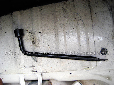

lockheed
Joined: 19 Jun 2011
PostPosted: 10:44 - 10 Aug 2011    Post subject: Reply with quote
I don't get what problem you have with tyre iron. It allows good reach due to its shape and if you are not club-handed, it is not really less precise than spanners. DITTO

Well, neither of the pictures show what I used, which is this:
https://1.bp.blogspot.com/_B88Ep9FD0oE/SREswW-08QI/AAAAAAAAApQ/OOMDBn6a1ug/s400/tyre1.jpg
Worked pretty well, regardless of the name.
