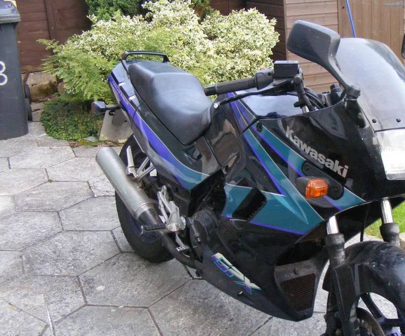

Ok, here are some pics so far.........
https://img.photobucket.com/albums/v448/stonefly/Project%20GPX/DSCF4157a.jpg
This is the bike as it arrived at my house.
The pic makes it look pretty clean but it was in fact filthy with dust and grime.

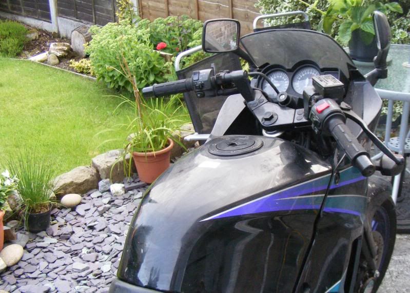

https://img.photobucket.com/albums/v448/stonefly/Project%20GPX/DSCF4158a.jpg
It is a little clearer here, that there is a layer of crud covering the tank and the rest of the bike.

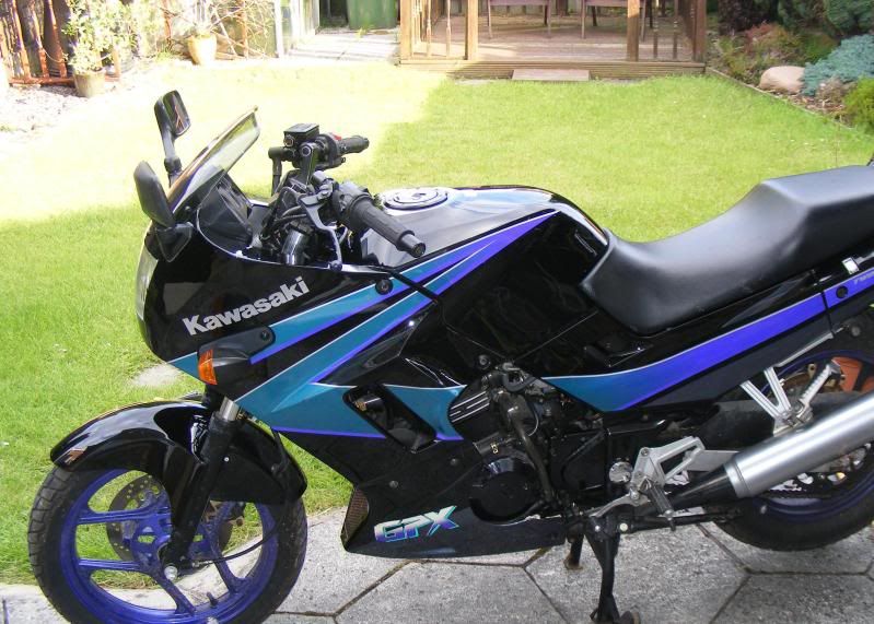

https://img.photobucket.com/albums/v448/stonefly/Project%20GPX/DSCF4162a.jpg
As i said, the mileage is unbelievably low and i know that it is genuine. (I have known the previous owner as a colleague and friend since 2003)
https://img.photobucket.com/albums/v448/stonefly/Project%20GPX/DSCF4165a.jpg
After a good wash and the application of some autoglym super resin polish, its looking very shiny indeed.

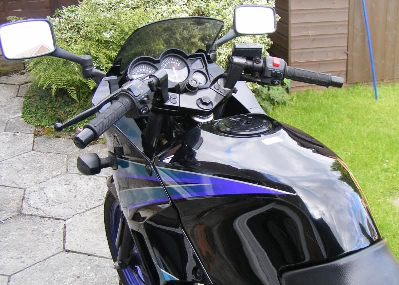

https://img.photobucket.com/albums/v448/stonefly/Project%20GPX/DSCF4167a.jpg
The paintwork is in very good condition and now that it has been treated to a good polish, you could almost use it as a shaving mirror!

wow! that looks like a minter! On the paintwork front any small scratches ( i thought i could see a few long ones on the tank) can be easily removed with a dual action polisher and a bit of patience.
Stonefly
Joined: 17 Jul 2011
PostPosted: 15:59 - 18 Jul 2011    Post subject: Reply with quote
Hazza, yes there are a couple of long scratches on the tank. It had been stored in a garage for 5 years and 'things' including a mountain bike, had been stored on and around it. Bit of a shame that, but I will definitely try a dual action polisher. Can you recommend one to me please?
