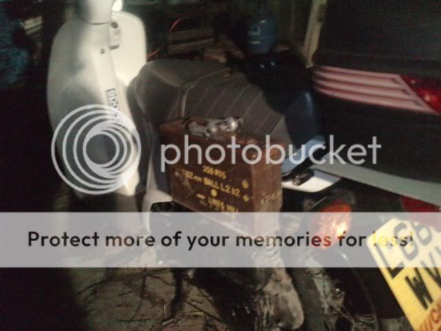

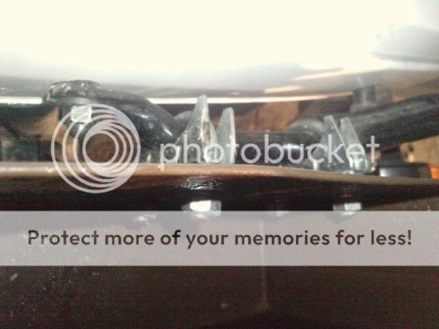

As billing said, ive got some on my SH.
Bolted on using small exhaust brackets bolted round the frame tube, or in my case, rear grab rail / rack. Bolted inside with washers.
I havent had a problem yet, been on for a while carrying tools/spares/sandwiches etc. Ive even used them to support the bike when i had to lay it over.
Just uploading some pics Smile

Theyre only small, but its a small bike!
