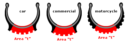

Only parts of a tyre that can be repaired is the central part of the tread, this then only really applies to small punctures (nail holes etc). Sidewalls and the bead aren't repairable. I suppose you might theoretically get away with fitting an inner tube and running the tyre tubed but not really worth the time, effort and risk when scooter tyres are so cheap.
https://www.blackcircles.com/wso/images/library/obj22705?view=2885
