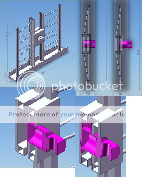

PostPosted: 14:54 - 17 Sep 2011    Post subject: Reply with quote
Knock out the wall and dig/drill some holes/foundation to bury some steel frame that the anchor is welded to. Make mold with wood then fill with concrete, finish with bricks/plaster to hide it all.
Weakest link will probably be whatever it you hook the thing up to the anchor with.
EDIT
Got bored, put something like this in your wall.
https://img.photobucket.com/albums/v612/SoND/GWALLsm.jpg
