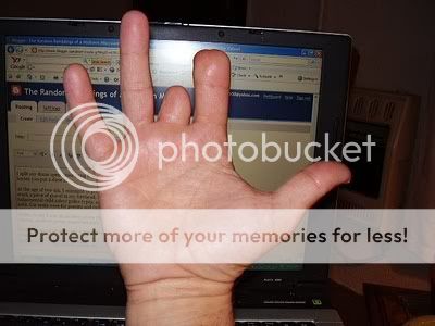

Yeah, if you're taking oil off, don't let the bike turn the rear wheel, turn it manually. If you're just lubing it up and not having any contact with the chain itself by all means. But there was a guy lost fingers cleaning his chain with his bike in gear!

PostPosted: 12:31 - 22 Sep 2011    Post subject: Reply with quote
Yum..
Graphic images.. Beware
https://www.gixxer.com/forums/showthread.php?t=242261

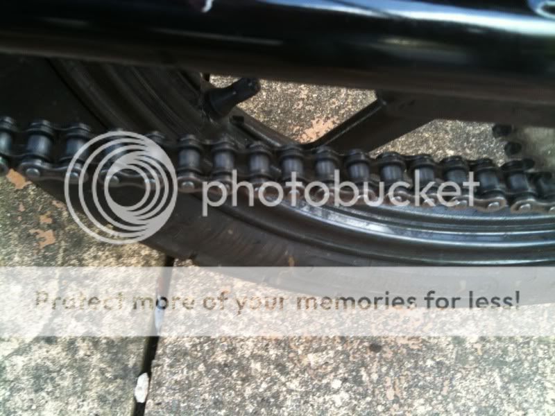

Recluso
Joined: 16 Mar 2011
PostPosted: 12:25 - 23 Sep 2011    Post subject: Reply with quote
Yeah, I'd rather not lose any fingers (curse you and your links, Paddy! Razz). As tempting as it might be to try and speed things up with the engine running, I'd rather not risk it. I've got the wrong sort of luck.
So! With the help of some paraffin, a toothbrush, 2 hours of elbow grease and an assortment of rags, I present my much cleaner looking chain!
https://img.photobucket.com/albums/v357/Inkersall/Bike%20Stuff/IMG_0314.jpg
https://img.photobucket.com/albums/v357/Inkersall/Bike%20Stuff/IMG_0313.jpg
Admittedly I probably could have gotten it even cleaner but the paraffin fumes were starting to get to me a little bit. But it's a huge improvement. When I took the chain guard off and actually got up close and personal, I was shocked at just how dirty it was! There was so much gunge and grime (and hair... don't ask. I don't want to know myself) in there that the toothbrush was fully 'gunged' within about 20 mins and I found it far more effective to get in there with a few rags and clean it.
Lesson learned though. I'm going to be far more careful about cleaning my chain from now on.
Once my head's stopped spinning I'll clean the rest of the bike. Just look at the state of those wheels! Very Happy
Thanks for all the input though folks, had I not thought to ask, I would have just gone out and spent £7-£8 quid on a branded cleaner rather than a couple of quid on a bottle of paraffin that did the job better than I ever could have imagined!
