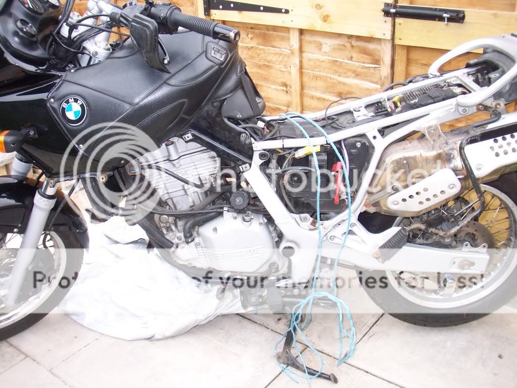

I recently bought a BMW F650 & the racks were pretty rusty;
https://i361.photobucket.com/albums/oo53/ferretmonsters/bmw%20f650st/before.jpg

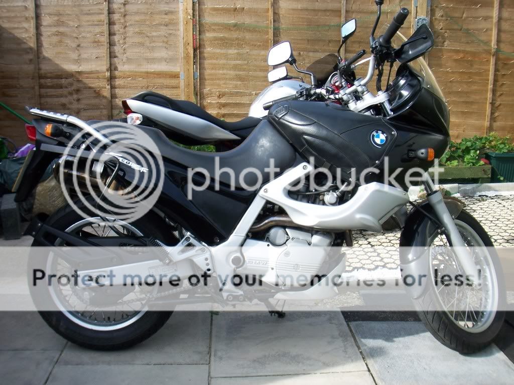

I just got the loose stuff off with a wire brush & gave it a quick go over with something like P40 paper (very coarse) - find that the rougher the surface the better the grip/key for the paint....used Hammerite direct-to-rust paint 3 coats & the results are fine for me;
https://i361.photobucket.com/albums/oo53/ferretmonsters/bmw%20f650st/painted.jpg
