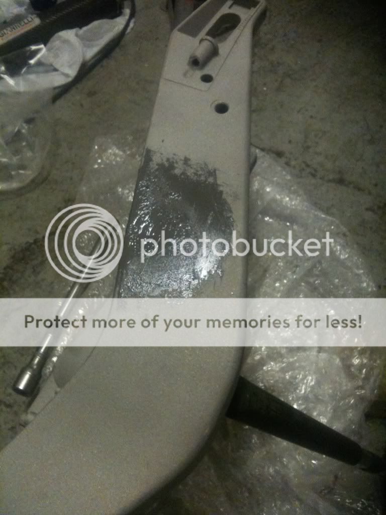

https://i1112.photobucket.com/albums/k493/steven_191/4628dcb7.jpg
I used that JB weld. It says it's heat resistant to 300deg and the powder coaters say they bake the ally parts at 200 so should be fine.
I've put in on over quite a big area but really it's quite a thin layer. It wasn't a big dent and I managed to heat up the arm and use a lever to pull out the bottom edge. Just the bit above that that had stretched that I needed to level out. I sanded it after this and most of it came off.

As myself and kestrel mentioned the rate of thermal expansion of the two different materials can break the bond between them. There is also the risk of air bubbles getting trapped in the filler. It'll be interesting to see how it turns out.

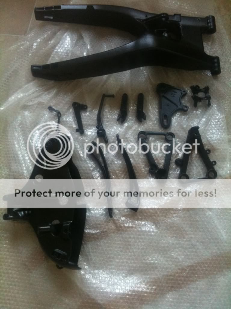

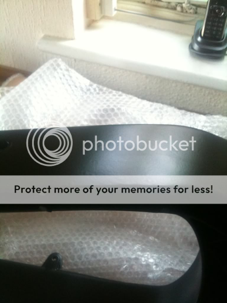

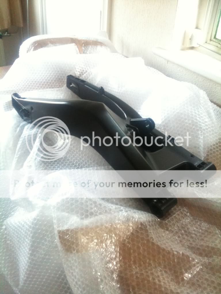

https://i1112.photobucket.com/albums/k493/steven_191/5151d4b1.jpg
https://i1112.photobucket.com/albums/k493/steven_191/694786f4.jpg
https://i1112.photobucket.com/albums/k493/steven_191/da15b4e8.jpg
JB weld appears to work fine on ally parts being powder coated. These were baked at 200degC
The guy said after the first coat you could see and round mark where the powder was around the JB weld so they coated it again. The extra layer sorted the blemish so that may be something to consider.
Overall good results
