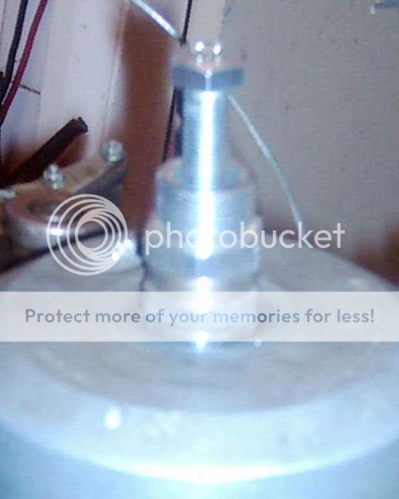

However, the 'tool' is normally a flywheel puller, that screws into a thread in the rotor, and has a bolt down the middle you tighten to pull it off the taper on the crank.
Here you are; here's the one for my Montesa, screwed into the Motoplat Fly-Wheel:-
https://i178.photobucket.com/albums/w269/teflons-torque/071_A_002_Tools/puller.jpg
Not so wonderfully clear, but gives the idea. bit that looks like a pipe fitting, screws into thread in the flywheel, around where the rotor nut sits. Once you have it well in the threads, and its a large, fine thread, so screw it in CAREFULLY as they are easy to strip, and being fine, make sure you screw it ALL the way in, or with only a couple of threads engaged and such thin threads you'll pull them out the flywheel, not pull the flywheel off the crank! (TIP: remove the bolt down the middle before you screw it into the rotor to make sure you bottom extractor in rotor threads and dont go only half way and start trying to screw the extraction bolt against the end of the crank)... once the pipe fitting like bit is screwed all the way in, you can put the extractor bolt into it; hold the pipe fitting bit with a big spanner or pipe wrench and then wind the extractor bolt in against end of crank with a regular spanner. Makes job dead simple, and a lot easier than trying to beat the flywheel with a hammer, or grip it with the claw of a hub puller, or hold it still while you twist anything around it.... you just need to hold pipe wrench and turn it against the spanner, and fly wheel just pops off.... usually.
They are normally about a tenner or so, unless you are looking at generic or universal flywheel puller kits that have numerouse adaptors to fit different flywheels, which are typically around £30 or £40... which I dont deem ultra 'expensive' for a specialised tool, that can give years of good service and be used many many times, for less than cost of getting independent mechanic to do no more than 'have a look' and charge an hours shop rate for the privilidge!
So either your idea of 'expensive' is different to mine, or you are looking at an anomolouse one, where the puller is a part specific, available only from dealers kind of thing.
In which case, or perhaps in any case, alternative solution, I have used where flywheels have been so tightly wedged on the crank they wont come off even with propper puller, is to pop round my local engine reconditioners, who for a fiver in the beer-fund, will put the thing in a hudraulic press for me and use whatever jigging they find most appropriate to apply gross, but evenly applied force to hoik the thing off for me.... actually, thinking about it, last time they did two for a fiver, for me....
CB125 Flywheels actually that hapily don't need a special puller, just I think its an M14 bolt that screws in the middle of the flywheel and pressed against the end of the crank to press it off, giving moments jubilation, then hours of frustration hunting a suitable sized bolt, until after trying everything lying around, or screwed into other pullers, ball-joint extractors etc, even wheel and swing arm spindles, you admit defeat, and discover that the only place you can GET that size of bolt is at Screw-Fix, they are stainless, and come in packs of five, for something daft like £12, making it just as expensive as a special puller...... and after going to screwfix, and waiting twenty minutes for the Argos reject to process your ticket, and arthritic Focus redundancy candidate to find a set of ladders, slide them along the racking, consult teh Health & Safety clipboard to ensure they have observed protocol, and watched enviousely as an octagenerian spritely clambers up the ladders at one rung per hour... jelouse that at twice my age they can still CLIMB a ladder at all.... you get bolt, get home and find that the ruddy flywheel STILL wont come off the crank, due to an over tightened rotor nut at some point, and twenty years of corrosion! But I digress!
