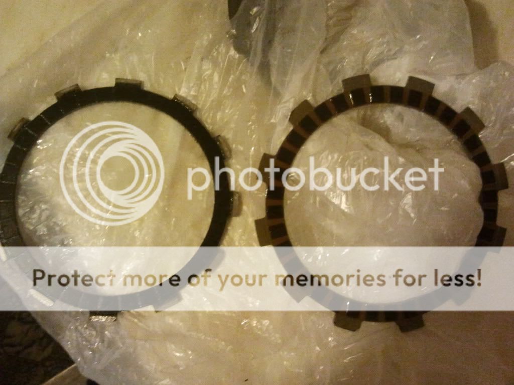

Snow rider wrote:
Does it matter if the no.1 plate is broken?
It isn't destroyed just snapped in 1 place.
Been quoted £100 for a new one.
Take it to the garage that holds engines for years on end and then fixes them for free, I am sure they will do it for £1.94 and a punch to the throat.

As a minimum:
New clutch basket, new friction plate.
If I was you:
New basket, set of new friction plates, set of steel plates, set of springs. New oil and filter, and make sure you find the broken pieces, bam.

In all seriousness Warped, I wouldn't ride a bike with a broken clutch plate and you shouldn't either, get it sorted before you get it back on the road.
Are there any good Hyosung parts suppliers, like david silvers but for Hyos?
It IS a consumable so they must be available, if a garage is charging £100 to replace it then that would include about an hour and a half labour and 100% mark up on parts, suggesting the plate itself is somewhere around the £20 mark. You could always ask them to order the plate and sell it to you if you struggle to source it yourself.
How worn are the other plates? Does a clutch kit include the no1 plate?
If so it might be an idea to just change the lot.
