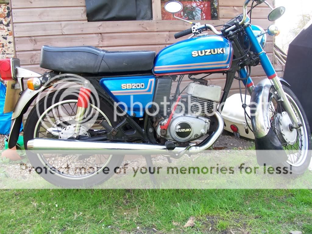

Ok here is my project,a Suzuki SB200
https://i717.photobucket.com/albums/ww175/twostroketit/2007bikepics001.jpg
This bike was bought from a local breaker 2 years ago and was a one owner from new 1980 model,unfortunately she hadn't been started for 14 years so had seized.She freed off when she was pushed forward gently in gear.When i stripped the engine down the top end was fine,there was no damage to the pistons or to the bores. The carb slides were seized as well but freed off easily enough,the inside of the carbs were in a right mess and took two weeks to clean out, a bloody nightmare.When i tried to take the back mudguard off it was rotted right through and fell to pieces.After trying to get another one for months and failing i took the decision to junk the seat,the mudguard and the rear light and turn it into a little cafe racer.I was keeping the bike round a friends house but that meant i couldn't get there to work on it very often, so i've now brought it back to mine and i'll work on it here.Not ideal because my shed is full so i'll have to work in the garden but never mind. I only took the one picture when i bought it so i will go out tommorow and take some more. The sb200 is a very close relation to the GT200X5.They share the same engine and frame,the major difference being the SB has a four speed gearbox instead of five,the carbs are smaller and it hasn't got electric start. The X5 also makes about 2 more horsepower and the compression ratio is higher on the X5,i've yet to find out how. The X5 has a disc brake and cast wheels and more racey bodywork. So my intention is to get it up and runing as a cafe racer and then as funds allow to add X5 carbs and get it faster.

i'll tell you why this has had a limited response.
It's a PIG to read!
Paragraphing was an amazingly useful innovation, wasn't it?
Nice bike though, whats gone on with the red kicker? Razz

Looks like fun, dude. Any chance of more current photos?

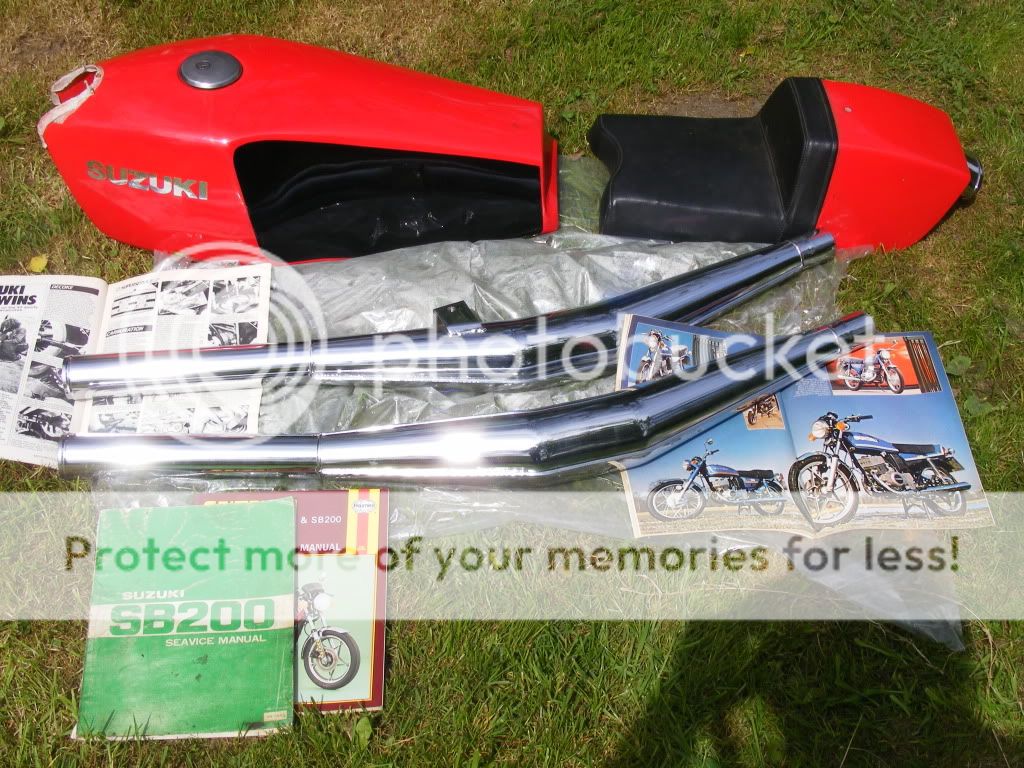

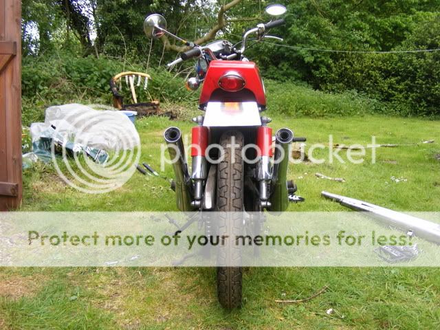

I made a start today,first things first... I've did some spending on ebay a year ago and bought these goodies
https://i717.photobucket.com/albums/ww175/twostroketit/DSCF1722.jpg
The tank is off an X7 and has been extended a few inches. somebody else can take the credit for that,they've done a good job.The seat unit is Yamaha TZ i think,loks just right i think.
The Microns are a bit of a gamble as they are not for a Sb200 or even a GT200,but they are in new condition.
I pulled the old exhaust off and trial fitted one of the Microns,it's the right diameter for the downpipe but the rear brackets don't meet up,so i'll have to do some work there.

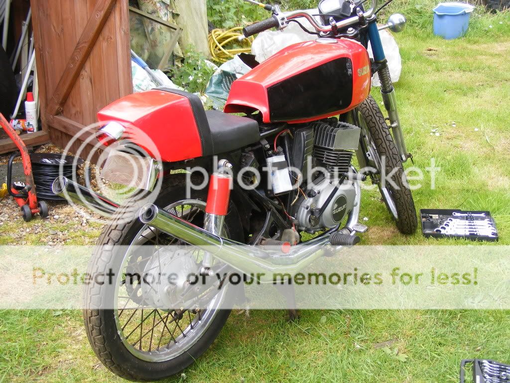

I got all excited then and started balancing the bodywork and the microns on.I think it looks great,but then i would wouldn't i?

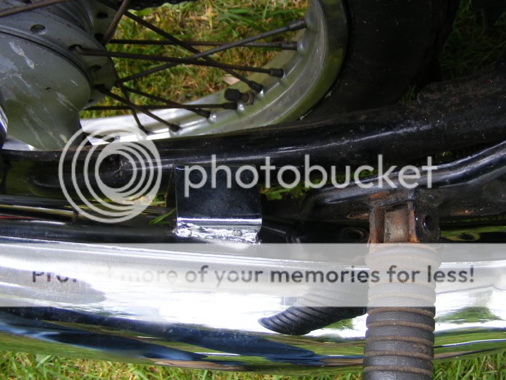

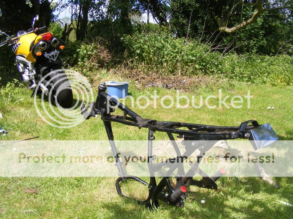

Started stripping the frame down ready for painting,one thing that's not going to get changed is this blue tape and sticker on the clocks. It just seems evocative and it's a link to the only other owner of this bike,so it's staying on
https://i717.photobucket.com/albums/ww175/twostroketit/DSCF1732.jpg
I finished off by dropping the engine out of the frame and taking off the front footrest bar. I am getting quite a pile off unwanted Sb200 bits,so i might be able to raise some capital there.
I've still got to get some proper little clip ons, sort out some rearsets and fit the bodywork so there's a long way to go yet.Oh yeah,and i've made up my mind,she is definately going to be painted white and blue.My second favourite colour scheme after Yamaha's yellow and black.

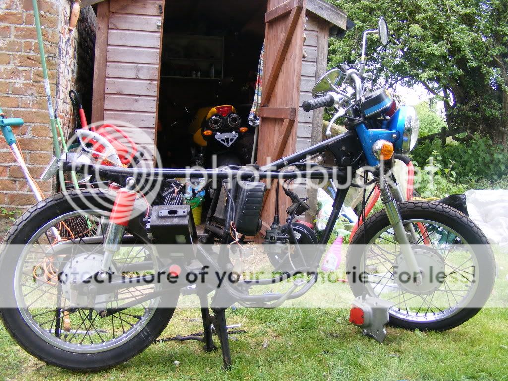

One job i did manage to when it was round my mates was to ditch the fork shrouds so it's now got exposed springs for that authentic 1970s race look.
https://i717.photobucket.com/albums/ww175/twostroketit/DSCF1736.jpg

Looks the nuts, shame about the push bike tyres but I doubt there's nothing you can do there. Are going to change the drums for discs? Thumbs Up

Needs clip ons Mr. Green

I know what you mean about the pushbike tyres,but that's just what bikes were like in the bad old days. Smile
I could put the X5 forks and cast wheels in then i would have a disc on the front,but that might detract from the olde worlde feel and they're the same width.
I honestly can't make up my mind about whether to have a disc or not,drums can actually work quite well.
Needs money Mr. Green
I will put clip ons on though,just working to a very tight budget at the moment.

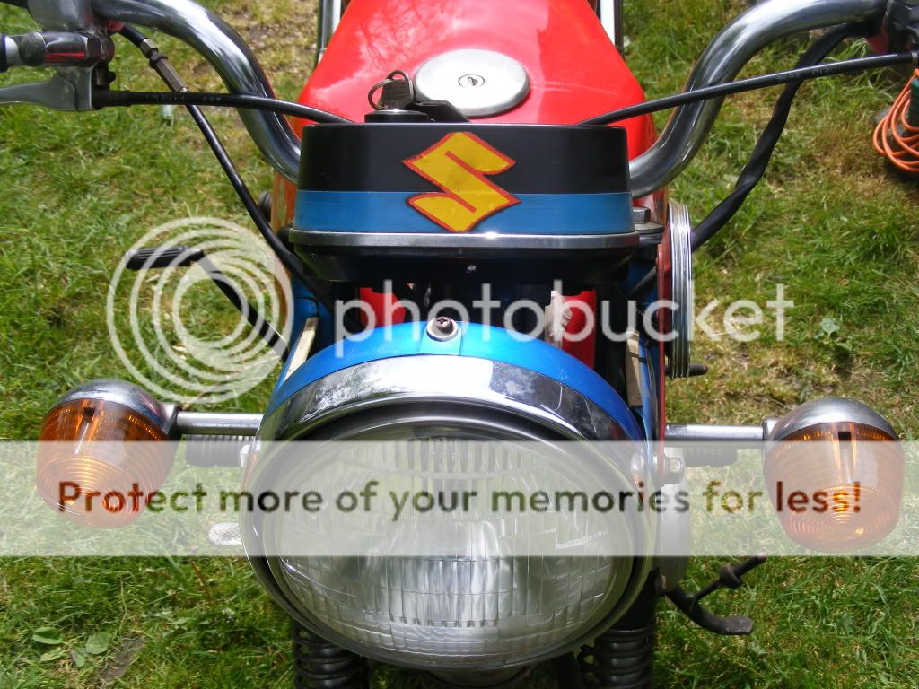

i might sound like and idoit
but where are you putting the clip ons
in that pic off the head light the gap doesnt look that big
nice work on the build so far
be waiting for the reassembly (thats the best pat)

I did some work on her yesterday.All i've got to get off now is the airbox and the swinging arm.Unfortunatly one of the screws holding the airbox on turned to mush when i got a screwdriver on it.
As it was near the end of the day i gave up and had a cup of tea instead Smile I'll have to borrow an impact driver though.
I also dropped one of the ball bearings when i took the bottom yoke off. Despite spending two twenty five minute sessions looking for it it remains lost. Mad
The clip ons will go on the fork legs just underneath the top yoke,but that will mean junking the standard headlight brackets and finding some new ones.

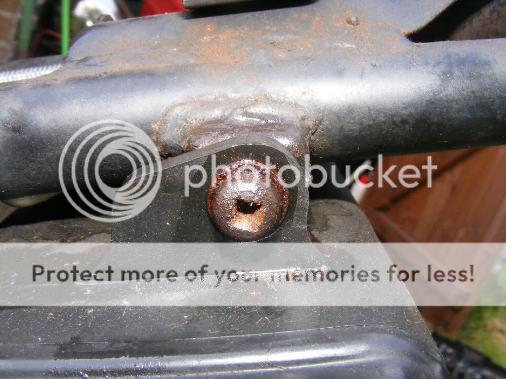

I managed to get out and do some work on her today. First of all i had to tackle the knackered screw holding the airbox on.
https://i717.photobucket.com/albums/ww175/twostroketit/DSCF1757.jpg
Because i was unable to borrow an impact driver i decided to cut a slot in the screw with a chisel. After a couple of gentle taps so that the chisel could start to bite i gave it a good hard hit.The shock was too much for the airbox housing which promptly broke!
IMG]https://i717.photobucket.com/albums/ww175/twostroketit/DSCF1769.jpg[/IMG]
Fortunately the screw also loosened so i was able to unscrew it by hand,unbelievable!

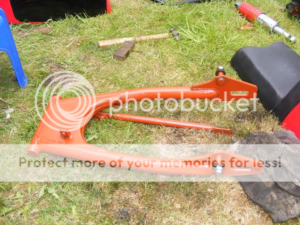

Next up i stripped the swinging arm and the mainstand and brake pedal off the frame.
The frame is quite rusty in some places,so is the swinging arm. In an ideal world they would be blasted and powder coated but that aint going to happen.
https://i717.photobucket.com/albums/ww175/twostroketit/DSCF1762.jpg
I've got some primer in the shed so i spent about two hours cleaning the arm and sanding it down ready for priming. Unfortunately i picked up a tin of ford terracotta red instead of the red oxide primer,i only noticed after i put the first coat on Embarassed
It was a little bit gloomy in the shed Rolling Eyes
https://i717.photobucket.com/albums/ww175/twostroketit/DSCF1764.jpg
So tommorow i'll go out and scuff it down again,this time i'll use the primer. Very Happy

The swinging arm isn't terracota anymore Laughing i painted that black with some Halfords marracas,but i cant afford to buy enough to do a whole frame.
