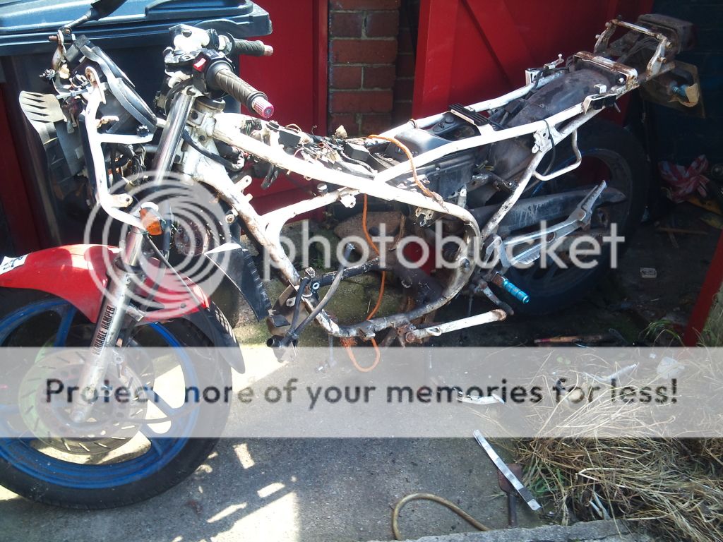

Bare bike:
https://i209.photobucket.com/albums/bb54/stevenns125/RD.jpg
Can anyone tell from looking at it of any vital parts missing?

st3v3 wrote:
Bare bike:
Looks like an F2
Missing:-
Brake callipers.
Frame infill panels.
Speedo cable holder in the mudguard.
2T oil tank.
Water expansion tank.
Hope that tank's leak proof, they're getting a bit on the expensive side now. They usually go on the 90 degree lip just above the seam.
