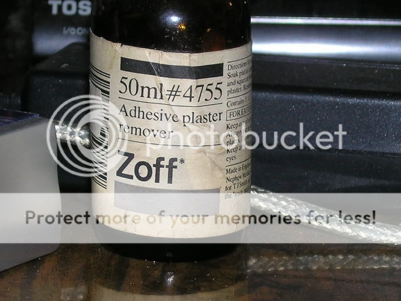

Here's what worked for me, from the other thread:-
Suntan Sid wrote:
Right, I just did, what you're attempting, earlier this evening.
I started another thread about it here:-
https://www.bikechatforums.com/viewtopic.php?t=234762&sid=7207a6b8c1fd821dd75c873072d27332
Here's how it worked out.
Step 1. Get a hairdryer set it to hot and heat up the decal at one end. After 30 seconds or so you should be able to lift an edge and start peeling it off carefully. If it's a long stripe, (it was in my case), peel off a couple inches then apply more heat to the next part of the decal, repeat until you've finished.
Step 2. You will probably be left with all the glue that was holding the decal in place. My first thought was to use cellulose thinners, it did work but I was worried that it would take the paint off underneath. Tried some white spirit, that wouldn't touch it, petrol didn't work either, neither did a "scotchbrite" scourer or nail polish remover.
During lunchtime I bought a can of "Label off Super", from a DIY store, made by a company called "CRC", it came in a small aerosol can and cost about 5 Euro. Sprayed some on the glue and left for a couple of minutes, this melted the glue, however I still had to scrape the glue off with a plastic knife. Wash it afterwards to get rid of any residue.
https://www.bilight.biz/showfoto/480/480/goods/32351/32351_01_108065091258.jpg
Hope that helps!
