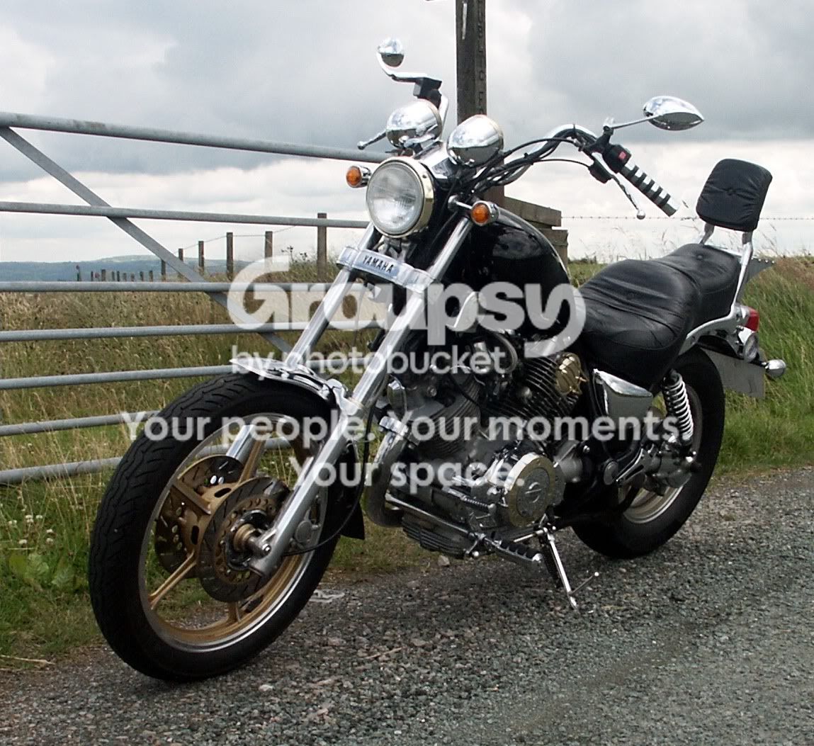

Unless you have a big mop 15 minutes isn't going to be enough. I've done a lot of polishing and it takes hours to get the finish you want. One tip is to sand it with wet and dry, wet, in an orbital fashion, as random as possible. Rubbing back and forth creates marks all going in the same direction which are harder to polish out.
You also need to ensure that all of the scratches from the lower grades of paper are removed before moving to the next level. I rarely use more than a 800 grit for major work and then a 1200 prior to polishing.
To get these fork legs to a similar shine as the stanchions took about 4 hours each side
https://i93.photobucket.com/albums/l41/marki_03/xv1000/edit4.jpg
The quality of the aluminium also causes problems. If you look at my old eliminator you can see different finishes in the fork legs, timing cover and clutch cover. This is just down to the differences in the alloy. Sometimes you just have to accept that the finish is as good as it gets.
