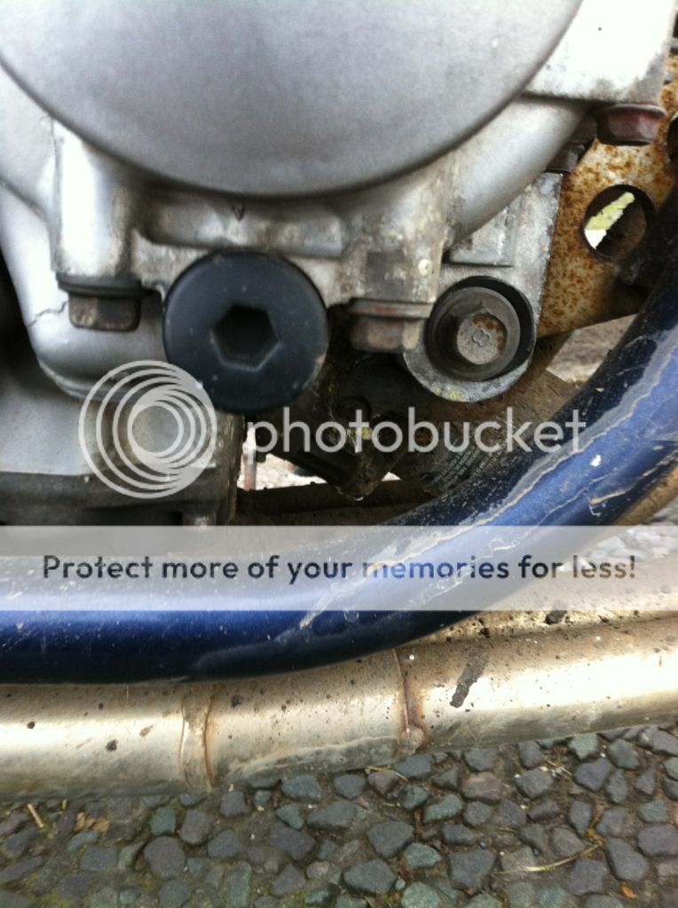

Can somebody please tell me what this black plastic allen screw if for..

Item 35 from this parts company looks like it...
https://www.yamahamotorcyclespares.co.uk/SPARES/epc2.asp?modelID=9533&PageID=12&m=YAMAHA+XJ600N+Diversion++CRANKCASE&uid=0

Cheers for the link Thumbs Up It could but I'm a bit cocenerd to remove it incase something comes flying out. Very Happy the picture does not show what it is for or behind it?

Coolant drain plug?

Oil gallery plug. The casting is drilled through and that plug is just a stopper to keep the oil in.

The XJ600 is air cooled.

How far does that (apparent) crack go? One to the left of the plug.

I thought it was a crack it's just the paint were i touched it up Thumbs Up

[quote="Pete."]Oil gallery plug. The casting is drilled through and that plug is just a stopper to keep the oil in.
That makes sense better leave it in then Thumbs Up

I'm no mechanic so dont take my word for it but it looks like the bottm end big plug retainer screw. Unscrew that if you wish but beware. Your bottom end would fall off and your retainer would be screwed.
This.
I CAD modelled an engine block from a 1.7 Puma.
It had an oil gallery that ran the length of the block and it had an allen head plug just like OP's.
It's a manufacturing thing, cause it wouldn't have been able to have been cast without at least one end of the channel at the surface, and it cant be drilled from the inside. So it's just drilled straight through the side to make the gallery and then plugged.
