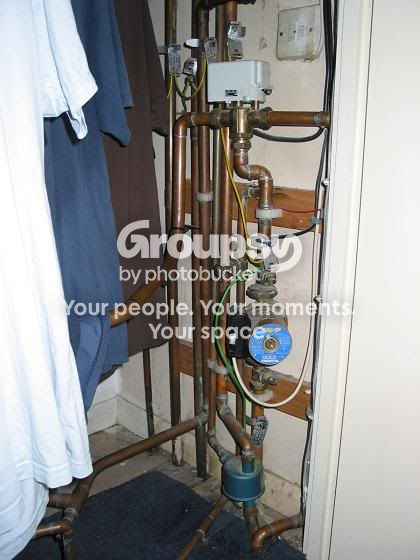

https://i226.photobucket.com/albums/dd26/szbiker/th_Picture224.jpg
its a normal boiler with a hot water tank system.
thermostat is normal electric type
the down stairs radiators eventually came on.
but the whole system is making a right noise when its running.
sounds like air in the system?
the pump shown in the photo(blue circle) this has 3 settings and its on the 3rd one, sounds like air is in it

if system is noisy then it could need a chemical flush and clean.
The 3 port valve is above the pump with the white box make sure that the lever is moving from side to side when asking for heating or water. If this is not happening the powerhead needs changing ie the white box. Also check the heating tank has water and is not air locked.

the white box lever is moving to the correct sides when hot water/heating is selected
how do you check the tank has water and not air locked?

locate the small heating top up tank as opposed the large cold water storage tank for the hot water. look inside, is there at least 3" of water (100mm), if not and it has a ball valve check if ball valve is stuck if no ball valve fitted using a pan & a bucket of water fill tank to 3" deep. There should also be a vent pipe that loops over the tank try blowing up the pipe and see if water in tank rises. If this works and system still noisy a chemical flush will be needed and this should only be done by an expert, however you could get from a plumbing merchant, some Sentinel cleaner and sludge remover and follow the instructions.

The pump looks pretty old and if its also noisy I'd check that its not simply the pump that's given up (hot rads upstairs, cold rads downstairs is a classic symptom, google it)
The large brass flat head screw on the front of the pump is an air bleed screw so you could try undoing it a 1/2 turn to make sure air isn't stuck in the pump. The screw also comes out and you can put a screwdriver inside the pump to make sure the impeller turns freely. Make sure the pump is off when you do this and you will get a small amount of water coming out so have a towel or container underneath.

check all points you gave,
water is in attic small water tank,
might be the pump,
there is also round the copper piping joints green mould,
might be time to get a plumber in to sort the pump and flush the system through

Changing the pump is a job that is quite easy and anybody that can wire a plug should be able to do it Most plumbers tend to just change the power head as you have isolation valves either side of pump and the connections for cables are marked up inside L N E
Dont worry about the mould on pipes its just verdigre which is natural in copper look at any copper roof. try the pump first....

the valves either side of the pump started to drip,
so a quick loosen and tighten seems to have sorted that for now.
the pump is now hot but seems to be working,
will have to keep an eye on it.
