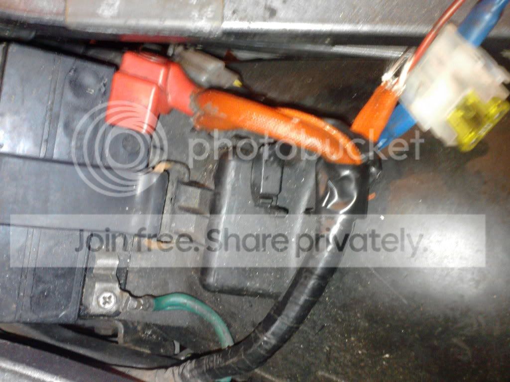

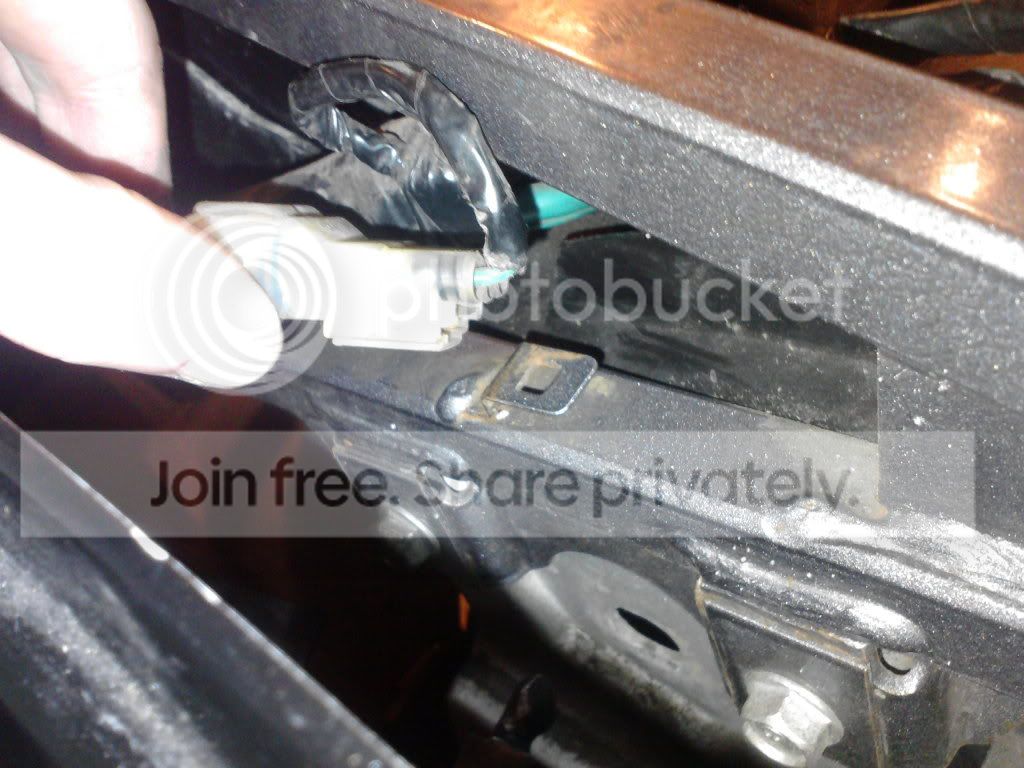

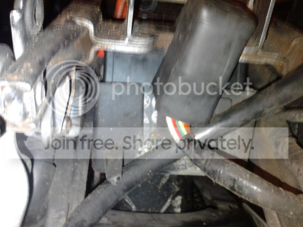

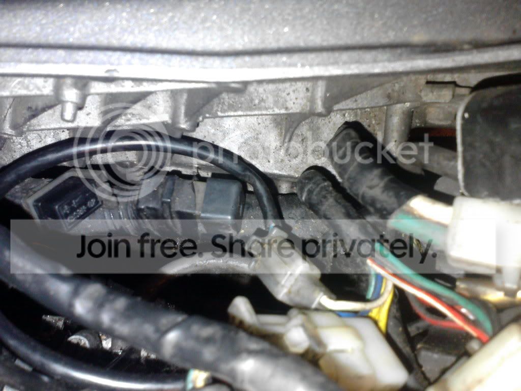

Ok got some pics which may help if you can point out where this earth should be, only got stuff coming off the positive and negative - none of which seem to go to the frame for earthing!

That thick dark green wire that goes from the battery to the loom, trace it and you should find it bolts to the plate on the frame where the rectifier attaches Smile
Make sure that the plate and the part bolting to it are shinny and clean making a good clean conection.
