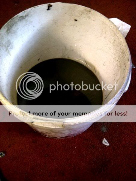

Started takin bits n bobs off, then came to draining the oil..
https://i1178.photobucket.com/albums/x362/jgrizzla/badoil.jpg
Not nice, considering that was fresh and gold only 2 weeks ago.

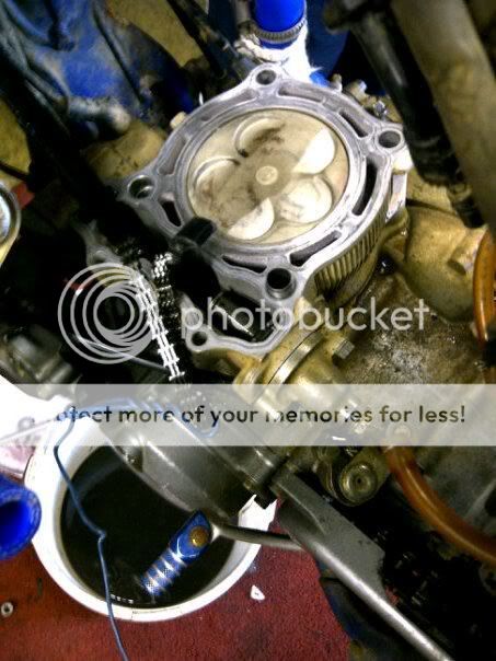

Then took the head off
https://i1178.photobucket.com/albums/x362/jgrizzla/barrel.jpg
Seems fine, gave it a little clean up and it come up really nice, no damage to the piston or barrel from the looks of it.

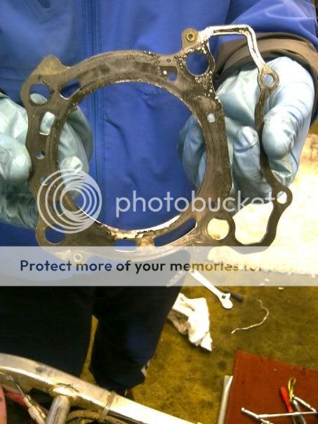

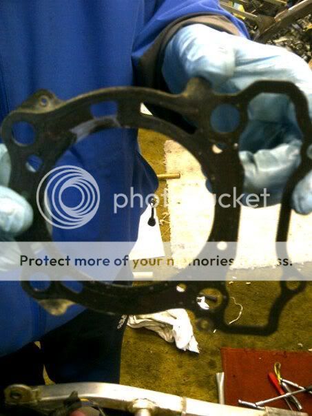

so, as for the problem?
https://i1178.photobucket.com/albums/x362/jgrizzla/headgas2.jpg
https://i1178.photobucket.com/albums/x362/jgrizzla/headgas.jpg
gone Razz
