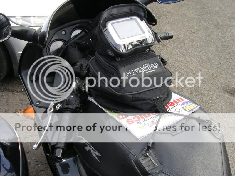

I find that the tank bag option puts it too low and too close to me to look at effectively without taking your eyes off the road for too long.
