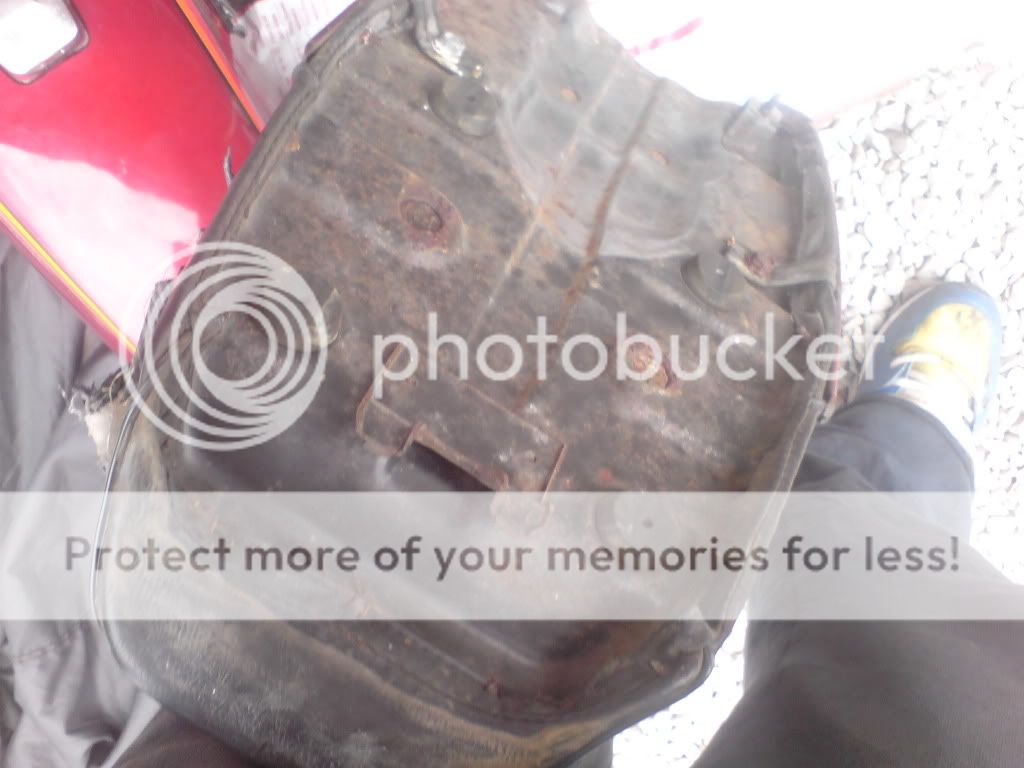

To stop it rusting further you can coat it in Hammerite paint, followed by some ACF-50, shouldn't be too bad after that since it's not an area that gets particularly wet. Thumbs Up
blurredman
Joined: 18 Sep 2010
PostPosted: 14:12 - 16 May 2011    Post subject: Reply with quote
Good thing with Hammerite is that you don't have to sand it all, just the bits which are loose (inc paint+metal) until you get to the solid metal. Then just cover the thing in it Laughing

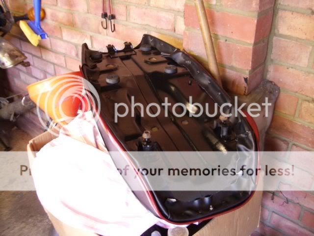

Are you planning to also replace the seat cover? When I repaired the seat on mine I stripped it down and threw away the cover. It was ripped beyond redemption and I was fed up of getting a wet arse from rain soaking into the foam. Trying to undo the bolts holding on the pillion strap led to both studs snapping so I left that off too. Never had a pillion use it anyway. I also had one of the teeny bolts keeping the metal trim on snap during removal. Still worked with one less.
Then a quick rub down and several coats of Hammerite on the metal pan, top and bottom. Left that to dry for a week or two then rebuilt the seat. I don’t know if they’re all the same design but mine was just a case of putting the foam in place and hooking the new cover over little teeth all the way around the seat. No staples. Bolted the trim back on and jobs a goodun! A bit of a wrinkle near the back of the pillion, but I'm not fussed.

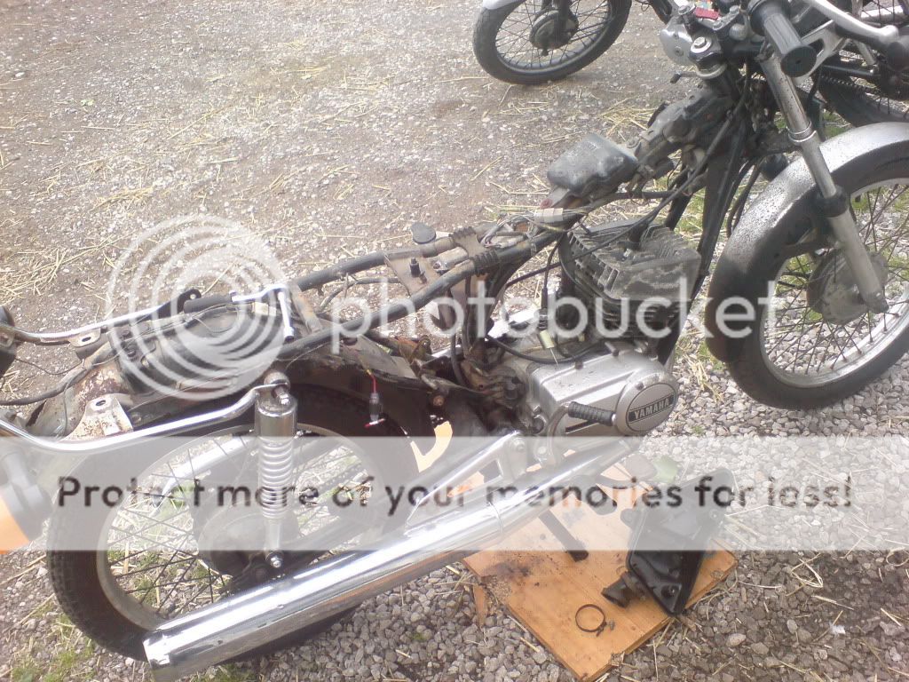

Are you sure the carb is beyond help? It's possible to use longer screws with a nut on the end if the threads are stripped.
The level of rust on the main base doesn't always correspond with the number of seat cover spikes that are missing. Those are the main thing you need to preserve and stop from rusting/snapping. But it's possible to get creative with self tapping screws in order to have something to fit the cover to if you really have to (I really have to Laughing ).
First thing that catches my eye with your RX is the pipe. It's all shiny Shocked The tank looks in bloody decent nick too. Tank and pipe alone are worth £100 or more, so I think you can rest easy that you got a good bargain.

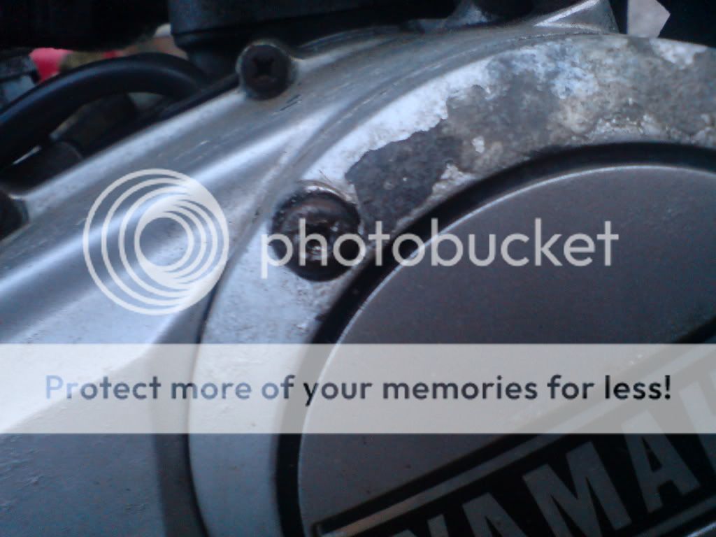

Drill the top off remove the cover then heat and remove screw.
Done.

if you can still get a bit of purchase you could also try an impact driver on it. Or cut a slot in it and use the impact driver. Or just drill it off like TUG said.

Use small nosed punch, and peen the head back over, into the rounded socket, then hammer impact driver bit into socket to reform it, THEN use impact driver on it.

To remove buggered engine case screws you just need one large hammer and one old flat head screwdriver. Hammer a bit of a slot on one side of screw, jar loose with said hammer. Job done Wink
Bung some stainless socket caps in there in place of crap cross heads.
