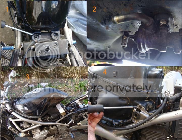

So, to start off, remove the front seat using your key. And pull off the 2 side sections of fairing, just below the tank. Careful not to snap the knobs!
Then remove the 2 10mm bolts holding down the tank (Fig 1), and pull the tank rearwards.
Lift the back of the tank up, look under the left hand side and see the pipes attached to the tap underneath (Fig 2). Pull them off, one way or another.
The tank can now be lifted off (Fig 3), and place it preferably on a news paper or cloth, just to save possible paint damage and the tap.
There are now 2 allen key bolts that hold the airbox down (Fig 4). Remove them.

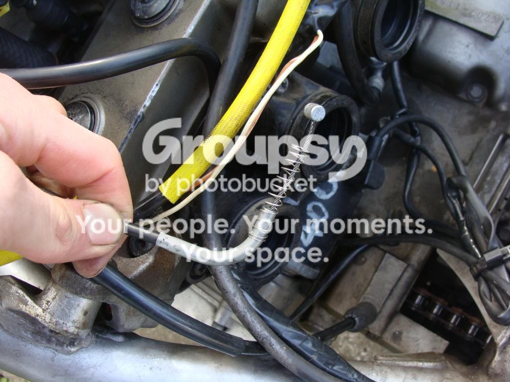

Looking down on the top of the carbs, down the gap between the engine and the carbs, you will find where the choke cable attachs. Pull the outer cable back and pull the spring back the other way, and pull the inner cable out of the cut out in the "bit where it sits". Then manipulate the cable to line up with the gap in the actuating rail and wiggle out the end of the cable.

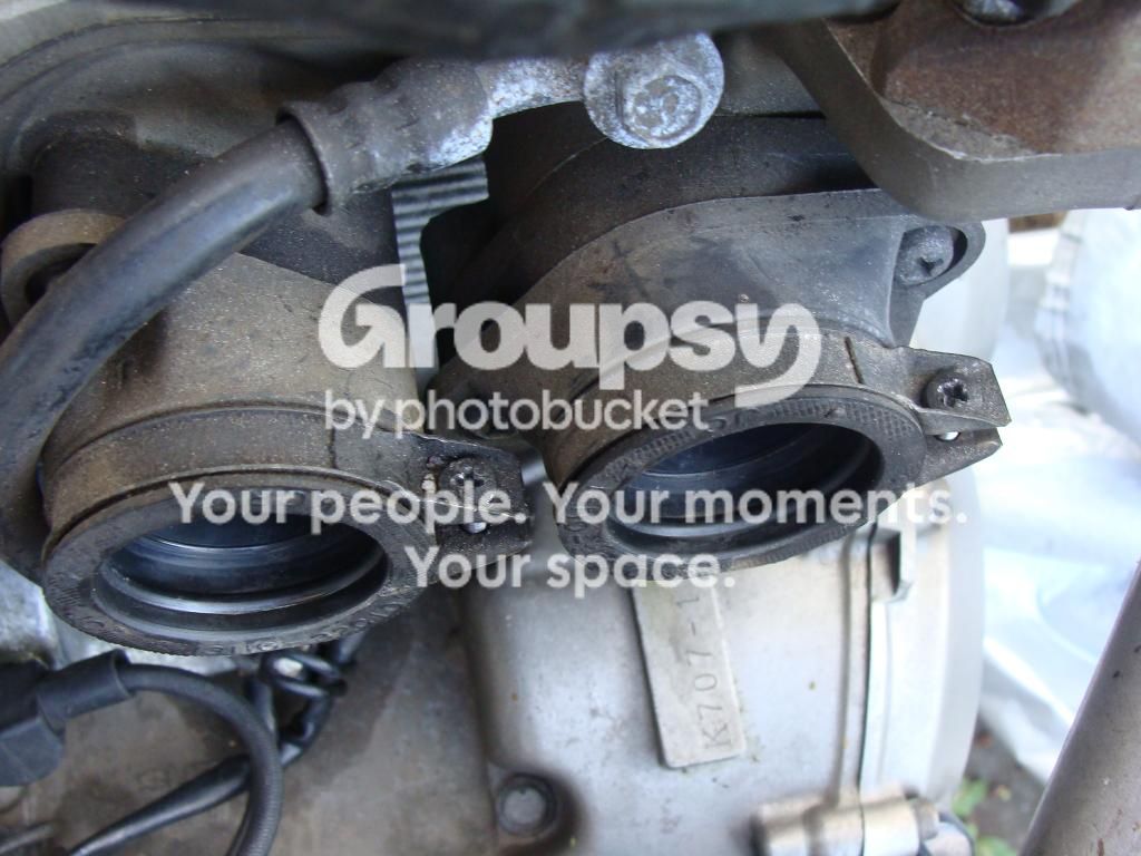

Like the air box, there are 4 clips that secure the carbs to the inlet rubbers, so undo these.
https://i1247.photobucket.com/albums/gg630/haroman6661/DSC05800.jpg
Now wiggle the carbs out. Dont tilt them too far forward or backward as they'll drip fuel out.

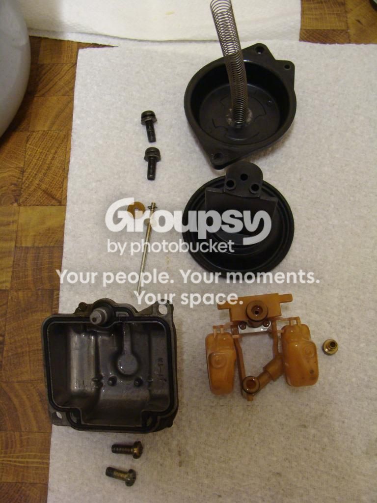

At the top of the carb is the top cap. Undo the 2 phillips screws and pull the top cap off, revealing the spring and the top of the lifters.
https://i1247.photobucket.com/albums/gg630/haroman6661/DSC05779.jpg
You can now push the lifters out, which is easy enough. The jet needle will come out with it too. DONT BEND IT!
https://i1247.photobucket.com/albums/gg630/haroman6661/DSC05781.jpg
Just tip up the lifter and the jet needle with 2 plastic "washers" will fall out (Make sure its into your hand!). For when you put it back, the white one goes underneath the adjustment clip and the orange one goes on top.
https://i1247.photobucket.com/albums/gg630/haroman6661/DSC05784.jpg
This should be now what you can see:
https://i1247.photobucket.com/albums/gg630/haroman6661/DSC05785.jpg
Give it a good clean around the lifter seal seat and all inside the top there too.
Now on the bottom side, you have the float bowls, which are held down by 2 phillips screws.
https://i1247.photobucket.com/albums/gg630/haroman6661/DSC05776.jpg
The floats are sat in there, and are probably in your case just being held by the seals in their seats.
If you wiggle it a bit then it will pull off easy enough.
https://i1247.photobucket.com/albums/gg630/haroman6661/DSC05789.jpg

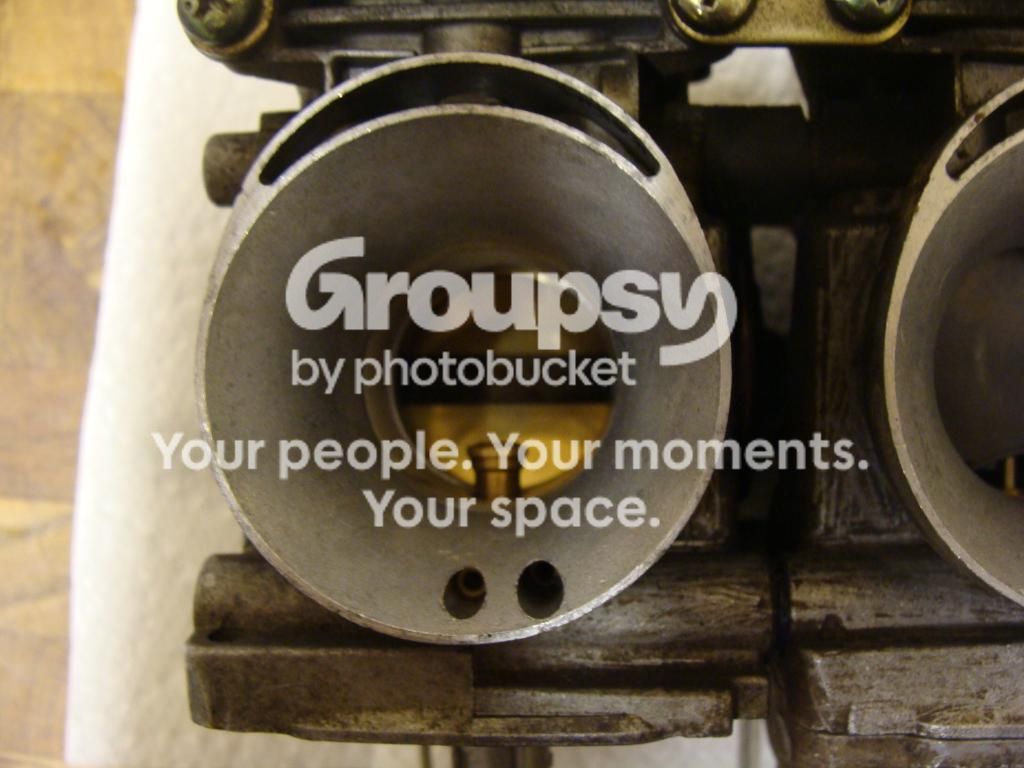

Now whip the main jet out with a flat head screwdriver.
https://i1247.photobucket.com/albums/gg630/haroman6661/DSC05791.jpg
You should have all of this:
https://i1247.photobucket.com/albums/gg630/haroman6661/DSC05792.jpg
Now to get the emulsifier tubes out, stick something that fits in the hole (I used a phillips screwdriver). Don't use anything that might severely damage the tube.
Give it a wee knock with a hammer and it should move through.
https://i1247.photobucket.com/albums/gg630/haroman6661/DSC05793.jpg
https://i1247.photobucket.com/albums/gg630/haroman6661/DSC05794.jpg
This is the emulsifier tube, which I cleaned by poking a bit of very thin wire through the holes. Also gave it a blow (No innuendo's please!). A bit of carb cleaner wouldn't go amiss either.
https://i1247.photobucket.com/albums/gg630/haroman6661/DSC05795.jpg
So, the underside of the carb should resemble something like this:
https://i1247.photobucket.com/albums/gg630/haroman6661/DSC05796.jpg
Make sure it's all clean and there's no bits of shite stuck in the jet or any key parts.
