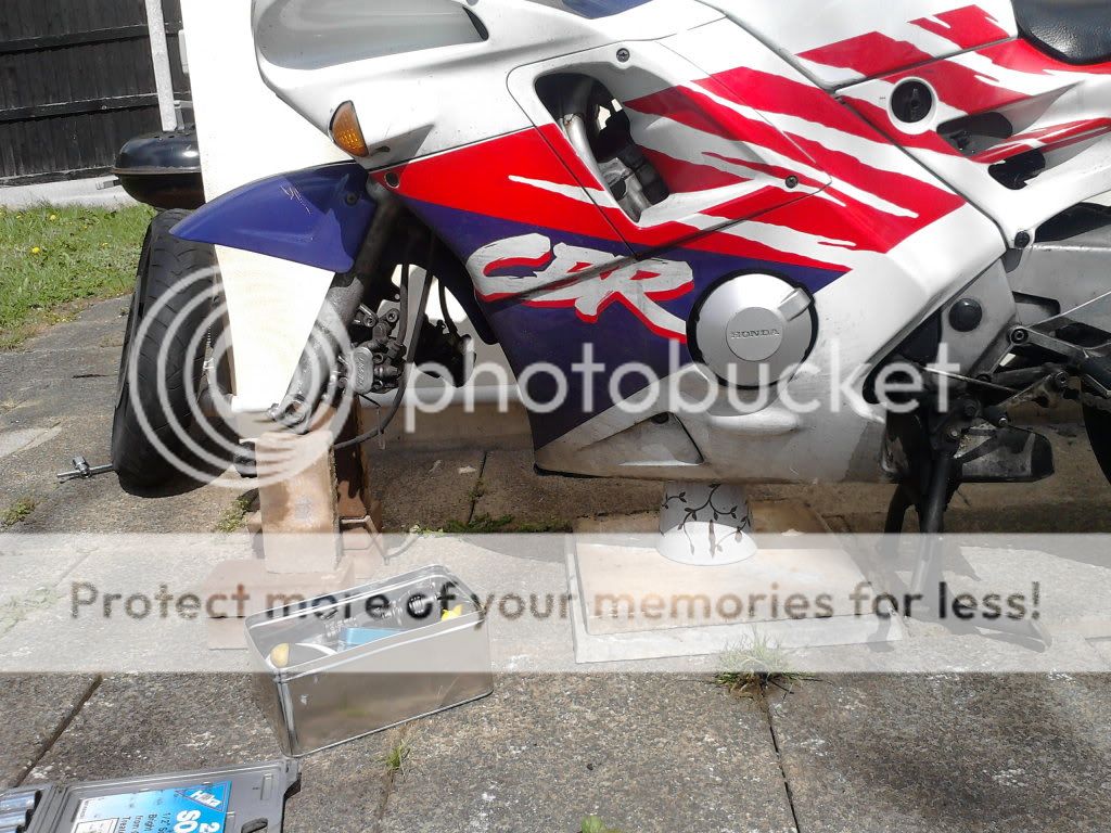

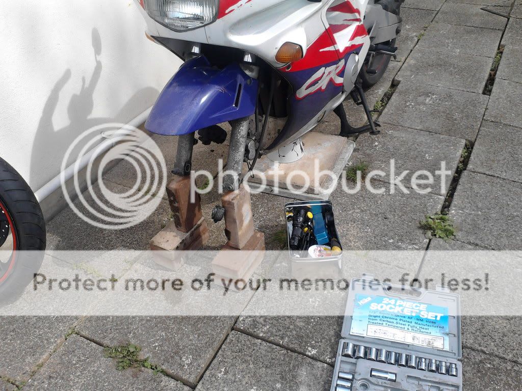

I spent the whole of this morning getting quoted ridiculous prices to fit a tyre to a wheel, eventually I found somewhere that would do it for a tenner if the wheel was loose, however I had a complete brain fart and forgot that the centre stand raises the back wheel not the front so I did this:
https://i235.photobucket.com/albums/ee81/paddy2007dug/P190412_1219_01.jpg
https://i235.photobucket.com/albums/ee81/paddy2007dug/P190412_1219.jpg
Which at the time I didn't worry too much about. Only now the bike place has said it will take a few hours to get the tyre done and it's looking pretty windy and stormy outside. Suddenly my wobbly bodge job doesn't seem like such a fantastic idea! I should point out that no weight goes through the plant pot, it is all balanced on the bricks.
Do I get stupid points?

Subframe will be twisted

You should have used something large and flat like a toolbox rather than balancing it on the narrow end of some wobbly things...
c_dug
PostPosted: 13:06 - 20 Apr 2012    Post subject: Reply with quote
As it goes, that little metal tin is my tool box and I did try. It wasn't bowed in the middle before!

could you not have put some weight on the back of the bike, that'd lift the front, maybe you'd need to strap it or soemthing, but that would lift the front.
Rather than a gust of wind wobbling the bike and down it goes from teetering on some bricks.
Good luck, hopefully it'll hold, its quite windy recently too!

Bricks and slabs under the headers would have been better.
I like your gypo style though. Thumbs Up Razz

Those bricks are so gonna fall over.
I did the same thing taking my front wheel off after the crash, then the bike fell on it's side when I turned my back and now i've got to buy a new tank too. Fantastic.
And my bricks were stacked horizontally 2x2 rather than precariously balanced like those Sick

It does look mere seconds away from disaster, any chance you could get the rear wheel weighted down as backup?
c_dug
PostPosted: 13:34 - 20 Apr 2012    Post subject: Reply with quote
Just not sure what to use, also I don't want to add enough weight to make it unstable without adding so much as to bring the back wheel down entirely as I can't help thinking that middle zone will be a bit of a disaster area.
I have a big bucket I could fill with water and plonk on the pillion seat but I don't think it would be heavy enough.

It'll be fine. Next time though, put the spindle back through the forks, if one brick goes the forks will try to settle to different heights and might crack the mudguard. Or just take the mudguard off.

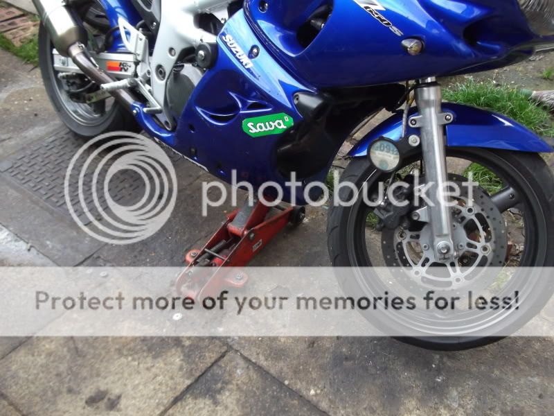

i just put my bikes on there side stands the jack up near front that way theres 3 points of contact and is very stable always done it this way never had a problem yet

I'll give you a clue, there's 2 slabs under your bike Laughing
