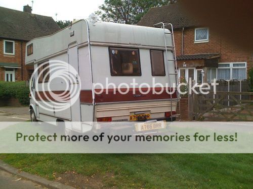

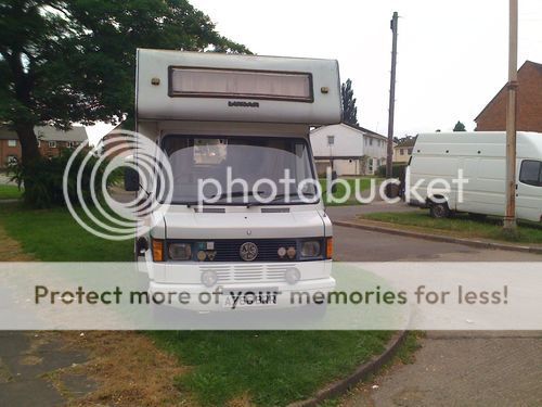

the van is based on a 1984 207d with the legendary om616 2.4l diesel motor,
its only got 59000miles on the clock and the cab and chassis is rust free,
https://i58.photobucket.com/albums/g257/hmmmnz/merc207d%20camper/camper1.jpg
https://i58.photobucket.com/albums/g257/hmmmnz/merc207d%20camper/camper2.jpg
https://i58.photobucket.com/albums/g257/hmmmnz/merc207d%20camper/camper3.jpg

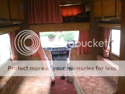

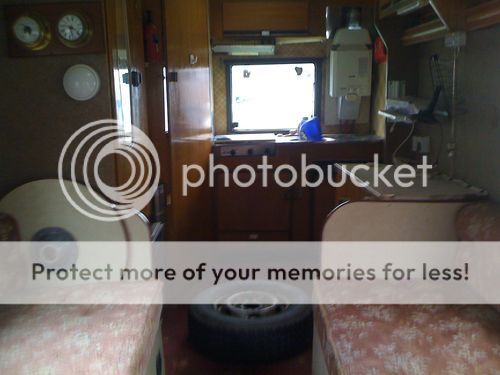

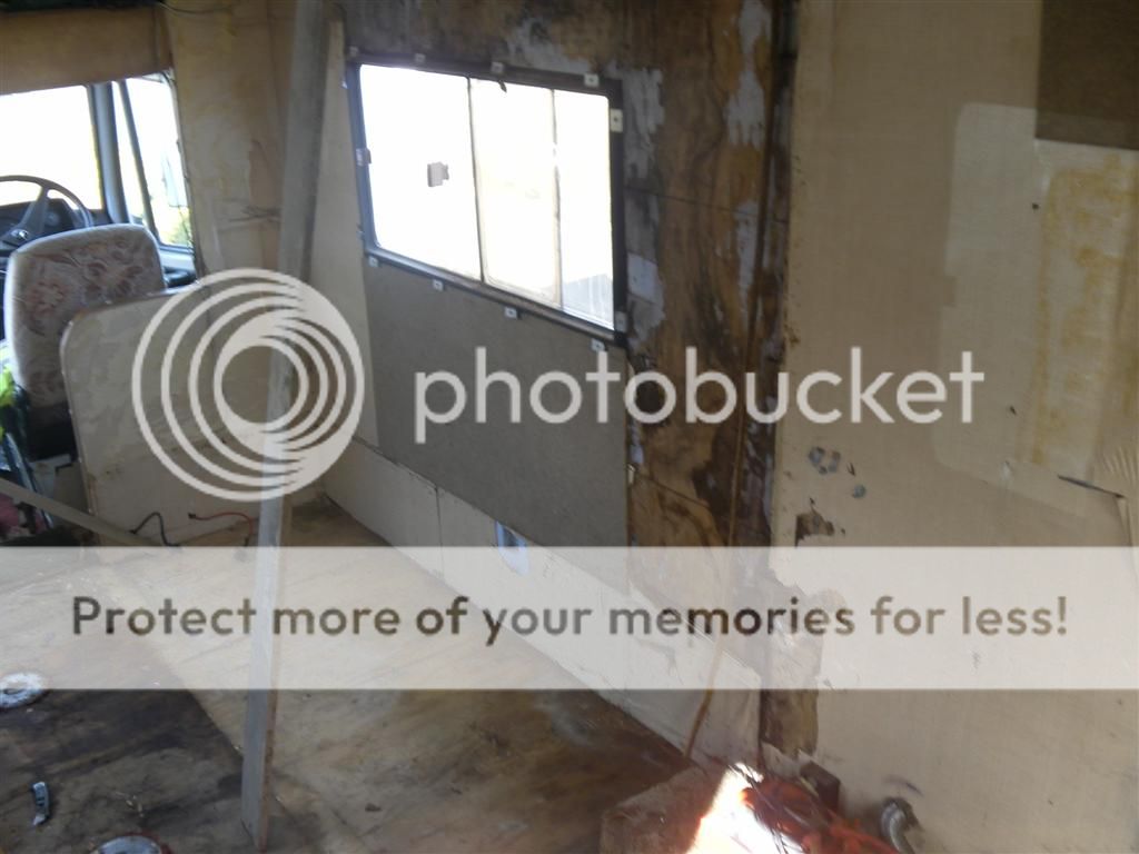

the inside of the cab
https://i58.photobucket.com/albums/g257/hmmmnz/merc207d%20camper/camper5.jpg

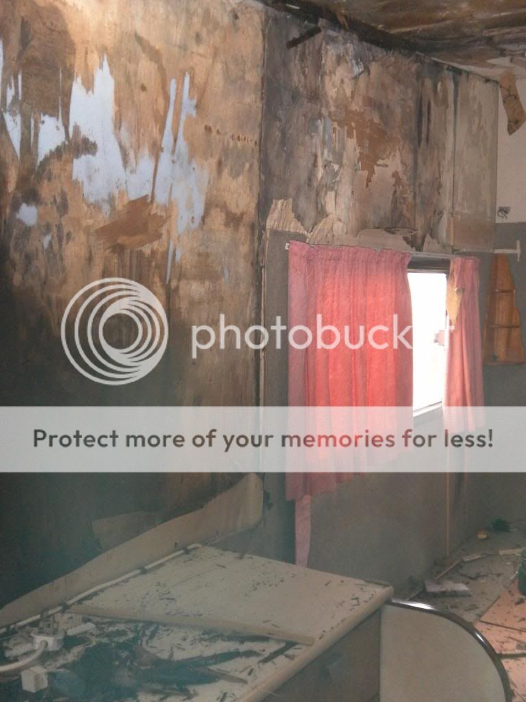

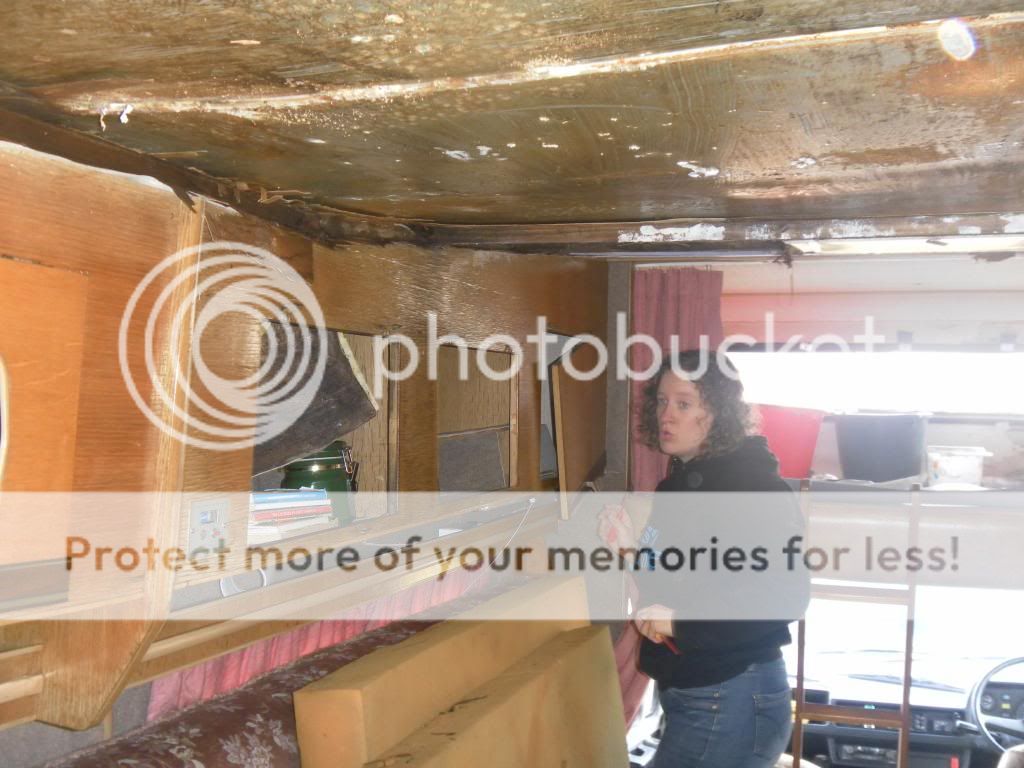

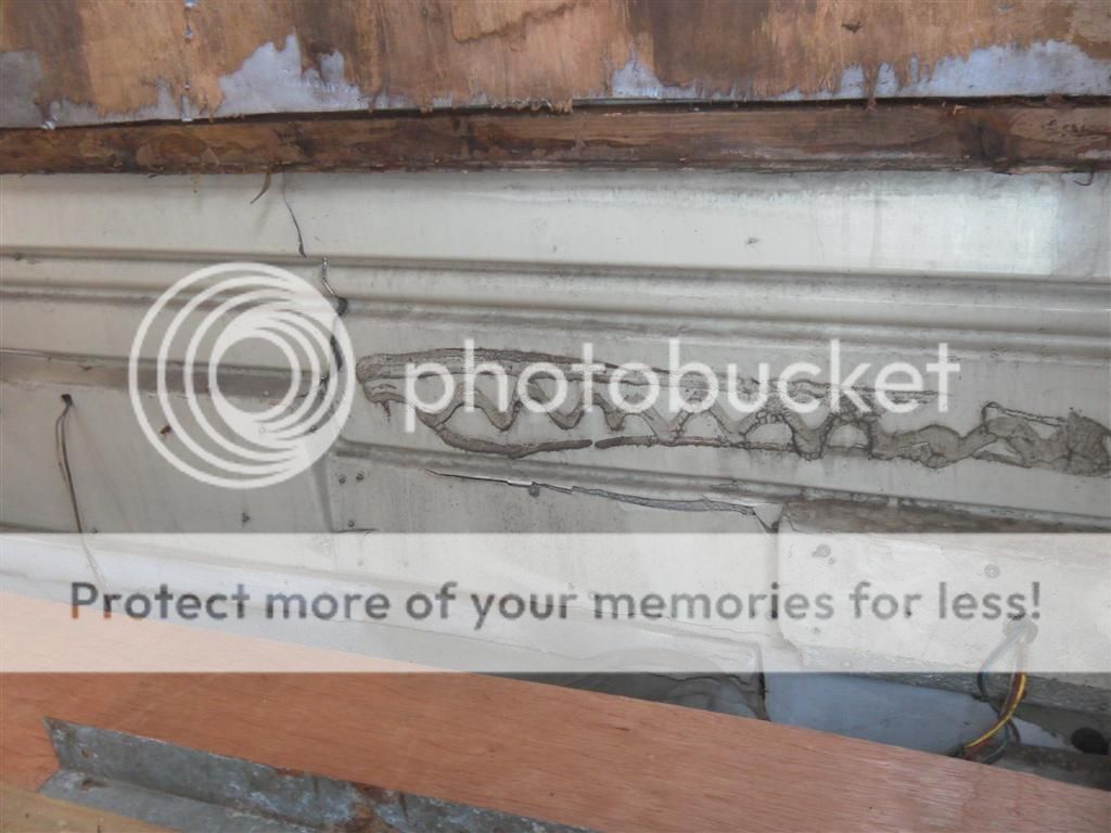

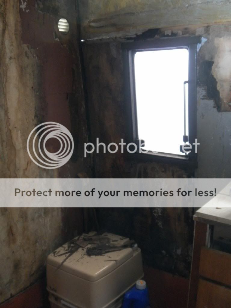

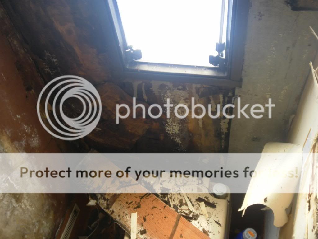

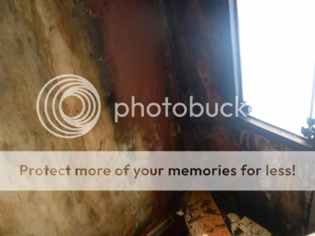

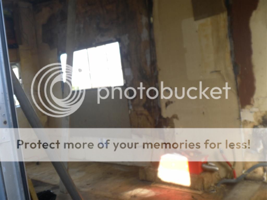

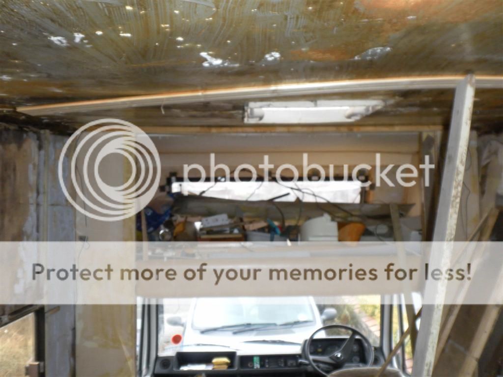

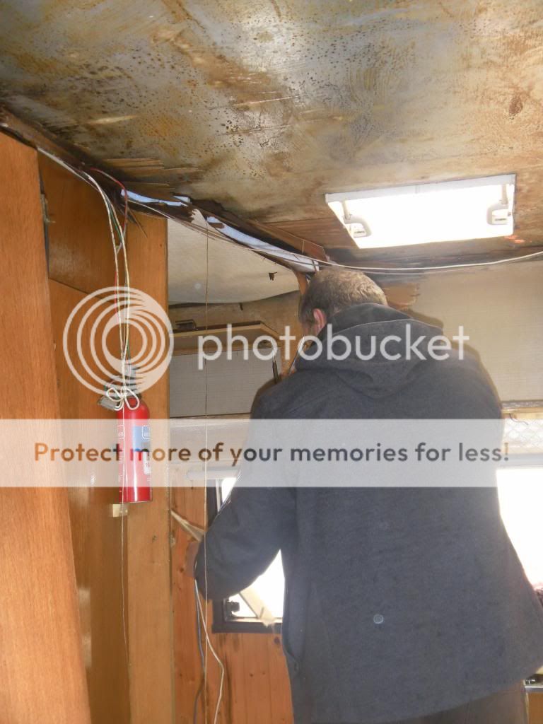

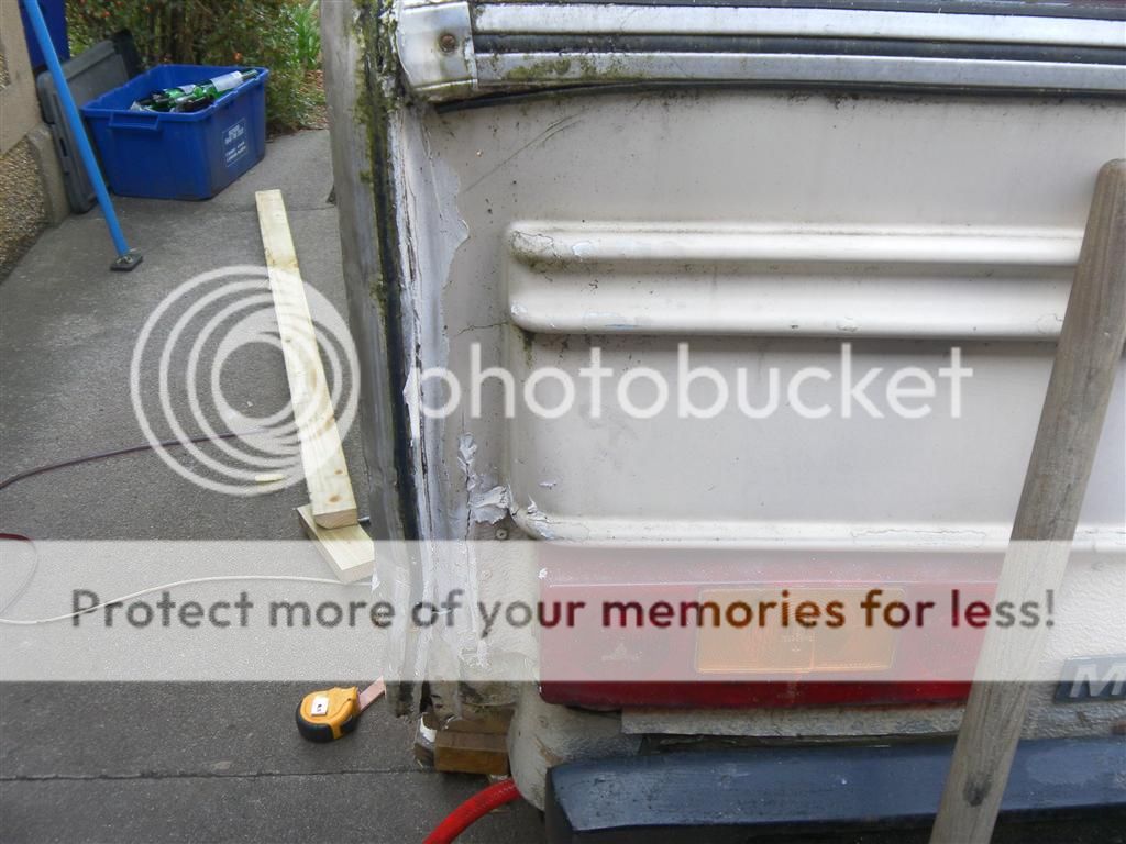

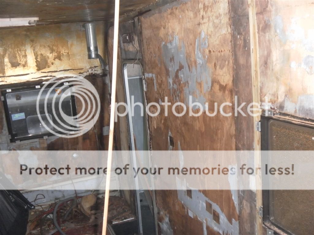

doesnt look too bad you say.... bollocks,
there has been a leak in one of the skylights and the windows have leaked,
so all the roof timbers were completely rotten, and all the thin ply (3mm) on both sides of the roof timber, and most of the ply on the walls as well,
so the strip down begins,
https://i58.photobucket.com/albums/g257/hmmmnz/merc207d%20camper/SAM_1158_zps3c4c2030.jpg
https://i58.photobucket.com/albums/g257/hmmmnz/merc207d%20camper/SAM_1159_zps8e7c0e05.jpg
https://i58.photobucket.com/albums/g257/hmmmnz/merc207d%20camper/SAM_1160_zpsb322274a.jpg
https://i58.photobucket.com/albums/g257/hmmmnz/merc207d%20camper/SAM_1163_zpsf345c0a7.jpg
https://i58.photobucket.com/albums/g257/hmmmnz/merc207d%20camper/SAM_1164_zps224ad8de.jpg
https://i58.photobucket.com/albums/g257/hmmmnz/merc207d%20camper/SAM_1165_zps8c8ad2f7.jpg
https://i58.photobucket.com/albums/g257/hmmmnz/merc207d%20camper/SAM_1167_zpse4bfc5f3.jpg
https://i58.photobucket.com/albums/g257/hmmmnz/merc207d%20camper/SAM_1168_zps3e039569.jpg
https://i58.photobucket.com/albums/g257/hmmmnz/merc207d%20camper/SAM_1169_zps21f1459b.jpg
as you can see, its a full strip down,
plan is to replace the timbers in the roof with tanalised timbers, an actual frame on the walls (just insulation on the sides, whole roof is held up by a support on one side and the wardrobe on the other, and the pathetic 3mm ply on the walls) then 6mm ply over the whole lot,
full new electrical system, new bath room, new seating lay out, change to the kitchen set up, etc etc.

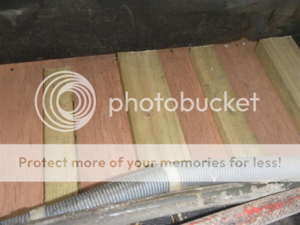

PostPosted: 07:49 - 18 Apr 2013    Post subject: Reply with quote

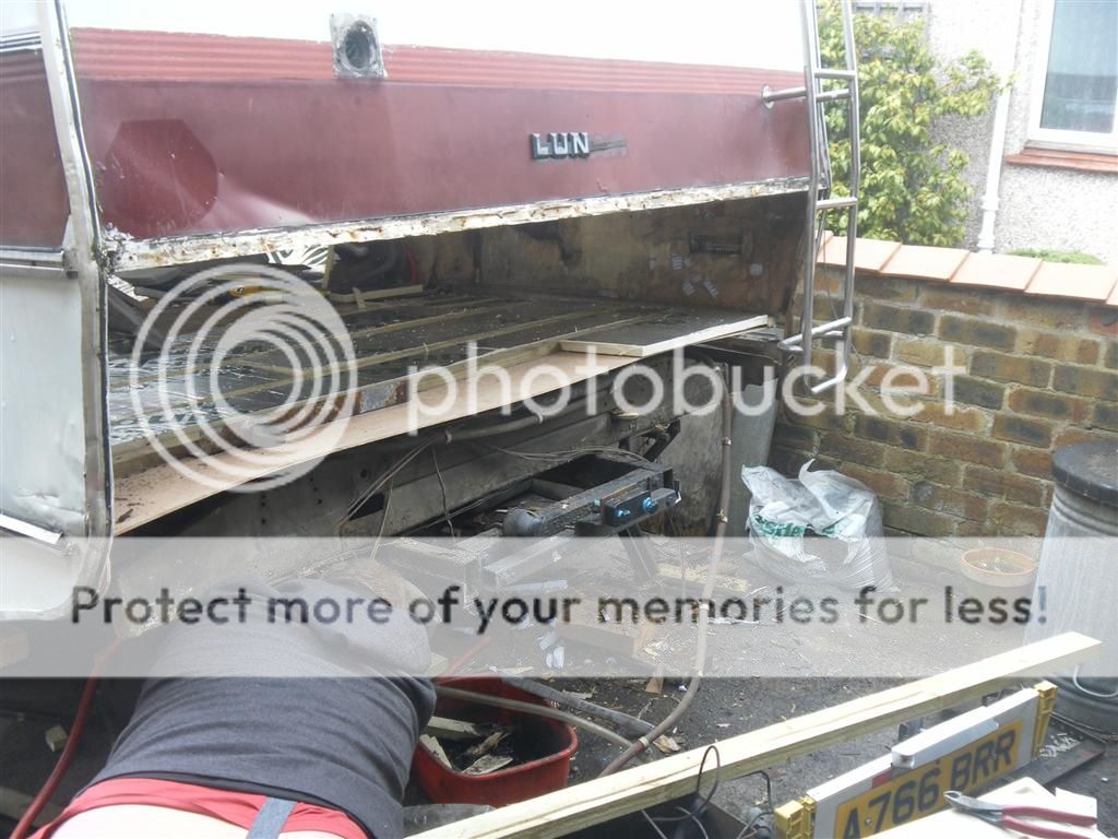

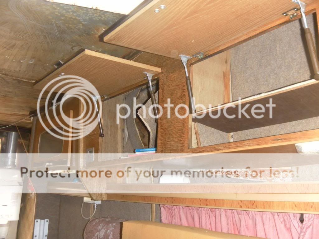

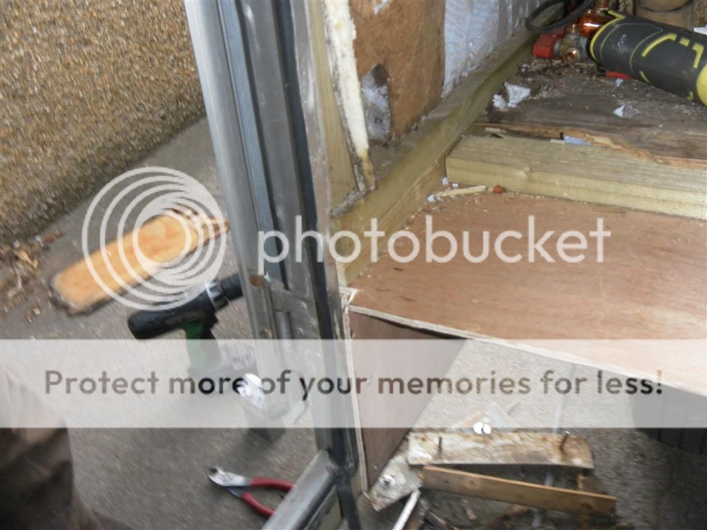

well the kitchen in the back is now out,
not much holding it together,
first of the new timber is down, ive used tanalised stuff,
so if it ever does get a leak in the future its not going to just rot away,
also decided to add some vertical timbers, im surprised its still upright,
the only thing that holds the whole thing up is the foam and the alloy outside skin,

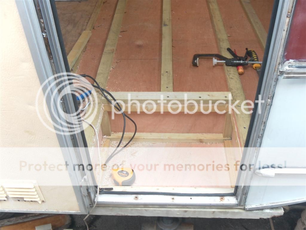

PostPosted: 19:12 - 18 Apr 2013    Post subject: Reply with quote

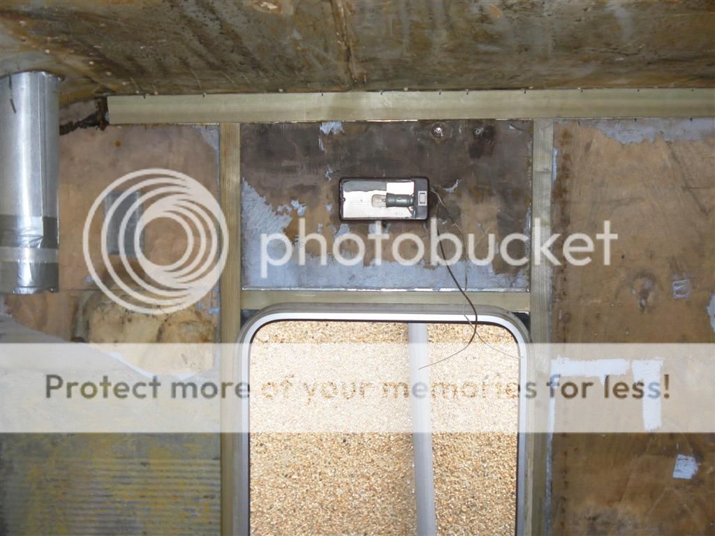

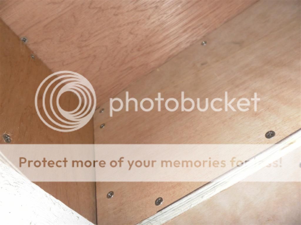

right todays efforts were finish the door framing,
https://i58.photobucket.com/albums/g257/hmmmnz/merc207d%20camper/SAM_1176Medium_zpsa6854293.jpg
empty the rest of the bath room area of its tray etc
https://i58.photobucket.com/albums/g257/hmmmnz/merc207d%20camper/SAM_1177Medium_zps13db7c5a.jpg
and start getting the top plate in on the door side

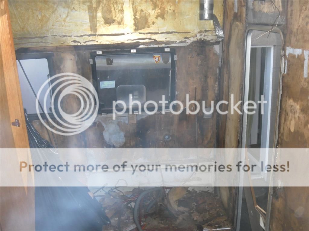

some sort of heating system in the bottom of the wardrobe
https://i58.photobucket.com/albums/g257/hmmmnz/merc207d%20camper/SAM_1179Medium_zpsd6423ca4.jpg

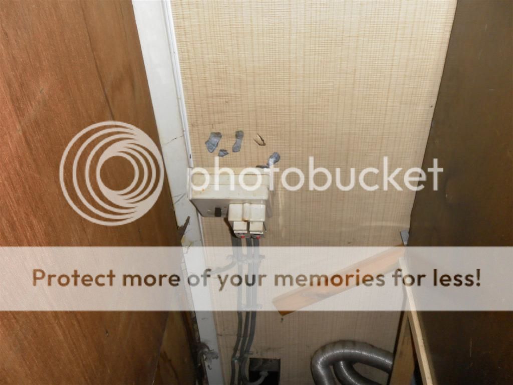

and some quality electrics....
https://i58.photobucket.com/albums/g257/hmmmnz/merc207d%20camper/SAM_1178Medium_zpsaf451a51.jpg

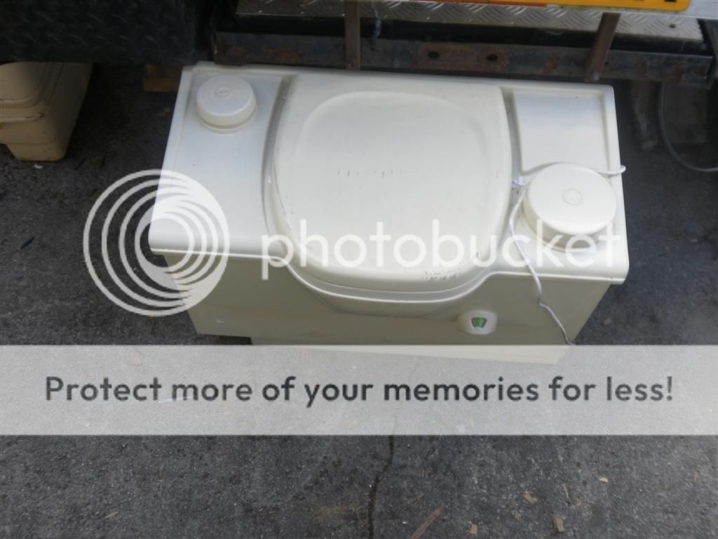

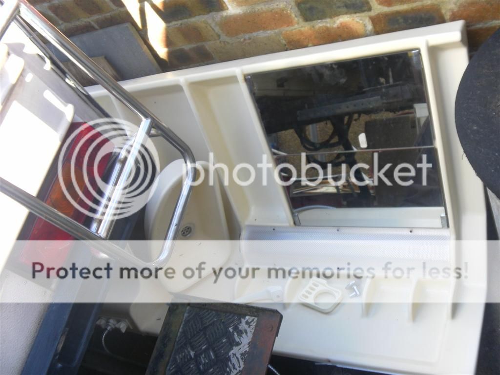

well today, i picked up the bath room... well half the bath room, still waiting on the shower tray to turn up,
but got the cassette toilet and the outside door for it
it'll live beside the van till im ready for the install Wink
https://i58.photobucket.com/albums/g257/hmmmnz/merc207d%20camper/SAM_1188Medium_zps2c681f00.jpg
no more porta potty for me

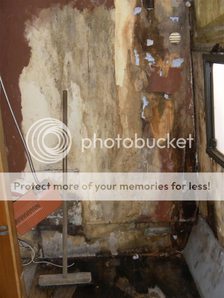

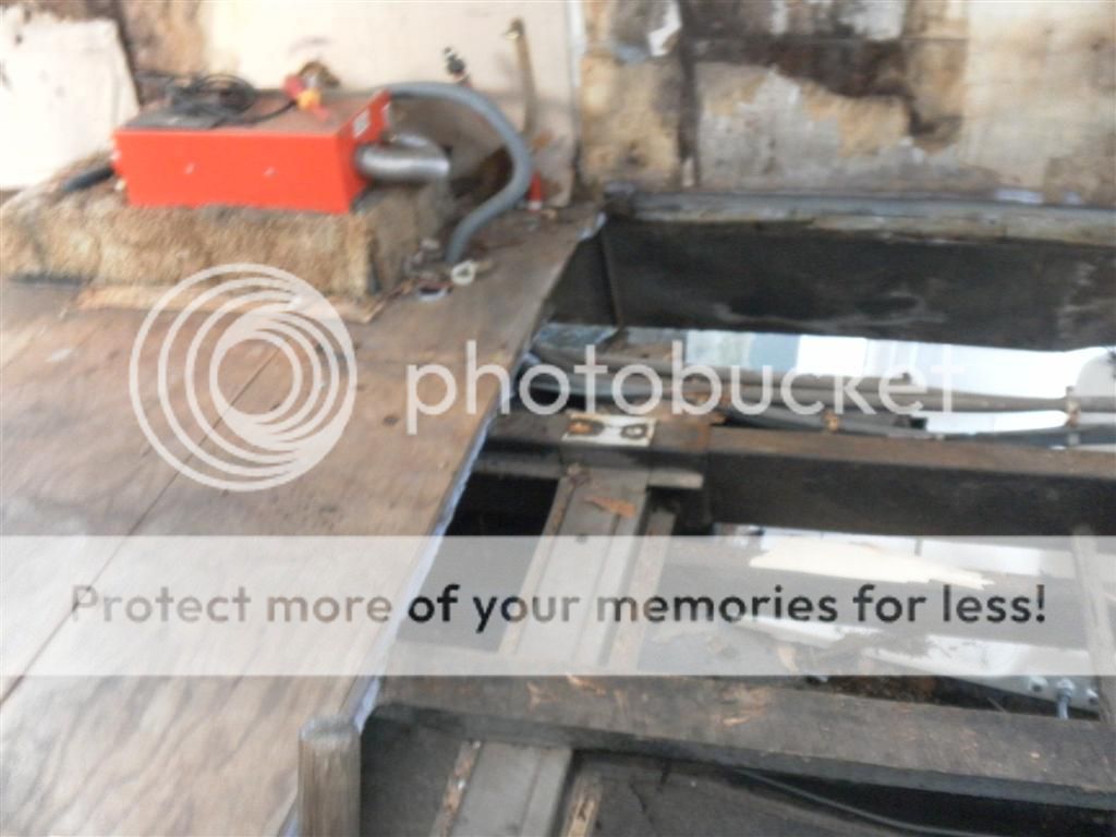

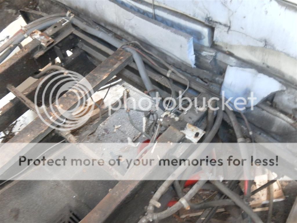

then i set about ripping out the wardrobe, remaining electrics and the bed/seating area
https://i58.photobucket.com/albums/g257/hmmmnz/merc207d%20camper/SAM_1190Medium_zps9feee417.jpg
https://i58.photobucket.com/albums/g257/hmmmnz/merc207d%20camper/SAM_1191Medium_zps45905311.jpg

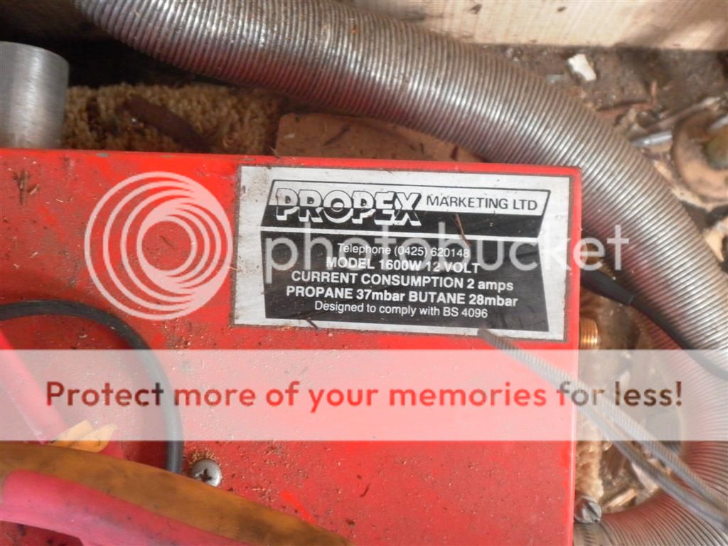

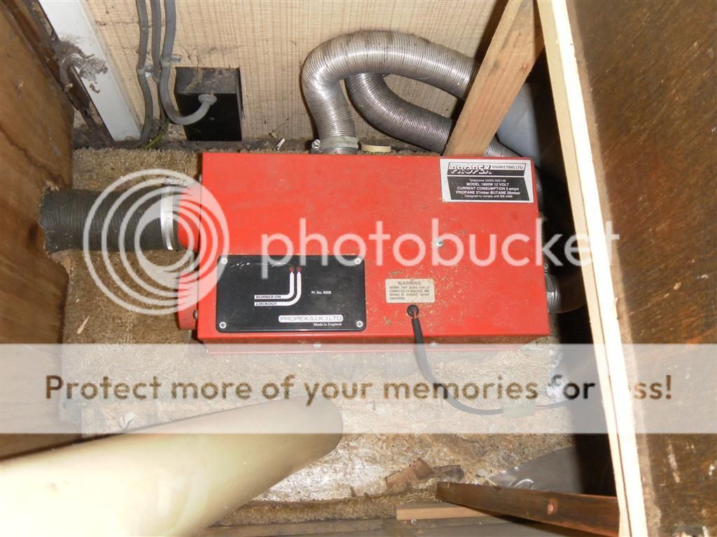

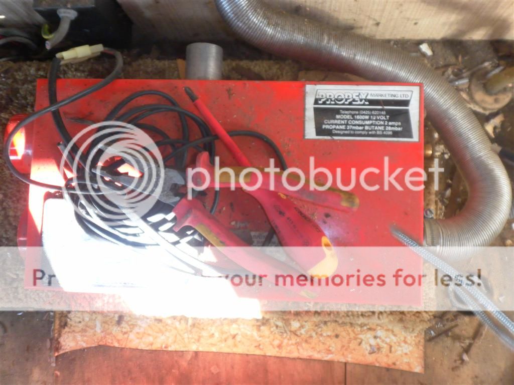

here is the internal air heating unit, apparently about 600 quid to buy new, so thats a bit of a bonus
https://i58.photobucket.com/albums/g257/hmmmnz/merc207d%20camper/SAM_1192Medium_zps4e0c7984.jpg
https://i58.photobucket.com/albums/g257/hmmmnz/merc207d%20camper/SAM_1194Medium_zpsf3b227f1.jpg

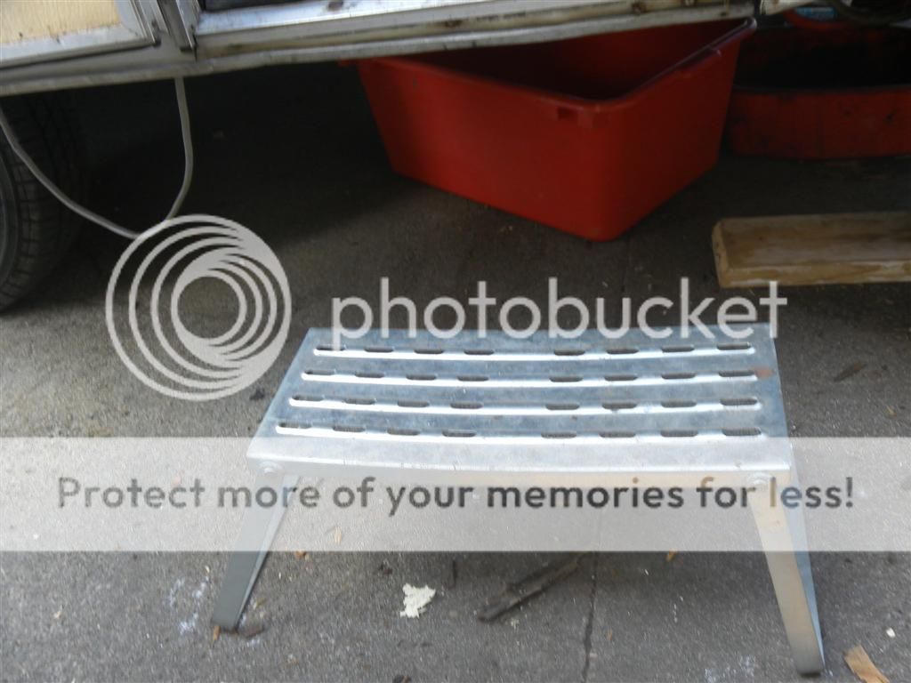

ooo and bought a set of fold away steps/step
https://i58.photobucket.com/albums/g257/hmmmnz/merc207d%20camper/SAM_1195Medium_zpscc662b7d.jpg

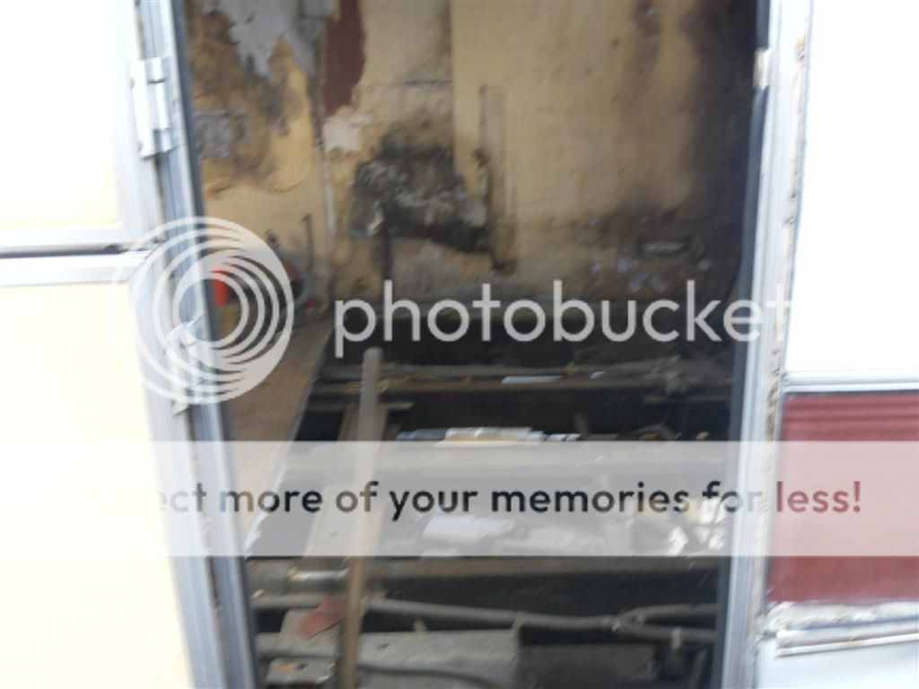

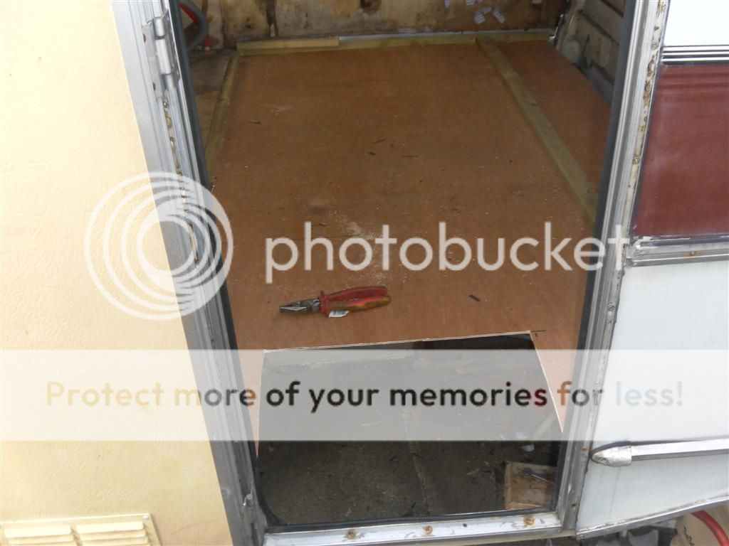

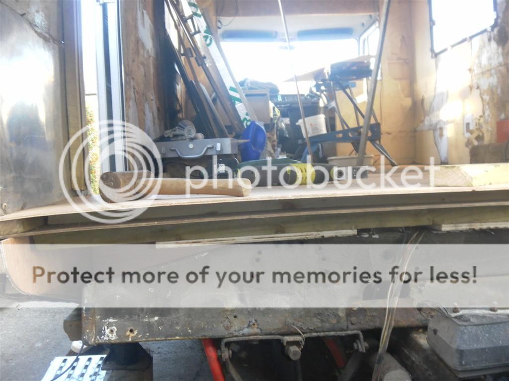

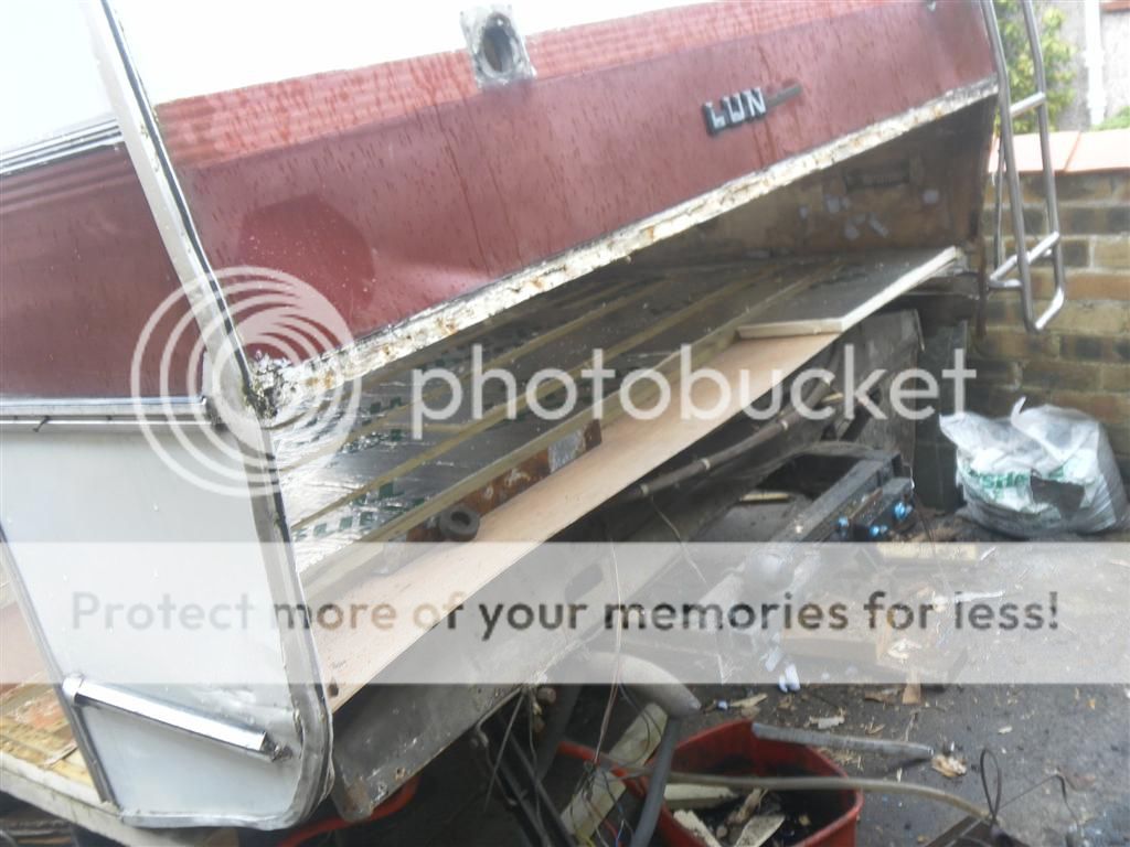

PostPosted: 17:37 - 21 Apr 2013    Post subject: Reply with quote
today i dub. "1 step forwad and 3 steps back day"

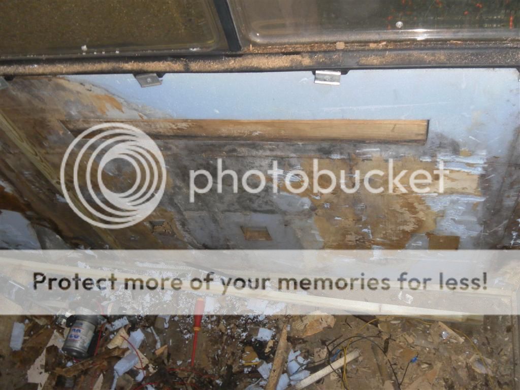

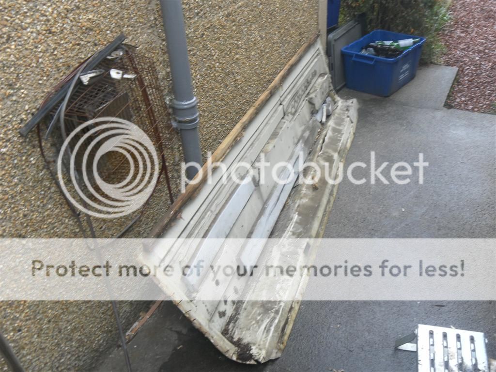

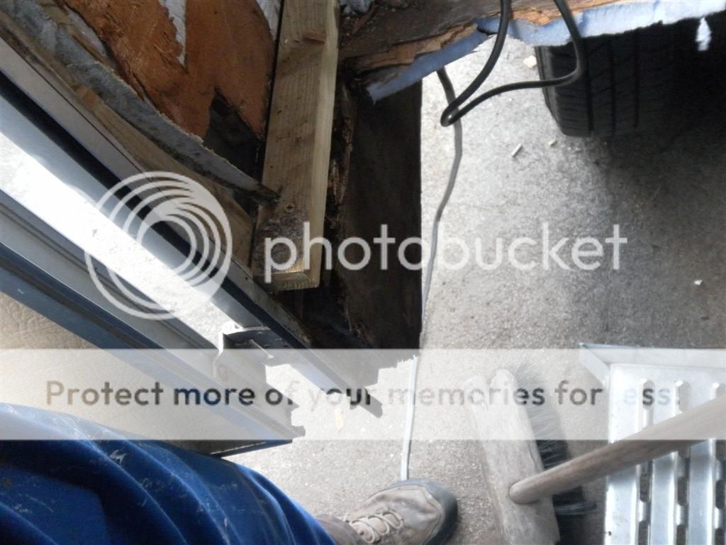

arghhh, well not much happening, found more rot in the floor, bugger, i was tempted just to cover over it,
but my better nature got the best of me, so up came the rear part of the floor,
https://i58.photobucket.com/albums/g257/hmmmnz/merc207d%20camper/SAM_1197Medium_zps9f0528a3.jpg
https://i58.photobucket.com/albums/g257/hmmmnz/merc207d%20camper/SAM_1198Medium_zps728bb4f9.jpg
https://i58.photobucket.com/albums/g257/hmmmnz/merc207d%20camper/SAM_1199Medium_zps42604b8d.jpg
https://i58.photobucket.com/albums/g257/hmmmnz/merc207d%20camper/SAM_1200Medium_zpsdd7c630c.jpg
as you can see im just making more and more work for myself, Sad oh well its the way it has to be,
even my camera was disapointed and took blurry photos in sympathy Wink

well id lie t say ive been really productive... but that would be lying,
how ever some progress has been made
i laid down the first layer of ply
https://i58.photobucket.com/albums/g257/hmmmnz/merc207d%20camper/SAM_1203Medium_zps60d0ecc5.jpg
and started putting the internal frame in pace
https://i58.photobucket.com/albums/g257/hmmmnz/merc207d%20camper/SAM_1204Medium_zpsb94439be.jpg
and made and installed what will be the step
https://i58.photobucket.com/albums/g257/hmmmnz/merc207d%20camper/SAM_1205Medium_zps7e50c61a.jpg
https://i58.photobucket.com/albums/g257/hmmmnz/merc207d%20camper/SAM_1207Medium_zps1ece3aa4.jpg
https://i58.photobucket.com/albums/g257/hmmmnz/merc207d%20camper/SAM_1206Medium_zps13d576ca.jpg
the design of the camper in reguardsto the floors is shite, they never even ran timber or steel from the chassis, so when the floor rotted out the whole body of the van dropped as well, about a inch and a half, which was shit, i had to jack the whole body up around the chassis and add a whole lot more timber to hold it there,
any way from underneath
https://i58.photobucket.com/albums/g257/hmmmnz/merc207d%20camper/SAM_1208Medium_zps35fbc83f.jpg
next job before i put the top layer of ply and floor insulation down is :
rip of the completly fucked rear fibre glass part of the van,
https://i58.photobucket.com/albums/g257/hmmmnz/merc207d%20camper/SAM_1209Medium_zps7e58def0.jpg
https://i58.photobucket.com/albums/g257/hmmmnz/merc207d%20camper/SAM_1210Medium_zpsd984429f.jpg
https://i58.photobucket.com/albums/g257/hmmmnz/merc207d%20camper/SAM_1211Medium_zpse7b437f9.jpg
ill make/get made a new panel to replace that section made from sheet alloy and bent to suit

well today was spent ripping out the fucked rear fibre glass panel, reinforcing the floor at the rear, and filling the floor with insulation and then popping the top layer of the floor down,
https://i58.photobucket.com/albums/g257/hmmmnz/SAM_1218Medium_zpsb78ec126.jpg
panel
https://i58.photobucket.com/albums/g257/hmmmnz/SAM_1219Medium_zpsf192cacd.jpg
most of the insulation down and me measuring for the floor reinforcments
https://i58.photobucket.com/albums/g257/hmmmnz/SAM_1220Medium_zps3da3f044.jpg
floor down and re-inforcements in
https://i58.photobucket.com/albums/g257/hmmmnz/SAM_1221Medium_zps3693e403.jpg
