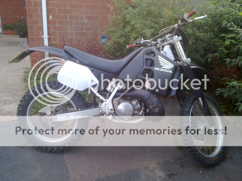

I was bored this morning so I was browsing Gumtree and spotted this piece of 2 stroke, greenlane goodness...
https://i32.photobucket.com/albums/d9/T0mmy200sx/IMG_20120429_135555.jpg
...Which is now sat in my garden Cool Managed to buy it quick enough that my brain didn't have time to engage and ruin my fun.
It was cheap and I'm expecting a few issues so I'm tinkering with it now to check it's ok then I may take it down some greenlanes this afternoon. Not too bad so far...
    No exhaust gasket between the block and the downpipe
    Oil leaking from gearbox breather which hopefully is just an overfilled box
    Rear wheel bearings shot
    Runs a bit lumpy at low revs but very clean higher up
And that's about it. Does need some better tyres though...those will be crap on road AND off road I reckon Laughing Probably get some supermoto wheels for it at some point Cool

another one Very Happy
mine was slightly overfilled and dripping out of the overflow when hot, just whip out the little bolt untill it stops flowing out and you done Thumbs Up
wheel bearing wear out super fast for some reason too !!!
iv got a copy of lt's manual here, if you want me to scan it for you let me know Smile

PostPosted: 16:46 - 29 Apr 2012    Post subject: Reply with quote
those tyres are hopeless - iv got the same on mine Laughing
as for the slow running, its common on these for the pilot jet to clog up to the extent that they recommend replacement....... but then i guess they would if they have boxes of em to shift Laughing
swingarm spindle is the big problem, see if yours will come out and if it does get some grease in there quick Wink

Yes I didn't pay anywhere near that Wink Was quite surprised he accepted my offer, however...
I can't get it started Laughing
I rode it home no problem then left it sat for a coupe of hours. I was going to head out on it so I got it going and it was ticking over whilst I was opening my gate then in died. Couldn't get it going again so I took the plug out that was soaked in petrol and cleaned it up...still wouldn't go Rolling Eyes
Not too fussed as I'm expecting to have to do a fair bit of work to it and half the reason I bought it was to tinker with it although I had hoped to at least ride it more than once before stripping it down Laughing
I suspect this may be a problem of me not having owned a 2 stroke in over a decade and not having the knack of starting it...any ideas?

new plug fella, mine did the same 2 days after buying it Laughing

Well I'll get another plug anyway if only because I need a spare on the bike. From my limited experience of kick starts and knackered old greenlaners I strongly suspect this will be a question of technique in terms of what to do with the throttle...my old XT was a bugger to start for the first few weeks until I worked out what it liked.

dunno bout yours bud but mines 2 kicks from cold, choke on, no throttle,
1st kick when warm, again no throttle but it doesnt mind if you do give it a bit of gas either......... aint hondas nice an easy Laughing

Still can't get it going by the way, try a new plug tomorrow. Bit of a pisser as we have a break in the rain Rolling Eyes On the plus side the oil leak was indeed just an overfilled gearbox and the swingarm bearings are definitely ok.

https://i150.photobucket.com/albums/s95/boundy69/Motorbikes/28082009045-1.jpg
This was my old one, check your kill switch if your having problems starting.
Send me your Email addresss and I'll send you a little CRM info file I made, its also got the full micro fiche for Mk2.2, the parts guy at my local Honda dealer found it on the system, printed every page off and I scanned it in at work. I found that most parts are still avalible from Honda and are cheaper than some of the pattern parts, so always check.
I blew mine up and stripped it for parts so know my way round it.

Got her going today after sticking in a new plug and did a little bit of exploratory green laning.
Runs well on the throttle but jerks along horrendously if you shut it...

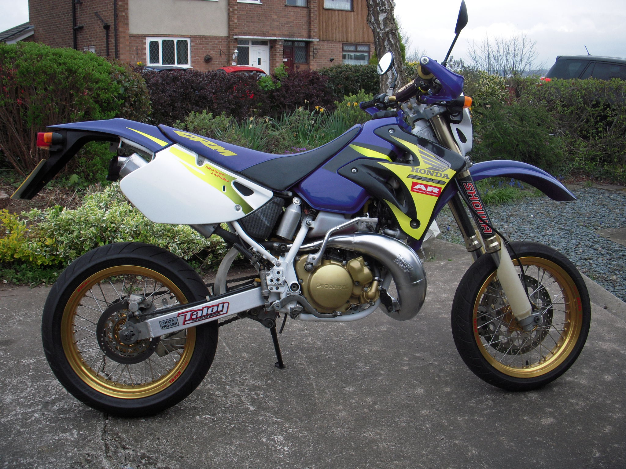

funnily enough i know the odd thing about them - and someone has already mentioned my site crm250.com
balancer shafts can fail, kill switch and side stand contacts, forks rot, too much gear oil they blow it out the back of the engine,
keep the gear oil changed often
cranks can go for over 30k before failure
top ends around 20 - 25k depending on use / abuse.
swingarm pivot bolts seize solid - like proper seize and need cutting out.
the Mk2 and Mk3 are quite capable of around 100mph on the road with the right gearing. the Mk2 looks a bit dated but is very capable.
Mk3 looks more modern but come in some lairy paint schemes.
The AR is the most complicated and the final edition of the CRM and most desirable by many.
I used my AR at oulton park the other week on track - surprised alot of bikes. Granted top speed was a bit limited, but as the superbikes roared past they were on the brakes sat up as you sail past again still on the power and ride around the outside smiling lol.

not being funny but the Mk2 just doesnt look right or anything like as smart as the AR with motard wheels.
XR400 wheels fit too, but a set like mine even second hand will be around 4 - 600 quid, then you need the big disk conversion etc etc
it does turn them into a proper road weapon though

yep thats a way to do it, buy some spares fit road tyres and happy days, or get some new wider rims laced to the old hubs.
ideal sizes are as follows
front - 3" rim and a 110/70/17 or with some trimming a
3.5" rim and a 120/60 or 70/17
( i am running a 120/60/17 BT090 as i have them on all the 400's and 250's too)
Rear - 5" rim and a 150/55/17 will easily fit and not cause too many clearance issues.
the 160 is too much
