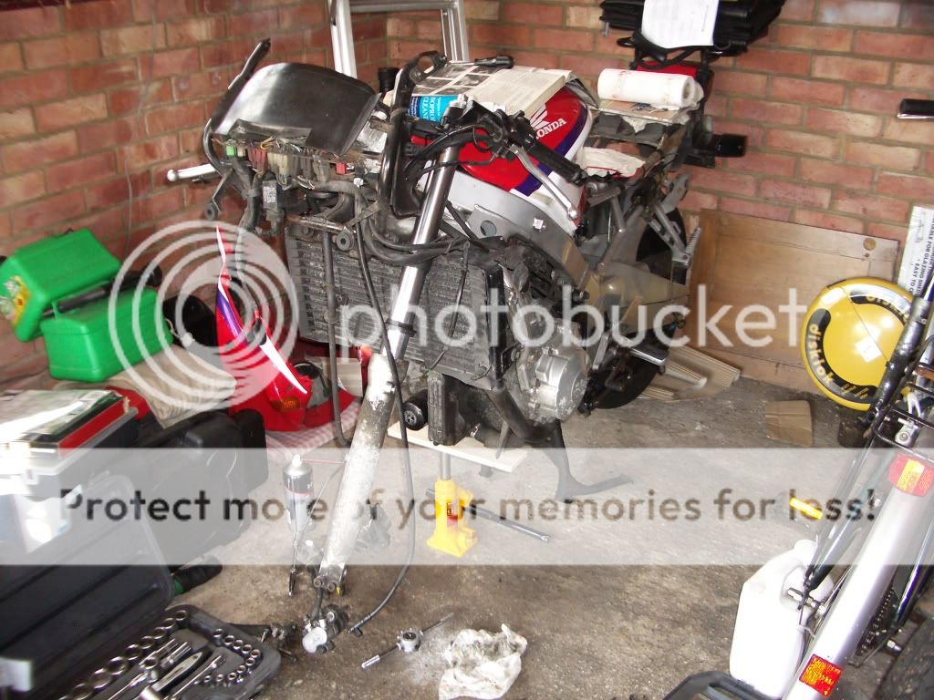

This was my 1994 CBR600FR, roughly equivalent to an F2.
https://i221.photobucket.com/albums/dd227/serendipity_uk/CBR600FR/IMGP7460.jpg
Heavy tool case on the rear rack and a small bottle jack under the sump for safety. Once the wheel and forks are out the balance is way over the back anyway. Plenty of clearance to slide the forks in and out.
I didn’t buy a seal driver, but used a piece of plastic tubing. I wish I had purchased the seal driver so that’s not a bad idea.
My biggest problem was getting the old seal out of one of the forks, but it was pretty corroded. Yours may not be so bad.
Got them done in the end, but it was a significant amount of effort.
