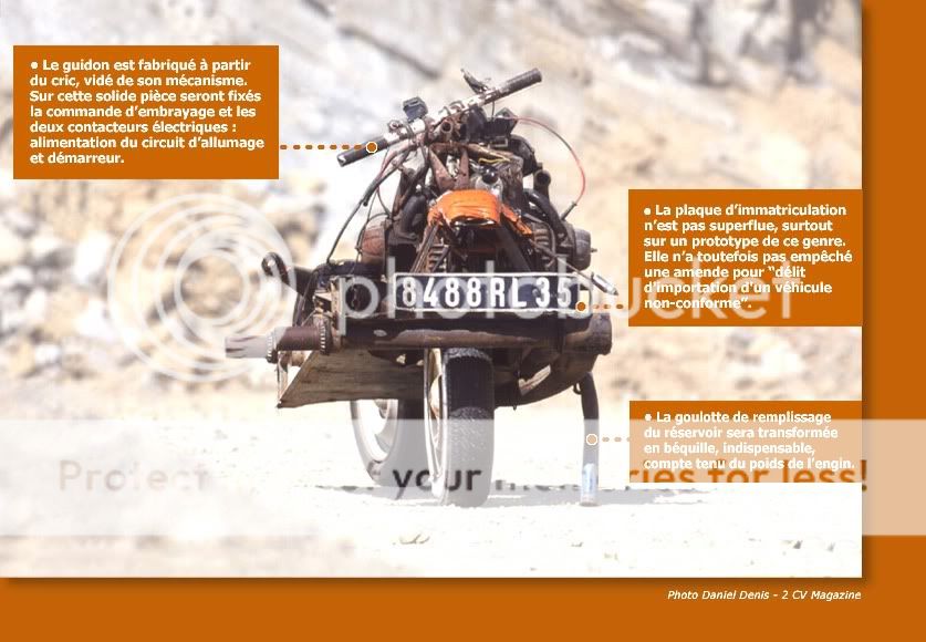

Have a read of this, how plausible do you think it really could be?
I think this is probably a dramatization. “Based on a true story”, so to speak.
Probably when he developed problems with his suspension he decided to frivolously pursue a mod to his vehicle. I don’t think he did so without the support of civilization.
and 12 days with limited water?!
I guess the part I really don’t like, is how he supposedly did this all with a hacksaw. I’d think he’d need a hundred blades, and his arms would fall off after having to cut all that, as if he could ever even cut a single hardened shaft with a hacksaw
anyway here you go copy and pasted:
The original story is in French and the Google translate is very rough. Please forgive us if we don’t get this completely accurate.
While traveling through the desert somewhere in north west Africa in his Citroen 2CV , [Emile] is stopped, and told not to go any further due to some military conflicts in the area. Not wanting to actually listen to this advice, he decides to loop around, through the desert, to circumvent this roadblock.
After a while of treading off the beaten path, [Emile] manages to snap a swing arm on his vehicle, leaving him stranded. He decided that the best course of action was to disassemble his vehicle and construct a motorcycle from the parts. This feat would be impressive on its own, but remember, he’s still in the desert and un-prepared. If we’re reading this correctly, he managed to drill holes by bending metal and sawing at it, then un-bending it to be flat again.
It takes him twelve days to construct this thing. But there’s not just a swing arm that’s broken, there’s a frame beam broken too (not sure about the exact term, one of the 2 girder of the chassis).
He’s not far away but he has a lot of tools and other hardware that could be stolen if he leaves them unattended.
https://i249.photobucket.com/albums/gg211/froimv/Misc/Photomontagephotgend.jpg
https://i249.photobucket.com/albums/gg211/froimv/Misc/Photomontagemotocp.jpg
https://i249.photobucket.com/albums/gg211/froimv/Misc/Photomontagemotoav.jpg
https://i249.photobucket.com/albums/gg211/froimv/Misc/Photomontage2d.jpg
https://i249.photobucket.com/albums/gg211/froimv/Misc/Photomontage2c.jpg
https://i249.photobucket.com/albums/gg211/froimv/Misc/Photomontage2b.jpg
https://i249.photobucket.com/albums/gg211/froimv/Misc/Photmontagesite.jpg
Like i said, i think its bullshit, but wanted to see what you guys make of it, maybe someone can read french?

Sounds like complete shit, but the bike thing looks awesome! Very Happy

I may well be wrong, but...
I'm sure these cars are font wheel drive so how is he making the rear wheel spin, the gearbox output is obviously not getting to the front.
Maybe he's got the output running directly onto the rear tyre to make it turn but it doesn't look like it's being butchered so can't see it being done.

I was just thinking that.
No drive shafts and seems to be a standard rear wheel at the rear.
Says something about maximum 20kph.
Only possible thing I could think would be a friction drive - looks like there could be something on the left shaft exit, but it's not clear.

From a site I found on googe:
Informations from the pictures :
- The chassis was cut to keep only the central part. Front and back extensions were dismissed
- The direct transmission. The brake is at the top of the rear-wheel. Due to the transmission rotation you have to drive in rear-gear, maxing at 20km/h
- The saddle was made from the end of the rear bumper covered by the felt of the dashboard and held in place with orange duct tape
- The right-drum is blocked so that the differential distributes all the power to the left one
- The front wheel is the only one to have a suspension
- The handlebar is made from the main piece of the jack. On that are fixed the gears and electrics command
- The immatriculation plate is necessary but didn’t prevent a fine for non-conform vehicule importation
- The gas inlet pipe is used as kickstand
That makes sense as it seems to have in-board drum brakes.
The start of this video seems to have the same bike running:
https://www.youtube.com/watch?v=BiuHxf565kw
I still don't understand why he needed to do this because his tools and hardware might be stolen if left - why not spend a little time either repairing it and limping home or hiding it then walking back.
Now he'll have to leave his stuff for some time and have more trouble getting them back I suspect - can't just get someone to repair it so he can drive them back.

Fucking come off it Laughing Are you telling me he'd take the time to make a SIDESTAND, seat, and put the numberplate on before making his escape? Laughing
100% absolute tosh, that was done in a garage and moved there
