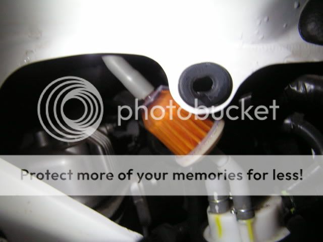

The problems are 2, the bad quality construction of the bike (the fuel tank have rust), and not having a fuel filter.
Me and my friends have bought some:
https://i102.photobucket.com/albums/m87/DanielMaiaD/PICT0088.jpg
