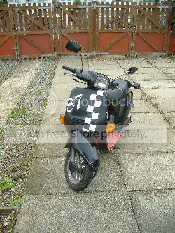

I had an old E plate NE50 years ago, always started on the first kick but was painfully slow. This was mine;
https://i16.photobucket.com/albums/b29/dungbug/DSCF1971.jpg
