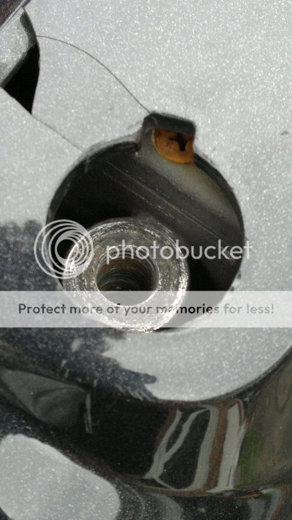

Technical term thingy.
Basically thread for mirror is buggered.
So need to rebore/clean and then hopefully reuse the original mirror.
Trouble is I can't remember the names of the stuff to do this.
Any advice appreciated.
Thanks.

It's a 'tap' you need - a 'die' would do the same if you had a male thread (stud, bolt, etc).
Depending on how far down the thread is knackered, it's possible you could need a 'bottoming tap', as normal ones are tapered for starting new threads, so won't cut right to the end if it's closed.

just make sure you use the right drill size if using a heli coil

Just to clarify I do know about taps (and dyes).
However, a workshop was trying to tell me about something they could screw into the original. I think this made the hole bigger so like a tap then. They would then screw something into this new rethreaded bit/hole so that you could then screw the original mirror back into (10mm mirror) this new bit.
I hope that makes sense.
It's the name of the bit that gets screwed back in I don't know about (I've led a sheltered life obviously).
So that'd be a helicoil then.

They are talking about Helicoils. I prefer to make my own insets by tapping out a grub-screw and loctiting that in. I have had helicoils pull out before now.
PostPosted: 21:08 - 17 Jun 2012    Post subject: Reply with quote
All the inserts you get will require first drilling out, then re-tapping for the bigger thread, then the insert being put in.
A lot of people like 'timeserts', which are similar to what Ariel describes he makes - as they are solid.
Either way, it can be worth using some kind of glue on the outer threads, so the insert is well held in.
For a mirror, just cleaning it up with a tap may well do it.

Sadly not. Tried that. Looks like I may be learning some new skills Very Happy

Remember, some mirror mounts have a reverse thread to stop them unscrewing when the wind blows on them.
Check this before you buy inserts.
Incidentally, I've found it cheaper to buy a bag of inserts, a drill and a seperate tap to go with them off ebay than it is to buy a kit containing them. Although it's not a bad idea to get a full kit the first time because it'll contain the inserting tool, tang breaker and instructions.

Fairies attack wrote:
The hole in the picture looks like it is blind, which means the bottom of it is capped off.
You will be lucky if have it drilled and helicoiled without having to go through the bottom.
You can try it, but I dare say it you will have to drill right through to get a decent thread when tapping it for the helicoil.
absolutely no reason why you can't helicoil a blind hole. done it hundreds of times Thumbs Up
Be careful not to drill and helicoil your knee.... Rolling Eyes

Good point made by stinkweed as my Yam has a lefthand thread on one of the mirrors. However having a close look at the photo, the thread does look to be righthanded.
Interesting about using helicoils, as I am going to need one in my sump drain plug
PostPosted: 09:04 - 18 Jun 2012    Post subject: Reply with quote
The helicoils aren't that deep, so may well not be an issue. I've used two in a row in the past when I've wanted a deeper thread.
It depends how deep the hole is. Sometimes even a #3 tap isn't blunt enough (in which case the tip can be ground off).

Would it be worth trying to thread the mirror up a bit further? Often the threads in the hole go deeper than they are used. you may only need to expose a few more turns of thread in the hole to get a good grip on things.
Also, for cleaning up threads like this, a cheaper (and quicker as you dont have to go out and find a tap) way is to make your own by slitting an undamaged bolt with a hacksaw and running it in and out. You wouldn't realistically be able to use this to tap a new thread, but it works well to clean up old/cross threaded holes.
Same can be done with a nut slit in one place and held tight with mole grips on male threaded sections.
There's 2 types of taps, one is called a machine tap (here in NL)
first 5mm are conical to catch the threads in the hole.
Then there is the 3 stage tap, 3 taps ,2 with stripes, one without. 1s stripe is tap one, 2 stripes tap 2 , no stripes tap 3 (they increase in thread width)
For blind holes use a machine tap.

https://upload.wikimedia.org/wikipedia/commons/f/fb/TapTypes.gif
this is how i always knew taps. not sure if it is current terminology, but i learned my trade from a bit of an old boy Very Happy
Almost right Groovylee
Should read, Taper, Second And Plug
