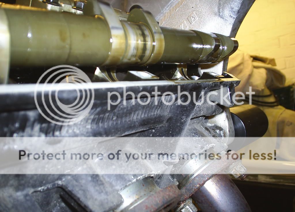

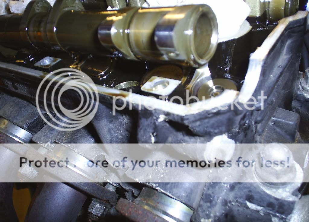

Is the cam chain drive in the centre of the cam or on one side?
The reason I ask is because with one you can virtually leave the cams connected to the cam chain,but with the other it is better to completely remove the cams.
https://i666.photobucket.com/albums/vv23/WiNot_Rhencullen/Workshop/Picture361.jpg
https://i666.photobucket.com/albums/vv23/WiNot_Rhencullen/Workshop/Picture366.jpg
But say the inlet valve clearances are okay,you can leave that one in situ and just deal with those clearances that need doing.
https://i1073.photobucket.com/albums/w384/Rhencullen5/Picture079.jpg
I had some thoughts when I first needed to do the shims on my Exup 1000.But with plenty of preperation and copious note taking,I was able to complete the work okay.The sound of the engine running once everything was rebuilt is better than my favourite music Wink Thumbs Up

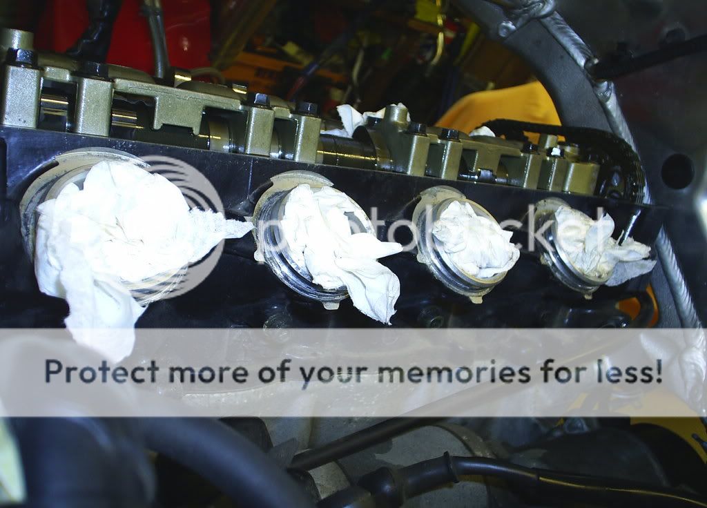

As well as using a piece of wire to prevent your cam chain disappearing into the guts, stuff every orifice with non-shedding cloth. Fishing a nut from the guts is not nearly as easy as preventing it getting there in the first place. Embarassed Wink
Fizzer Thou
Joined: 06 Aug 2011
PostPosted: 13:23 - 30 Jul 2015    Post subject: Reply with quote
Agree with Mentalboys comment.There is nothing worse than dropping a component down into an inaccessible place.So stuff holes with anything useful
https://i666.photobucket.com/albums/vv23/WiNot_Rhencullen/Workshop/Picture368.jpg
