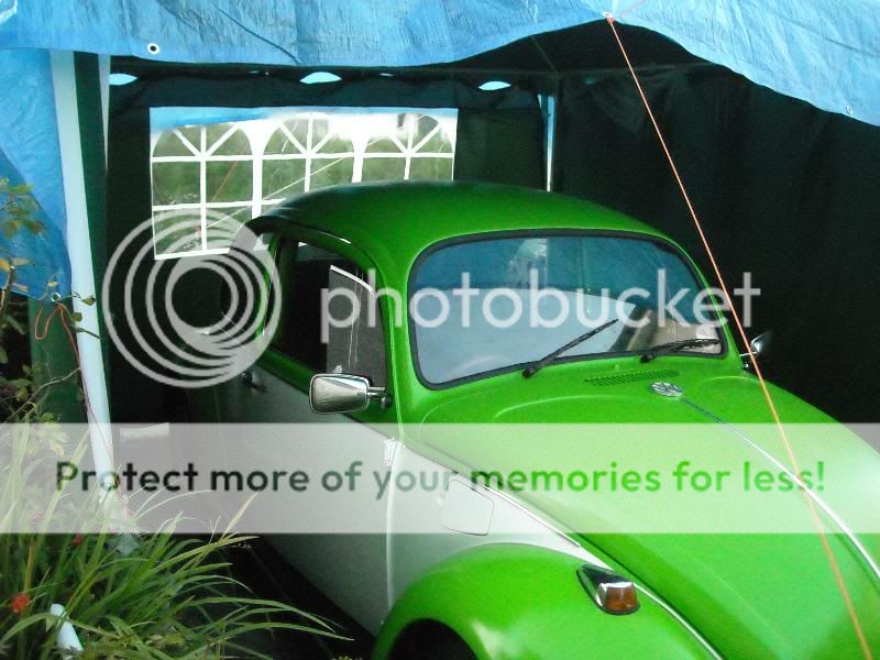

Gazebos are fucking awesome.... Stripped,sprayed and rebuilt my beetle under one....now i just rebuild bikes in the house Smile much warmer !
https://i127.photobucket.com/albums/p138/lilldic_mossy/Beetle%20madness/DSCN1052.jpg
