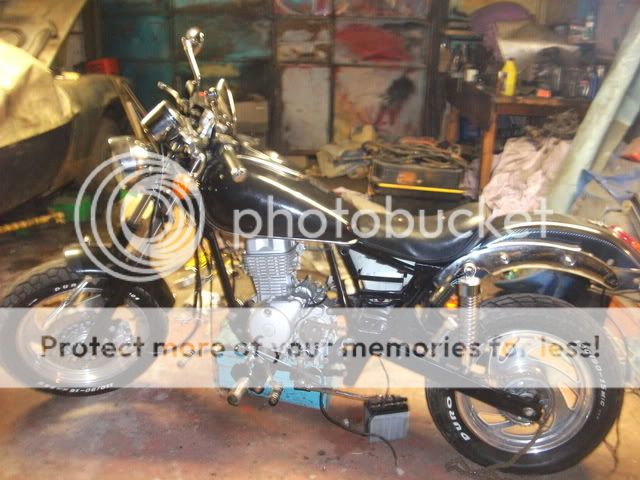

PostPosted: 20:34 - 20 Mar 2011    Post subject: Reply with quote
looks pretty cool, kind flat track crossed with a cruiser
upload your photos to
www.photobucket.com
and post them with the [img.] tags like this
https://i58.photobucket.com/albums/g257/hmmmnz/dscf1061.jpg
https://i58.photobucket.com/albums/g257/hmmmnz/dscf1062j.jpg
easy Very Happy
keep us posted

PostPosted: 00:53 - 21 Mar 2011    Post subject: Reply with quote
Chain looks a bit slack. Wink
I jest. This is great, moar please.
ruck bodgers
Joined: 31 Oct 2010
PostPosted: 01:41 - 21 Mar 2011    Post subject: Reply with quote
haha ye it was a few links short and i had cut off the bottom suspension brackets and welded them on further up the swing arm to lift the rear end to complete my comfortable riding posistion so the pivot point of the swing arm was obstructing the chain i had to make a cheeky little adjustable chain roller out of a piece of angle and a skateboard wheel to fix onto it so the chain ran clean over it worked good Thumbs Up im stoked people have shown some possative feedback i thought everyone would say its a shitty banga so im well chuffed with that man . ill upload some more in the next few days

hmmmnz
PostPosted: 11:31 - 21 Mar 2011    Post subject: Reply with quote
why didnt you go for a larger sprocket at the back, 8 teeth extra and then 2 up at the front to even it back out,
what are you going to do about the foot controls? keep them forward,
or move them to a more respectable place back under the seat,

ruck bodgers
Joined: 31 Oct 2010
PostPosted: 15:59 - 21 Mar 2011    Post subject: Reply with quote
the foot controls will stay forward for now i need to get it passed its mot in a couple of weeks and i have no money to buy welding rods or anything like that let alone sprockets but i did find a skateboard in a skip im even out of grinding discs | my favourite thing . but yea i would really like to move them back also add a hub to the top of the rear fender and make a nice brake light that one on there is off a jcb digger that i acquired i found some sheet metal recently so im going to make some sort of side panels and battery box wont be able to paint them yet tho . i w as also going to get a mono shock for the rear i found one for 25$ complete but it was 24$ to much id also like to have used a race tank i had a problem with the header bolt last week it threaded so i put in a bolt from underneath drilled out the centre of the original bolt feeded it through it and put the proper bolt back in and rubber that way. i was a bit worried about the engine when i first got it to be honest knowing that cbf,s and cbr 125s are popular learner bikes and 16 year olds have them who might be a bit more likely to do something as crazy as put two stroke in the tank and the oil tank on a 4 stroke engine because it stunk like 2 stroke i drained it out for 24 hours shaking it about now n then i even sucked on it lol to get any last bits out just incase . but its okay it runs nice i have cleaned it all out and made sure its all lined up and im having a lotta fun with this project man the last thing i need to do now is get my downpipe welded ive never tig welded before so im going to ask a friend to do it . will be coming from under the bike to the right hand side at a bit of an upward angle originally it was going to come up under the seat and the bike was going to be a sort of speedy bobber but the frame was to short for that solo seat bobber style
and i had another vision of what i wanted it to be where the whole thing was polished and clear powder coated with gold trim calipers nuts n the likes gold clip ons and nice spoke wheels but all that costs money i dont have and would of been overkill i was more concerned with how it rides than how it looks . so i would really like to move those foot controls back Thumbs Up i might be able to still im going to go and stand and stare at it for a long time just now and have a good think about it
i do not think therefore i am . give me a hammer

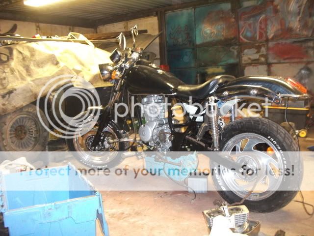

ruck bodgers
Joined: 31 Oct 2010
PostPosted: 04:46 - 20 Aug 2012    Post subject: Reply with quote
wow two years ago and i still sound like a nob .
well the project i completed very shortly after that last post.
and used it daily .
since then it has been remade 4 times
i did not take pictures of everyhting and lots was changed
cut off stuck on ,made ,machined ,frame reinforced ,smoothed out
heights varied electrics changed drum to disc foot controls moved all sorts of stuff ect ect .
i did say 2 years ago i would finnish this post so i intend to
the 300 budget was added to and ended up i calculated at being more at 530-550.(did not see that coming did you ) Laughing
a lot of that was spent on buying paint and little bits like air filters ,inline filters fuel lines and such pretty much everything that was made out of metal i needed i made myself or did what i could so as not to part with my hard earned . using things i found or scavanged for out of bins skips just anywhere
its just a little donkey appose to a work horse as you know . and it was a small victory for me having finished it and having no money and no help on the things i did not understand . i still have no money or understand anything . but it was a lot of fun
here are a few pictures of it through its various stages and changes during its being made ,re-made,re-made again
just to recap to start with it was a combination of a cbf 125 engine and electrics and a jinlun cruiser chinese salvage . and any bits of scrap i could find . in present day its comprised of about 6 bikes
ENGINE BRACKETS/CRADLE LINKAGES these were off the chinese bike and only needed to be modded to make fit
[IMG=https://img513.imageshack.us/img513/5969/dscf0884f.jpg][/IMG]
the rear two brackets i had to make from some galv steel i found by a railway track. was straight forward no tape measures involved
angle grinder ,drill ,bit of sanding .done
FRAME. ..was a piece of shit steel tube banged together . weld splatter all over . but i do have to say the welds were decent and the joints were okay . other than being neglect of any pride
it took about a week just to clean up the rolling chasis after de rusting stripping all paint and the rest of it
it was a real state .

i later changed this rear fender again . on the 3rd build i think after playing with seat heights and suspension again
after not to much thought i grabbed a couple of cans of hammerite smooth to paint my frame in .BAD IDEA . not nice to use at all it is much better suited to gate posts and things like that . i had a real struggle with the stuff but managed to get it looking good in the end . on the second build and afterwards i was using a paint gun and proper set up . the hammerite smooth i have yet to try cut with thinners and sprayed with a gun . but the spray cans of it are a nightmare
well with that i was ready to fit the engine
https://img209.imageshack.us/img209/2982/dscf0955b.th.jpg
https://img194.imageshack.us/img194/1281/dscf0956o.th.jpg
https://img713.imageshack.us/img713/8613/dscf0958w.th.jpg
https://img191.imageshack.us/img191/2504/dscf0957l.th.jpg

after 1200 miles of the origonal build i remade it again completely and . heres the engine starting to be stripped . i stripped it as far as i could without splitting it. and triple checked everything .prepped it for painting . polished the cases and rocker cover .and put it back together after making some new gaskets
https://img201.imageshack.us/img201/5880/dscf2029m.th.jpg
https://img534.imageshack.us/img534/7118/dscf2028gm.th.jpg
https://img33.imageshack.us/img33/6295/dscf2031sp.th.jpg
i will have to skipp a lott of the work and just start showing u it after the second time i made the bike . so here it is after the second design .
https://img820.imageshack.us/img820/1762/dscf2056l.th.jpg
https://img201.imageshack.us/img201/4796/dscf2057on.th.jpg
lots changed after this as well . here you can see the foot controls have moved back amongst other things .
