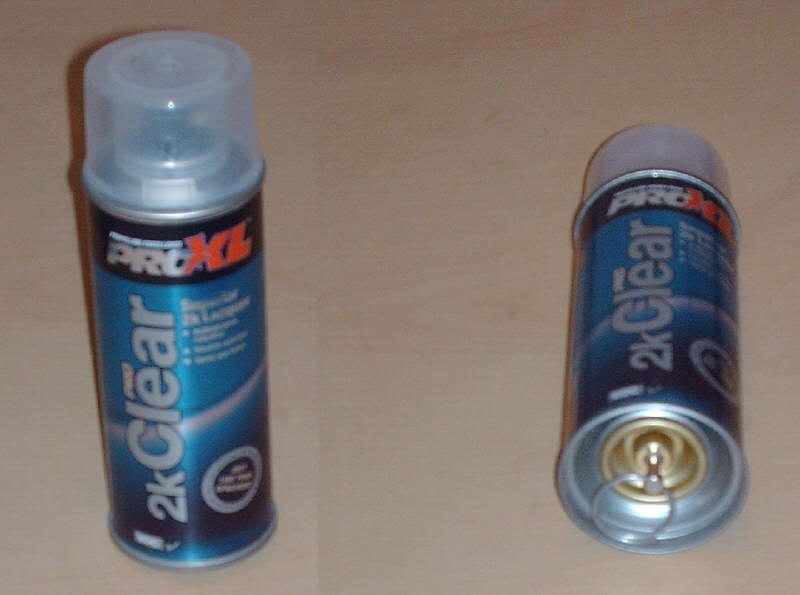

Pissed off with non-petrol-proof when I did the DT, I had a word with my localk freindly paint shop.
2-Pack in a Rattle Can!
Went over yellow (not metalic) celulose great. And IS petrol proof!
Expensive though, (£15 for 150ml can!)
And you get ONE shot... soon as whats on tank is hard, so is whats left in tin!
You have to be careful laying it on, too, becouse without solvent, what goes on stays on, and it rund easily if you put it on too heavy.
