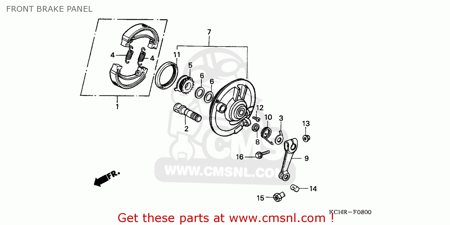

I guess you've probably not done the adjuster nut up far enough.
https://images.cmsnl.com/img/partslists/honda-cg125-1995-england-front-brake-panel_bigecchrb1f__0800_288b.gif
#15 on here.

Adjuster nut thread has gone, where can I pick one up? Even so, I think it's right at the end of the screw so wouldn't have much of an effect?
