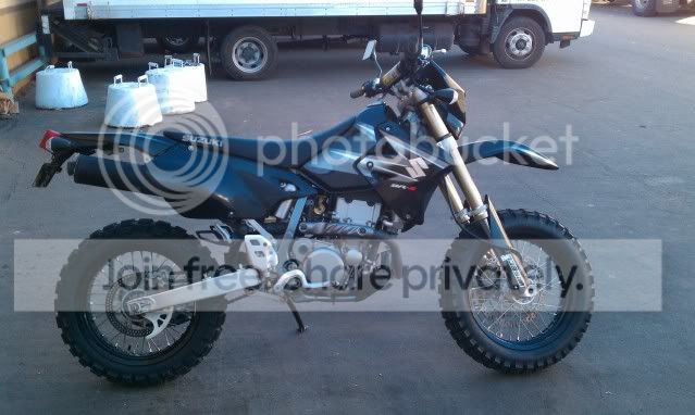

You can get Conti TKC80's in 120/70-17 and 150/70-17.
I sold and fitted a pair the other week. Very strange looking in that size, and as already said a 120 section front would be a pain off road.
https://i174.photobucket.com/albums/w120/f-250ford/IMAG0074.jpg
(Picture pulled from Google)
