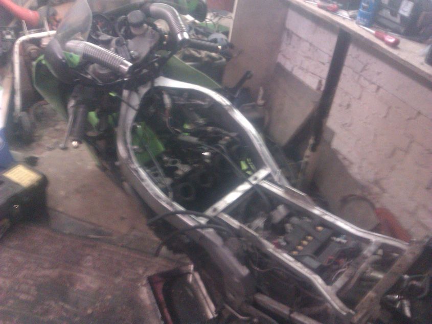

I don't have many photos of the condition the bike was in when I got it, and this is probably the best one:
https://img.photobucket.com/albums/v320/andy36586/ZXr2_zpsaead5a32.jpg
After a few hours work it was all back together (just I'd messed up the timing and couldn't get it to start):
https://img.photobucket.com/albums/v320/andy36586/Rebuilt1_zpsd4d7fbfd.jpg

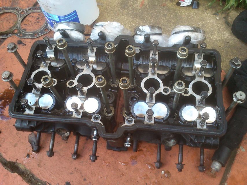

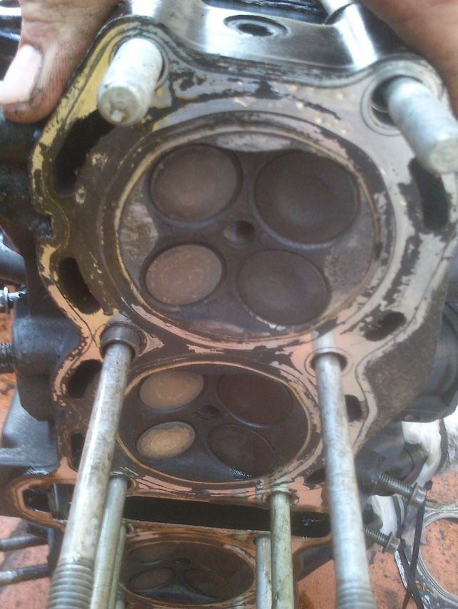

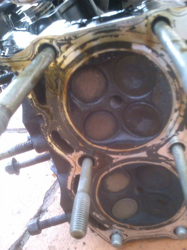

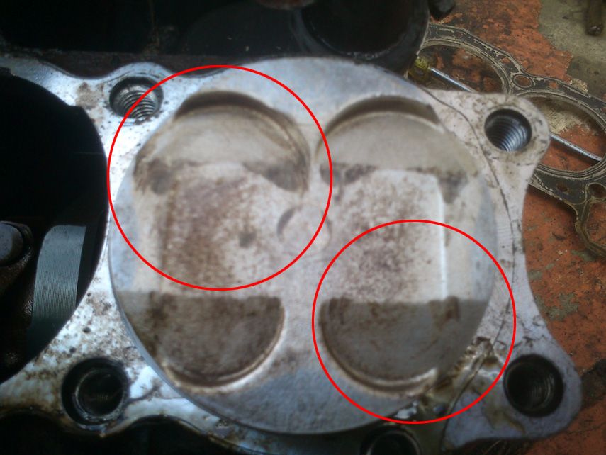

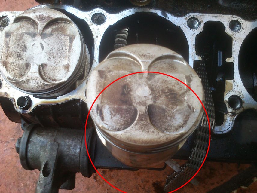

For people that don't want to watch a shakey video, I took the head off the engine and found a couple of pistons have been slapped by the valves and have dented slightly (not sure if I need to replace them), piston 1-3 have no vertical movement, but 4 does and makes quite a lot of noise doing so. So I could have stripped the engine from the bottom and saved myself the cost of gaskets possibly.

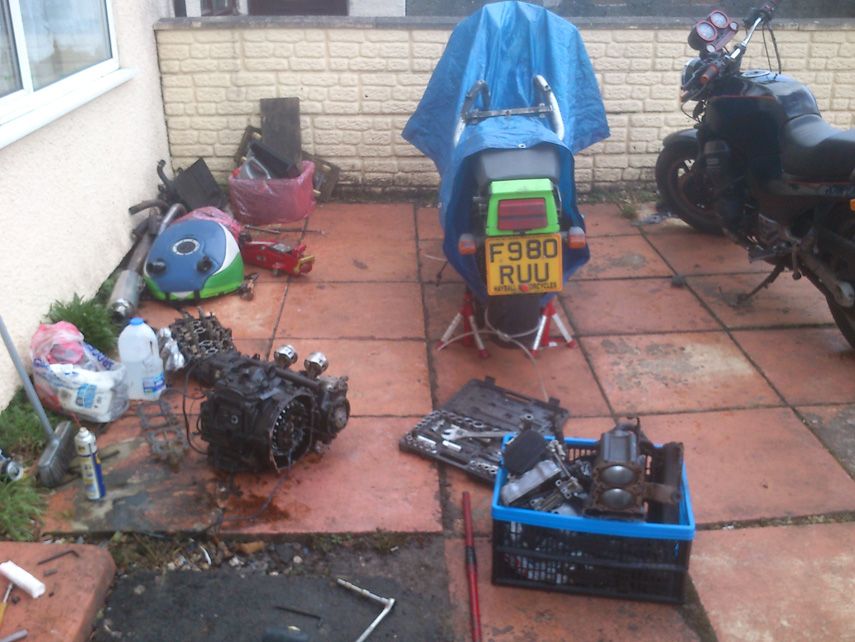

Also it was recommended that I use tubs to keep the parts of the engine seperate, that didn't quite work as I wanted it to, the little tubs are empty (I think there is 1 bolt between 8 tubs), and the rest of the engine is either sitting on the drive in bags or in a box in my bedroom, I'll post a picture later.

I would replace the engine or find a donor with a fucked gearbox and donor the box from the fucked one etc. But thats my inclination as I would imagine the valves being bent, poor running due to that and the metal in the engine damaging a few other parts. The fact there is metal in the oil is a worrying sign indeed.

The silly thing is the engine seems fine in places, I removed the clutch plates and everything goes into gear smooth and all turns without a sound, since the sump is off I can see the internals of the gearbox and nothing appears to be damaged/out of place. If the weather is good enough tomorrow I'll get the rest of it stripped down and see what I find, I've taken the easy parts off so if I f**k it up now I won't really have lost anything because as far as I'm concerned the engine was scrap anyway and this is just a learning experience.... if I can sort it then fair enough, if not I'm still hunting for another engine... but I'll hold off for a bit with that for now.

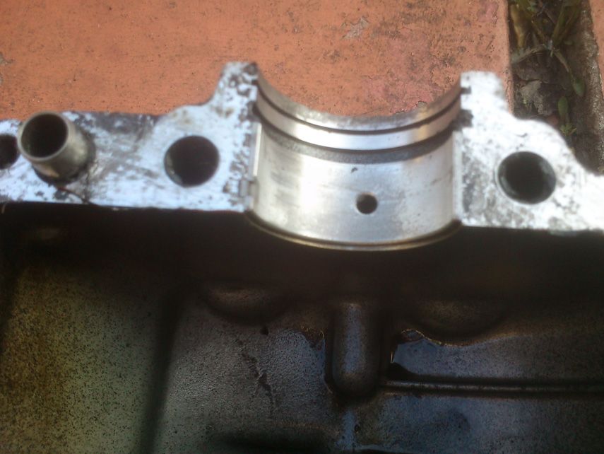

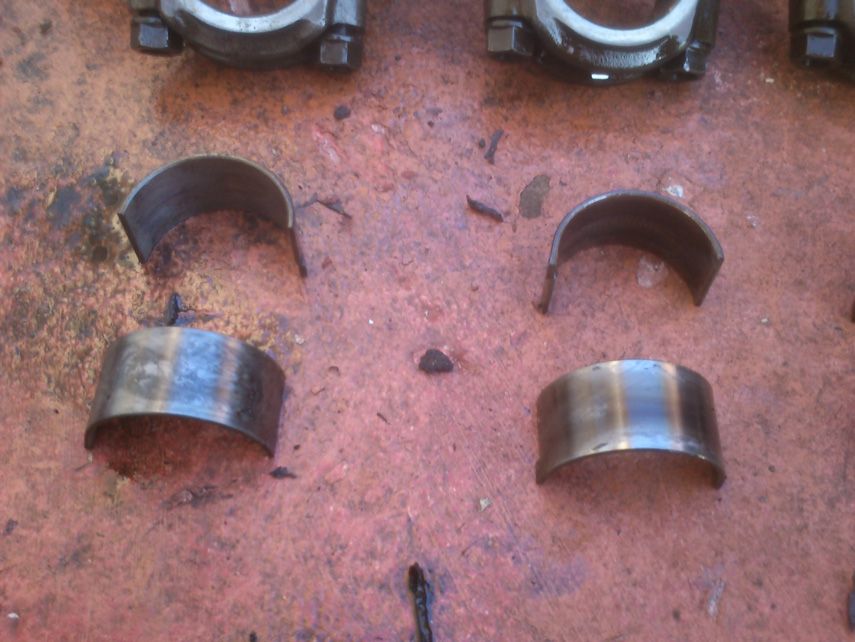

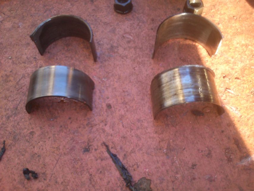

First off, the knocking was caused by one of the big end shells being as thick as tinfoil (and that's pushing it):
https://img.photobucket.com/albums/v320/andy36586/Big-ends-2_zpsf371abe1.jpg from cylinder 2 and 1 (in that order) for comparison.
And 3 & 4
https://img.photobucket.com/albums/v320/andy36586/Big-ends-1_zpsbdadd15d.jpg

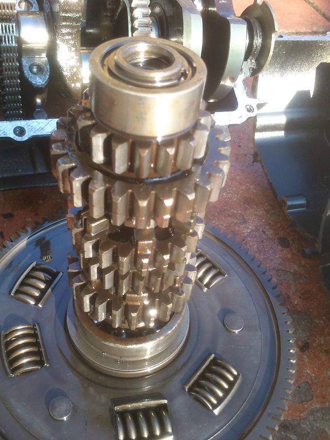

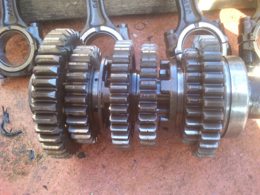

The gearbox looking almost perfect (I think):
https://img.photobucket.com/albums/v320/andy36586/gearbox1_zps4d4e944a.jpg
https://img.photobucket.com/albums/v320/andy36586/gearbox-2_zps5069f158.jpg

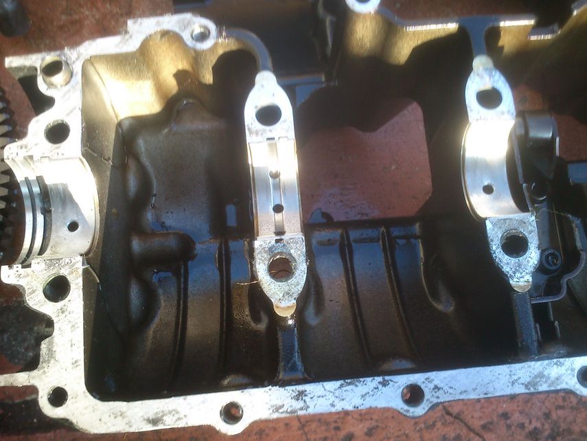

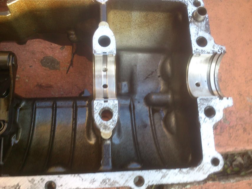

Something had been scraping in the crank case, but I think the engine has been apart in the past to repair it as I couldn't find anything close enough to cause the damage:
https://img.photobucket.com/albums/v320/andy36586/Crankcase4_zps69a79f33.jpg
https://img.photobucket.com/albums/v320/andy36586/Crankcase1_zps6b7c096c.jpg
https://img.photobucket.com/albums/v320/andy36586/Crankcase2_zpsfb30ecc9.jpg
https://img.photobucket.com/albums/v320/andy36586/Crankcase3_zps890b7a6e.jpg

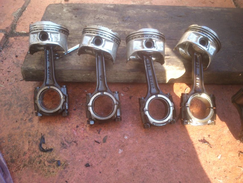

The pistons just as they had been removed:
https://img.photobucket.com/albums/v320/andy36586/Pistons-complete_zpsbf39dc41.jpg
Before they had been removed showing the dents from the valves on the crowns
https://img.photobucket.com/albums/v320/andy36586/Piston-4_zps2501ed69.jpg
https://img.photobucket.com/albums/v320/andy36586/Piston-2_zpse09609cb.jpg

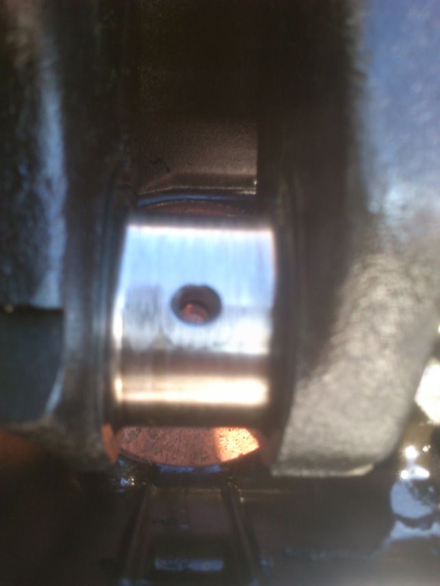

And then there is the damage to the crankshaft:
https://img.photobucket.com/albums/v320/andy36586/Worn-Crankshaft_zpsa52a1105.jpg

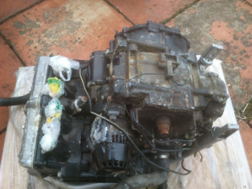

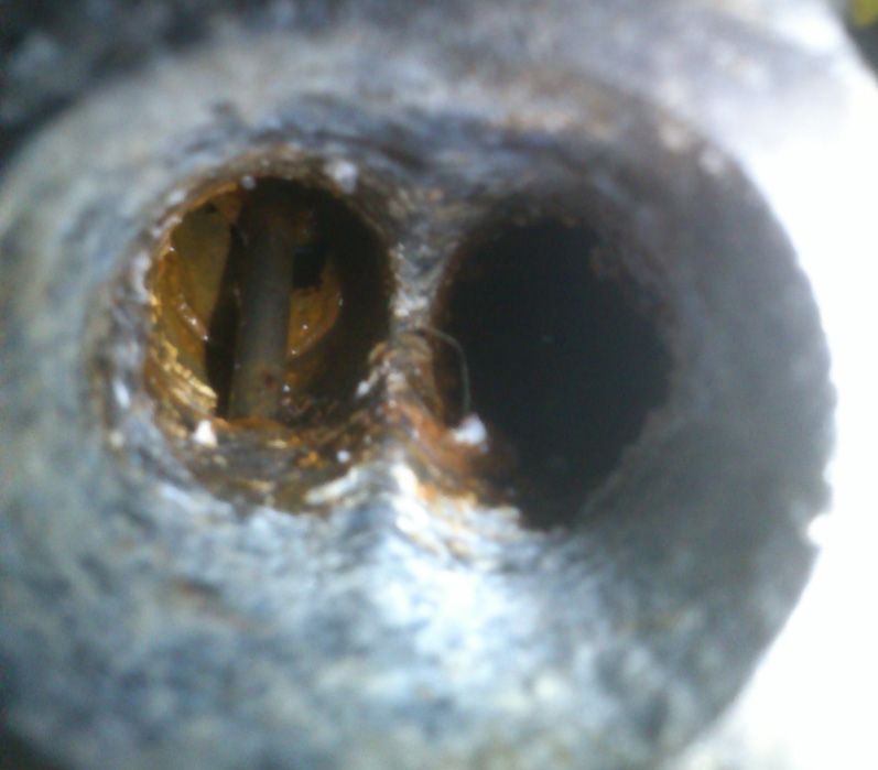

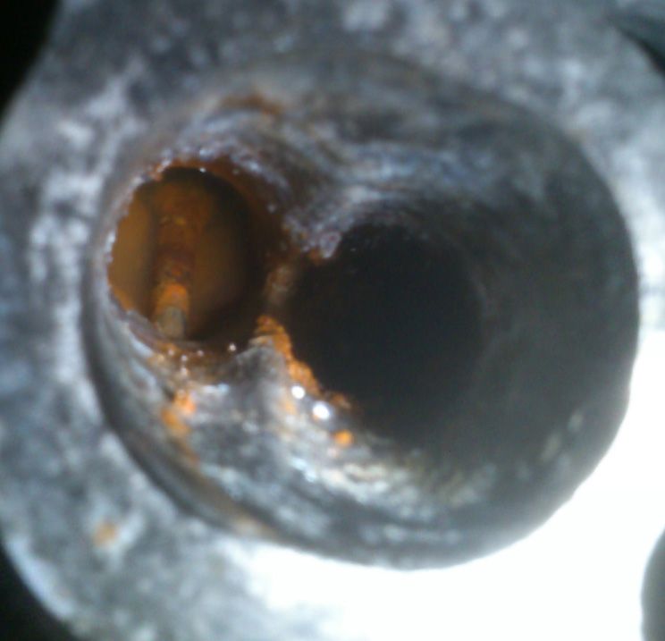

So I figured to save a bit of time I would just buy a replacement engine... which seems must have been stored under the sea or something:
https://img.photobucket.com/albums/v320/andy36586/nEngine01_zpsb5d18a93.jpg

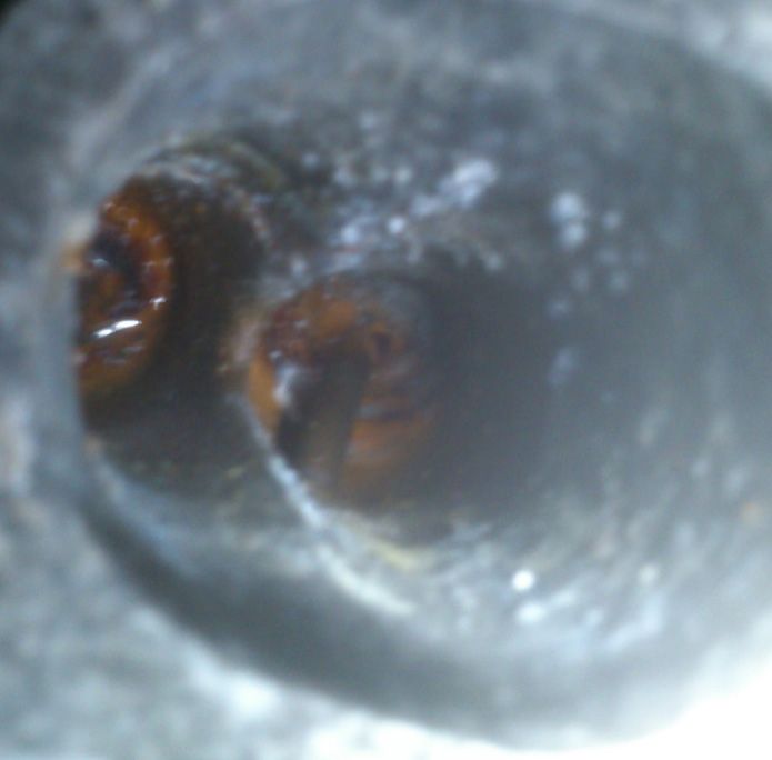

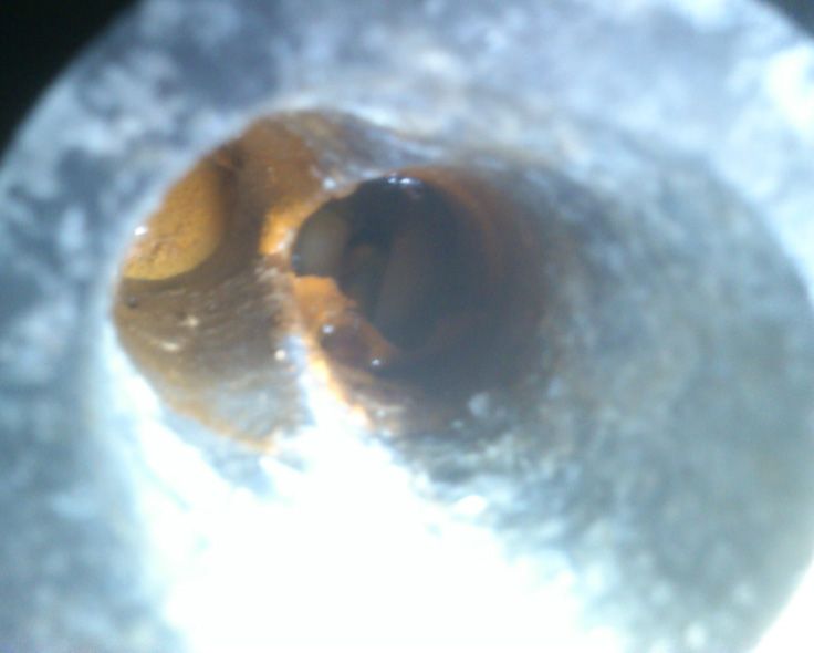

Notice the carrier bags stuffed into the intake ports... that resulted in this:
https://img.photobucket.com/albums/v320/andy36586/inlet4_zps00528a82.jpg
https://img.photobucket.com/albums/v320/andy36586/inlet1_zps33de5eff.jpg
https://img.photobucket.com/albums/v320/andy36586/inlet2_zps8c4e8292.jpg
https://img.photobucket.com/albums/v320/andy36586/inlet3_zps8162e9ef.jpg
