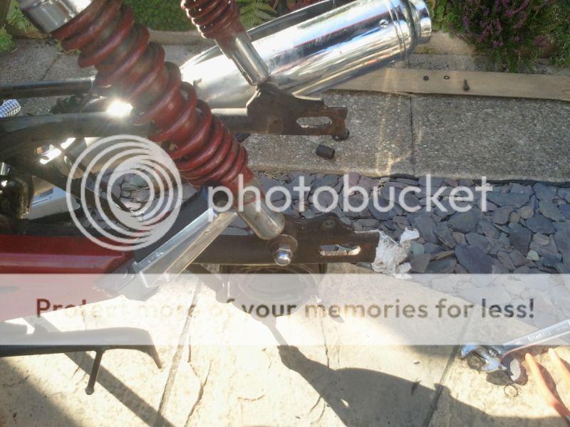

1) First removed the chain guard
https://i77.photobucket.com/albums/j69/willyrobbie/2012-09-07151953.jpg

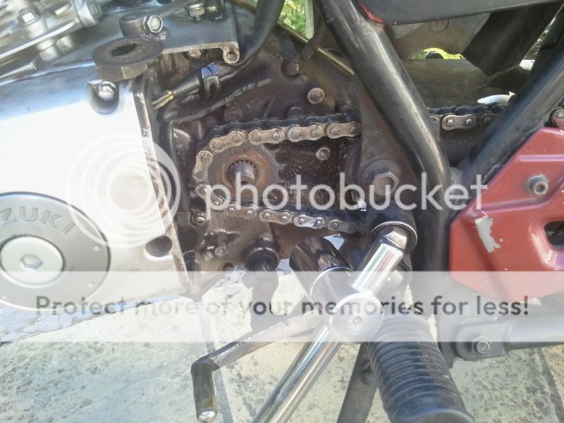

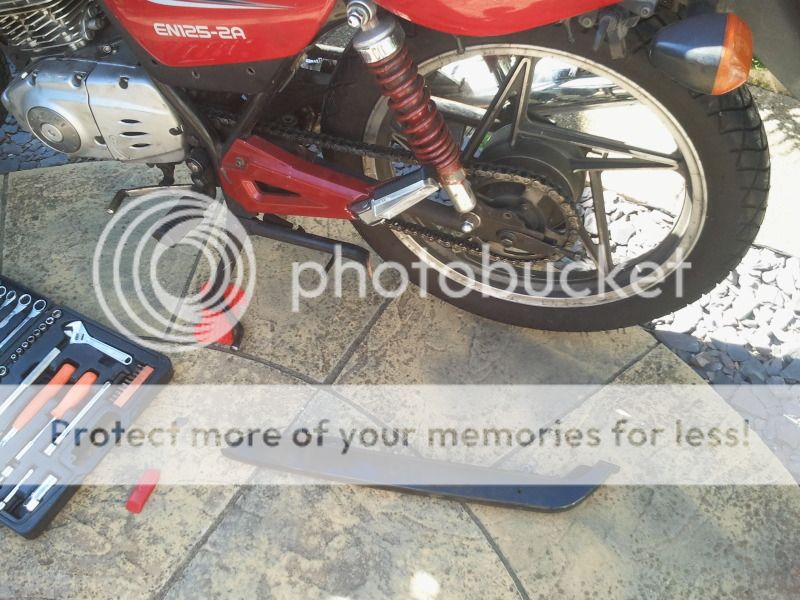

2) Removed sprocket cover
https://i77.photobucket.com/albums/j69/willyrobbie/2012-09-07152454.jpg

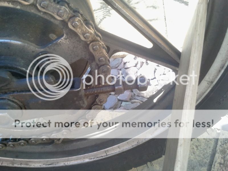

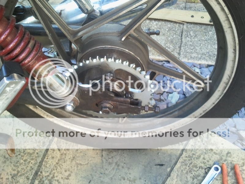

4) Slackened the chain adjusters
https://i77.photobucket.com/albums/j69/willyrobbie/2012-09-07153149.jpg

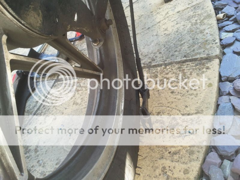

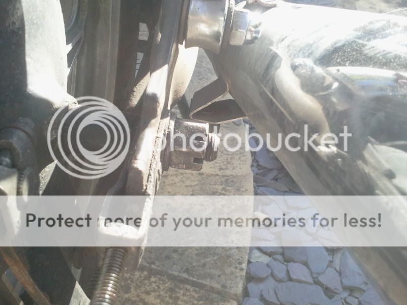

5) Removed split pin off wheel nut (to replaced another day)
https://i77.photobucket.com/albums/j69/willyrobbie/2012-09-07153615.jpg
6) Removed wheel nut
https://i77.photobucket.com/albums/j69/willyrobbie/2012-09-07153808.jpg

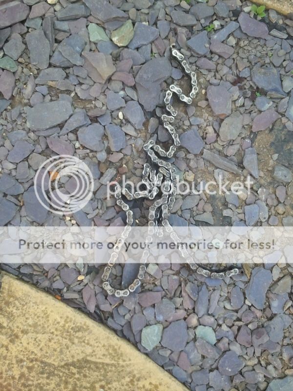

7) Removed split pin from chain and removed chain
https://i77.photobucket.com/albums/j69/willyrobbie/2012-09-07155554.jpg

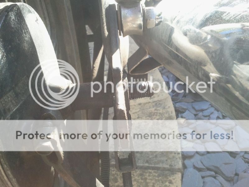

8) Disconnected brake rod from the drum
https://i77.photobucket.com/albums/j69/willyrobbie/2012-09-07155852.jpg

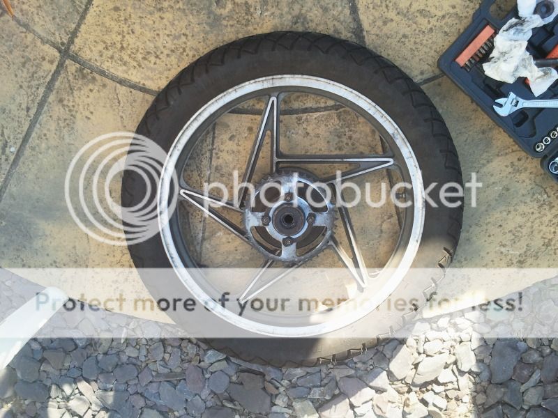

9) Remove wheel rod and remove wheel
https://i77.photobucket.com/albums/j69/willyrobbie/2012-09-07163012.jpg
https://i77.photobucket.com/albums/j69/willyrobbie/2012-09-07163017.jpg

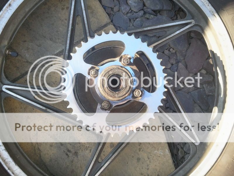

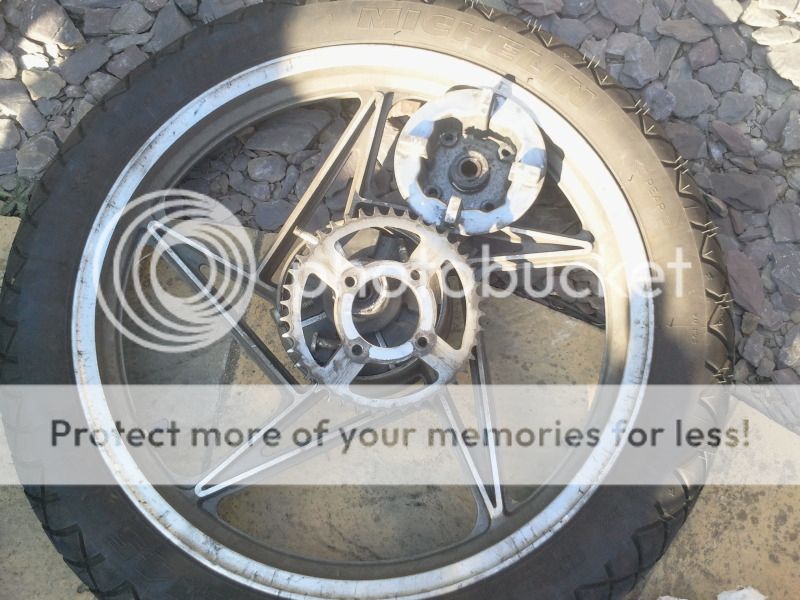

10) Removed old sprocket
https://i77.photobucket.com/albums/j69/willyrobbie/2012-09-07164735.jpg
11) Install new sprocket (put the teeth stamp facing towards the drum, hope that isn't a problem!)
https://i77.photobucket.com/albums/j69/willyrobbie/2012-09-07165712.jpg
12) Replaced wheel
https://i77.photobucket.com/albums/j69/willyrobbie/2012-09-07171445.jpg

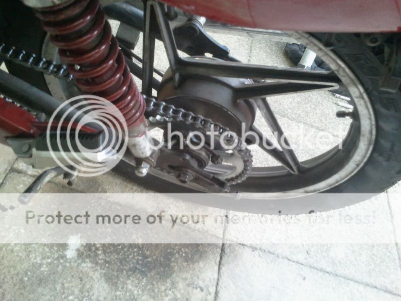

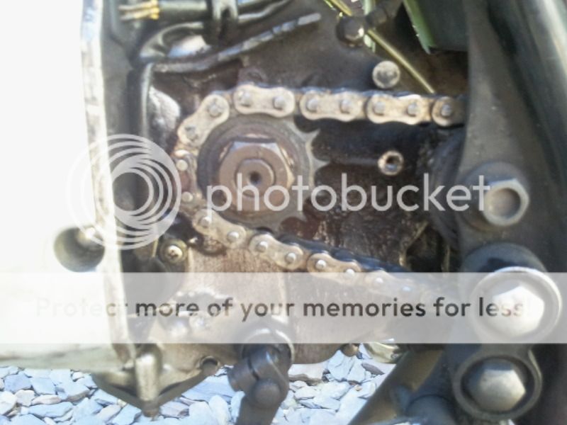

13) Installed new chain and front sprocket, then lubed
https://i77.photobucket.com/albums/j69/willyrobbie/2012-09-07184335.jpg

Don't forget to add a new split pin. Wink

Incidentally, even though it's an MOT failure to not have a split pin, has anyone ever seen one of those nuts work loose? I never have.
For the sake of a few pence, it's daft not too. Smile

The only thing that worried me was putting the rear sprocket the wrong way round, deffo not a big deal? Safe to leave it?

OK I will check that tomorrow. I did spin the wheel and it looked OK to me, plus I checked the sprocket to see if was straight either side after noticing my mistake and looked fine to me.

The previous owner stated that he had replaced the chain and sprockets before selling, but he must have replaced them with used sprockets or lied to me as they were worn. The chain kept jumping even after re-tensioning it.
