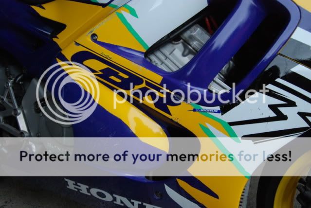

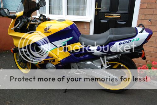

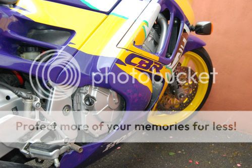

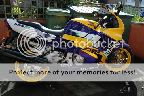

Thought id start a build thread for my cbr. Brought it in August last year as i really fancied a bike and this popped up cheap and i liked the look of it. Paid 750quid for the bike and another 50 to hold onto it for me for a month.
https://i45.photobucket.com/albums/f70/milez06/bike%20build/KGrHqJigFYMqRRBwBQN97KbSdw60_12.jpg
https://i45.photobucket.com/albums/f70/milez06/bike%20build/T2eC16RkE9s4Zlr1BQOLCsCO860_12.jpg
https://i45.photobucket.com/albums/f70/milez06/bike%20build/KGrHqNhkE1NBDYgBQN97Tc9ow60_12.jpg
https://i45.photobucket.com/albums/f70/milez06/bike%20build/KGrHqRlYFuZoOsBQN97Og9Gg60_12.jpg
https://i45.photobucket.com/albums/f70/milez06/bike%20build/KGrHqRrIE8cTtSiEBQOLC0GOs60_12.jpg
https://i45.photobucket.com/albums/f70/milez06/bike%20build/KGrHqJkwE5DrPboBQN97iT560_12.jpg
25,000 miles
Long MOT until June 2013
Good Tyres (Bridgestone BT020's)
New Battery this year
Recent new downpipes
Recent New Chain and Sprockets
Cam chain Tensioner replaced approx 500 miles ago
Includes Haynes Manual

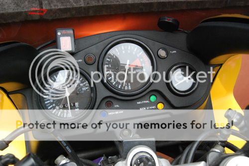

Includes Acumen gear change indicator

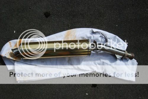

Includes additional Scorpion can (has scratches and bracket insulation is missing)
Fitted with Abletronics Absolute Protec Alarm and Immobiliser
Bad bits
Currently SORN
Only 1 key
Fairing and swingarm a bit tatty
Not much in the way of service history and although I serviced it in 2009 it really needs some TLC.
Its been sorn since march 10 apart from to get a mot.

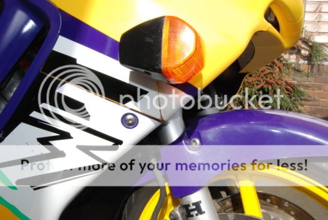

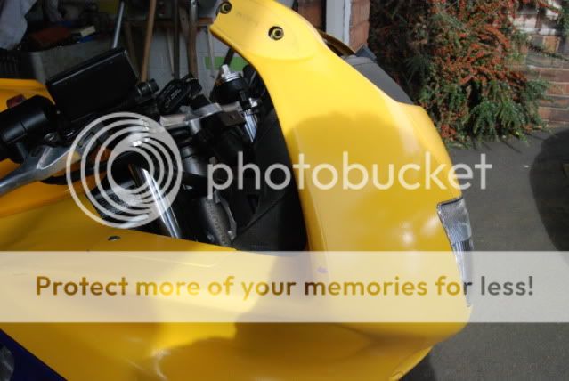

A couple of week before i picked it up the guy emailed me and said that he dropped it when he was putting it on the paddock stand Sad
It broke... The screen, one mirror, broken fairing where the mirror bolts on and some scratches on the fairings.
https://i45.photobucket.com/albums/f70/milez06/bike%20build/DSC_1967.jpg
https://i45.photobucket.com/albums/f70/milez06/bike%20build/DSC_19661.jpg
https://i45.photobucket.com/albums/f70/milez06/bike%20build/DSC_1965.jpg
https://i45.photobucket.com/albums/f70/milez06/bike%20build/DSC_1961.jpg
The guy knocked £150 of the price and i planned to change them parts anyway so i wasnt to bothered. Went to pick the bike up started first time so towed it back to my house

very nice, I do like the look of old Cbr6's. Looking forward to the rest of the thread Smile
1992 ZXR 400

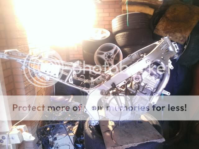

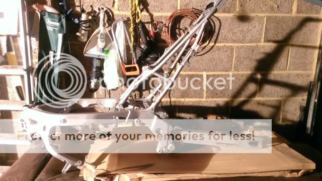

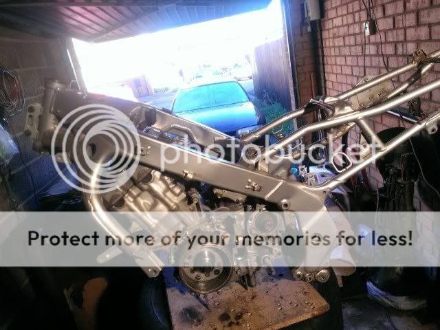

Here's some pics of the strip down, parts etc...
Messy garage full of tyres and crap
https://i45.photobucket.com/albums/f70/milez06/bike%20build/Picture016.jpg
I chucked the frame back on the engine just to remember where it bolted up and how it sat before i paint everything to afford scratches etc Carbs, wiring everything removed
https://i45.photobucket.com/albums/f70/milez06/bike%20build/Picture051.jpg
https://i45.photobucket.com/albums/f70/milez06/bike%20build/Picture050.jpg
https://i45.photobucket.com/albums/f70/milez06/bike%20build/Picture069.jpg

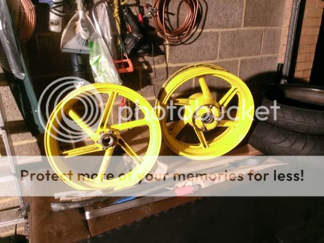

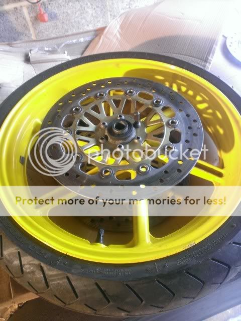

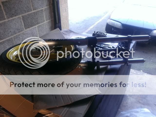

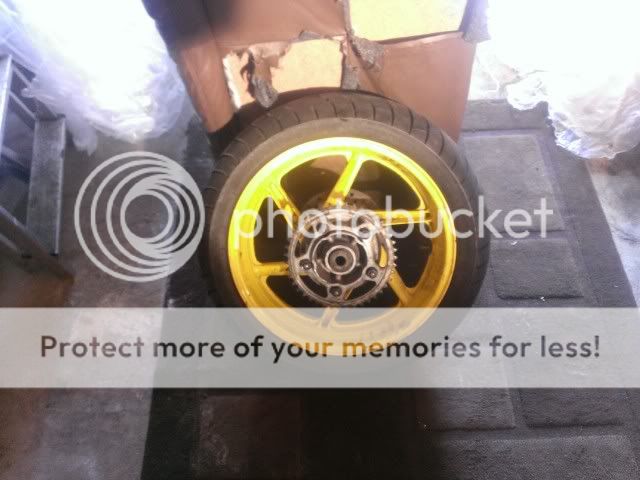

started to strip the wheels, front end down ready for shot blasting, powder coating etc.
Rear wheel
https://i45.photobucket.com/albums/f70/milez06/bike%20build/Picture019.jpg

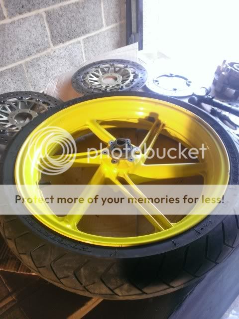

Complete front end
https://i45.photobucket.com/albums/f70/milez06/bike%20build/Picture024.jpg
Wheel off
https://i45.photobucket.com/albums/f70/milez06/bike%20build/Picture025.jpg

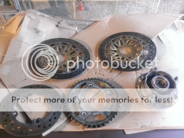

Rotors off. God bike wheels look crap without rotors etc
https://i45.photobucket.com/albums/f70/milez06/bike%20build/Picture026.jpg
Will be using front discs, rear discs maybe, new sprocket and new bearing and clean paint the centre bit thing
https://i45.photobucket.com/albums/f70/milez06/bike%20build/Picture027.jpg

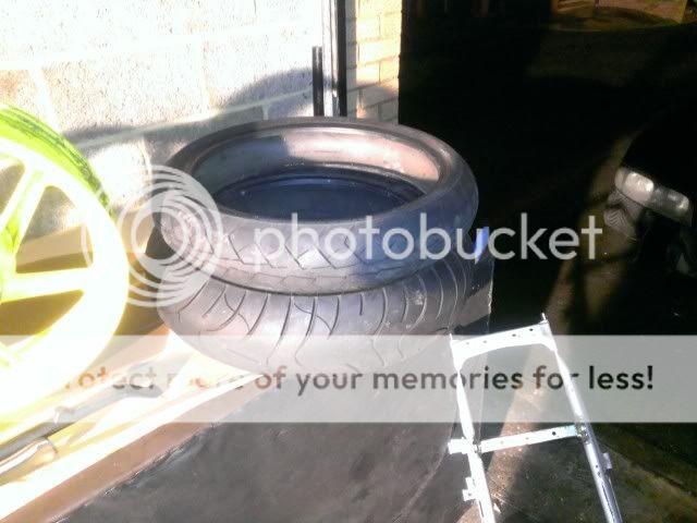

Whipped the tyres off. Homebead bead breaker that cost 5quid to make
https://i45.photobucket.com/albums/f70/milez06/bike%20build/Picture056.jpg
Couple of tyre levers and vola. Tyres off
https://i45.photobucket.com/albums/f70/milez06/bike%20build/Picture057.jpg
If anywant these. 120/60 160/60 bridgestone with half decent tread you welcome to come and get them Smile
https://i45.photobucket.com/albums/f70/milez06/bike%20build/Picture061.jpg

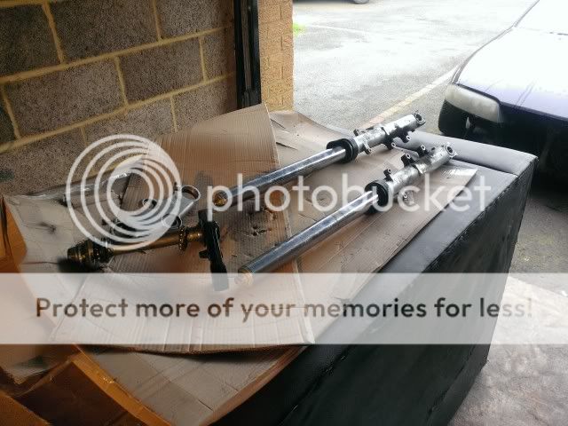

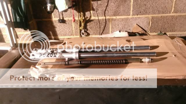

Started to take the forks apart so i could change the oil and get the fork tubes shot blasted, powder coated.
https://i45.photobucket.com/albums/f70/milez06/bike%20build/Picture029.jpg
Got the plastic bit off, dust cover and the spring clip inside it but couldnt get the fucking tubes out for the life of me. Need to get a blow torch out but couldnt be assed searching for it. So took the middle bit out to clean up and make sure it all looked ok
https://i45.photobucket.com/albums/f70/milez06/bike%20build/Picture072.jpg

If you ever get to the stage of changing the fork seals/bushes. You'll need to put the forks under compression and use a Impact gun on the bolts at the bottom to get the bolts to free from the cartridge.
Great job so far. Can't believe how quickly and easily you've got the rest of the bike apart.

Bottom bolt is out. That's how the inner cartridge, spring bit is out.
its common on these old cbr for the seals to seize. Abit of blow torch should see it good.
when i get on my laptop il show you the youtube vid i knicked the idea from.
lol im used to working on rusty nissans and mazdas so something that has only done 25k is a piece of piss to take apart lol

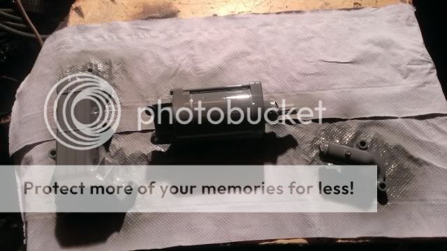

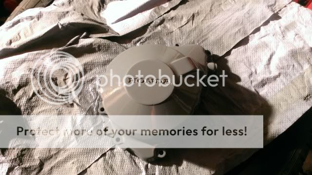

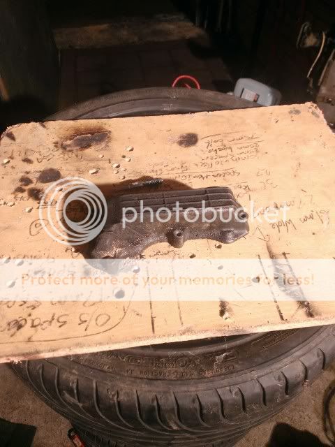

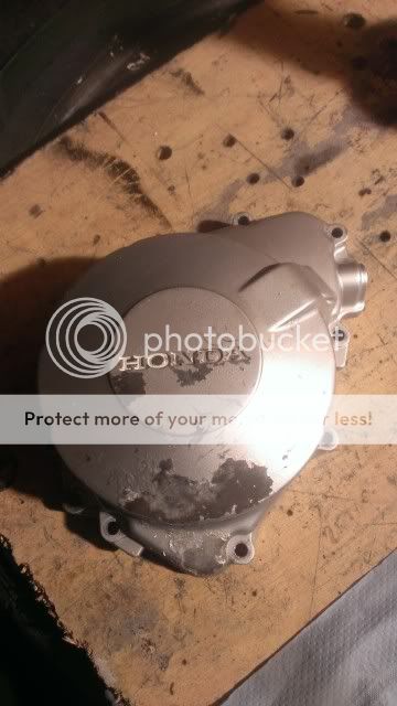

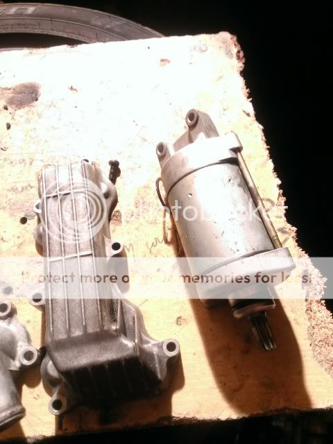

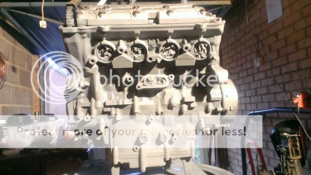

Got a bit more done. Took various bits off the engine to clean and paint and also started to clean up the engine. Lots of jizer and several different wire brush attachments on my drill. Its all come up pretty decent.
Before
https://i45.photobucket.com/albums/f70/milez06/bike%20build/Picture032.jpg
Cleaned up and degreased with brake cleaner
https://i45.photobucket.com/albums/f70/milez06/bike%20build/Picture064.jpg

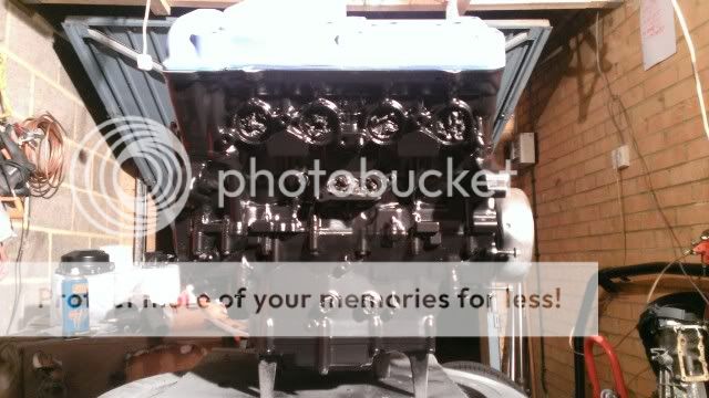

Bag of shit from work. Shameless plug. If anyone ever needs anyparts just drop me a pm, I will be able to give better prices than the website and free postage. Also starting to do motorbike batteries, filters etc so let me know Smile Thumbs Up
https://i45.photobucket.com/albums/f70/milez06/bike%20build/Picture079.jpg
Gave them 3 coats in all.
https://i45.photobucket.com/albums/f70/milez06/bike%20build/Picture086.jpg

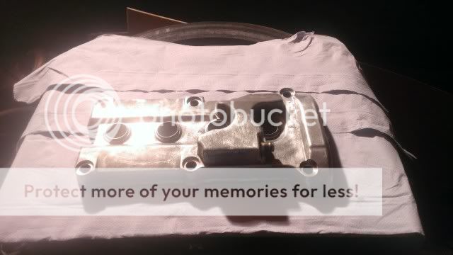

Started to do the rocker cover as it needed a good clean. Wire wheeled it all, came up pretty nice
https://i45.photobucket.com/albums/f70/milez06/bike%20build/Picture100.jpg
Again will do a few coats then the vht blue samr as the sump.
https://i45.photobucket.com/albums/f70/milez06/bike%20build/Picture105.jpg
Next up is the cover as its scratched and pealing
https://i45.photobucket.com/albums/f70/milez06/bike%20build/Picture108.jpg

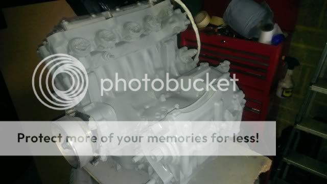

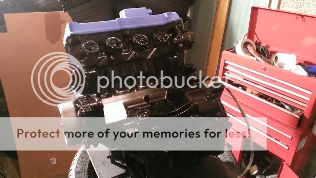

Cleaned up the engine with the wire wheel attachment and gave it a good clean with brake cleaner then started to spray it.
https://i45.photobucket.com/albums/f70/milez06/bike%20build/Picture120.jpg
https://i45.photobucket.com/albums/f70/milez06/bike%20build/Picture122.jpg

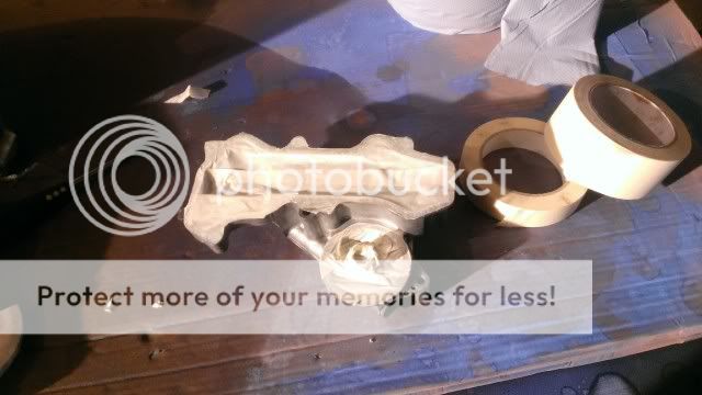

Cleaned and masked a few more bits ready for painting.
https://i45.photobucket.com/albums/f70/milez06/bike%20build/Picture127.jpg
https://i45.photobucket.com/albums/f70/milez06/bike%20build/Picture128.jpg
All done, Pretty happy how it all came out. Engine isnt perfect but will go over any bits i missed when i take the sump off to paint that in blue. (same as the rocker cover)
https://i45.photobucket.com/albums/f70/milez06/bike%20build/Picture129.jpg
https://i45.photobucket.com/albums/f70/milez06/bike%20build/Picture131.jpg
https://i45.photobucket.com/albums/f70/milez06/bike%20build/Picture133.jpg
The rocker cover looks really pale in the pics but its a nice bright blue in real life.

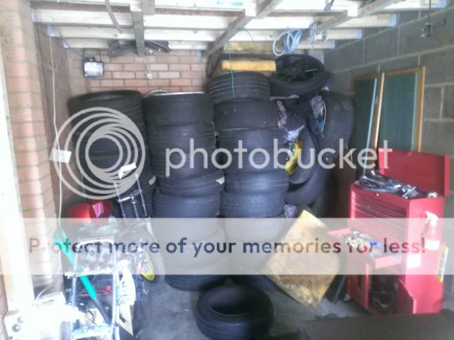

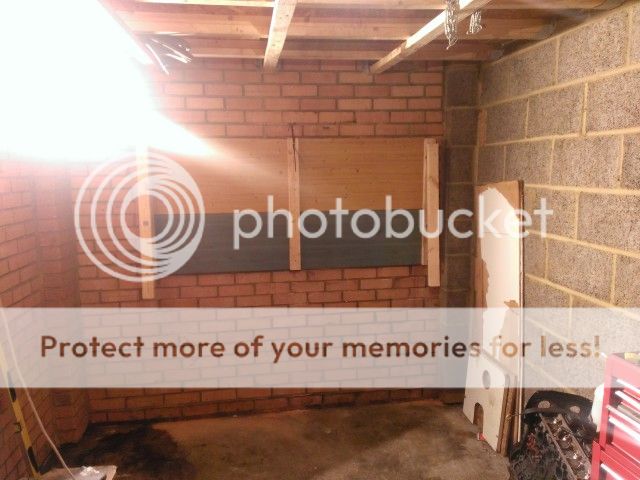

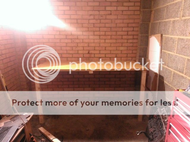

Got bored last sunday so went to the garage to have a tidy up. Removed all the tyres to down the side of my house as they wont be used for abit and made my self a workbench from a old wardrobe and some wood i had laying around.
Need to get some more wood to stick a few more legs on there so i can put heavier crap on there like my engine etc but its good for now. Its got 3 heavy duty hinges on it and 4 wardrobes doors bolted together.

i did get kind of worried the other day when i looked at the carbs and all the piping that i couldnt remember where shit went but ive got the owners manual and a haynes manual so hopefully ill figure it out lol.
Well this has been a piece of piss to take apart. Havent needed anything more than a 3/8 rachet and a few spanners. It crazy just to be able to pick up the engine, frame,swing arm and move it to where i want it. Theres obv alot less on the bike aswell.
The main advantage is though that parts are sooooo much cheaper. Esp compared to the skyline which has "skyline tax" for ever part. A company tried to charge me £65 for a ball joint i told them to fuck off lol.
Hopefully this will look good when its finished. Ideally looking for a 600rr rear end but havent found anything yet.
