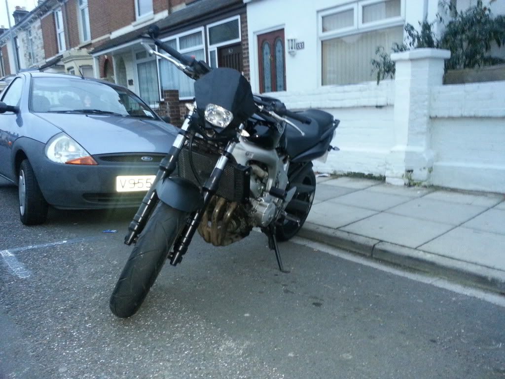

And the bike:
https://i448.photobucket.com/albums/qq205/deangte/20121025_175024.jpg
https://i448.photobucket.com/albums/qq205/deangte/20121025_175032.jpg
https://i448.photobucket.com/albums/qq205/deangte/20121025_175042.jpg
https://i448.photobucket.com/albums/qq205/deangte/20121025_175052.jpg
^^Apologies for the utterly crap picture quality, pics were taken at dusk on phone...^^

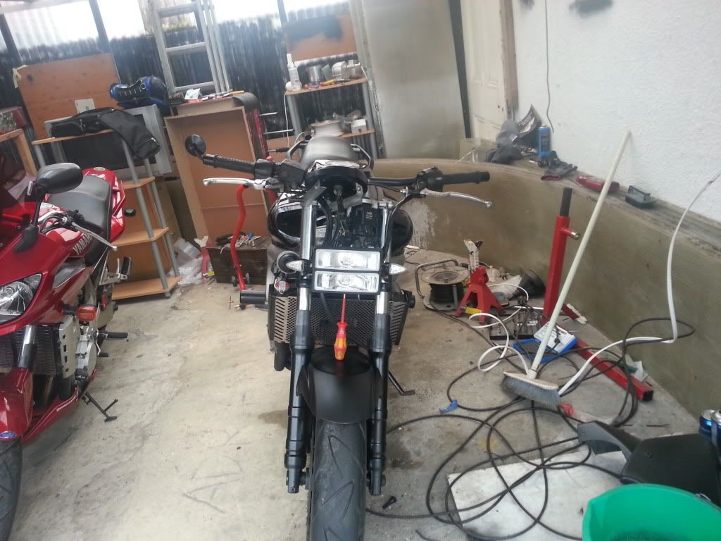

today turned out to be a bit of a mad day, but still got an hour on the bike. Wanted to fit a new light as i really wasnt feeling the enduro headlight that was on there, especially when my mate said it looked like a 125 from the front because of the stupid headlight! Mad
So, i grabbed a couple of brackets off a mate, and a couple spare headlights off another mate, and had a play...
First up twin car foglights, bolted together Dommy style:
https://i448.photobucket.com/albums/qq205/deangte/20121026_122011.jpg
Then a square double light, tyred it down low:
https://i448.photobucket.com/albums/qq205/deangte/20121026_122730.jpg
then up high:
https://i448.photobucket.com/albums/qq205/deangte/20121026_132025.jpg
In the end i went with the square light up high - tidied the wiring a touch to keep it out the way, and pretty much left it at that! I have still to make a more permanent/tidier mount for the clocks, and have started chopping up the old enduro light to use as a fly screen but that will need glass/filler work to get the desired shape so wont make an appearance for a wee while!

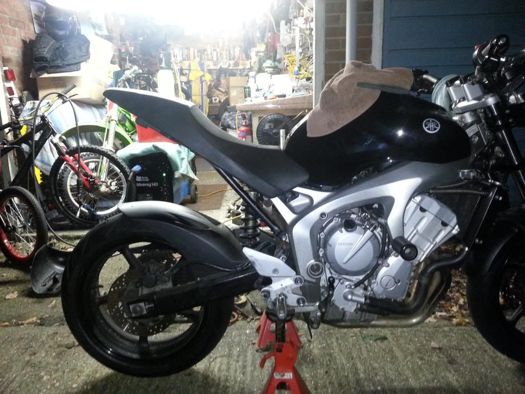

Bit of an update:
Set of pro taper motox bars went on as the drag bars just werent cutting it Sad will have something more individual on there at some point!
Currently finishing off the bikes new tail, Ducati Monster seat with semi hidden subframe:
https://i448.photobucket.com/albums/qq205/deangte/20121129_184354.jpg
https://i448.photobucket.com/albums/qq205/deangte/20121129_193233.jpg
This is me testing the new subframe....
https://i448.photobucket.com/albums/qq205/deangte/20121130_130036.jpg
https://i448.photobucket.com/albums/qq205/deangte/20121130_130045.jpg
New light and plate placement:
https://i448.photobucket.com/albums/qq205/deangte/20121130_161312.jpg
few diff angles:
https://i448.photobucket.com/albums/qq205/deangte/20121130_131247.jpg
https://i448.photobucket.com/albums/qq205/deangte/20121130_131240.jpg
https://i448.photobucket.com/albums/qq205/deangte/20121130_131228.jpg
